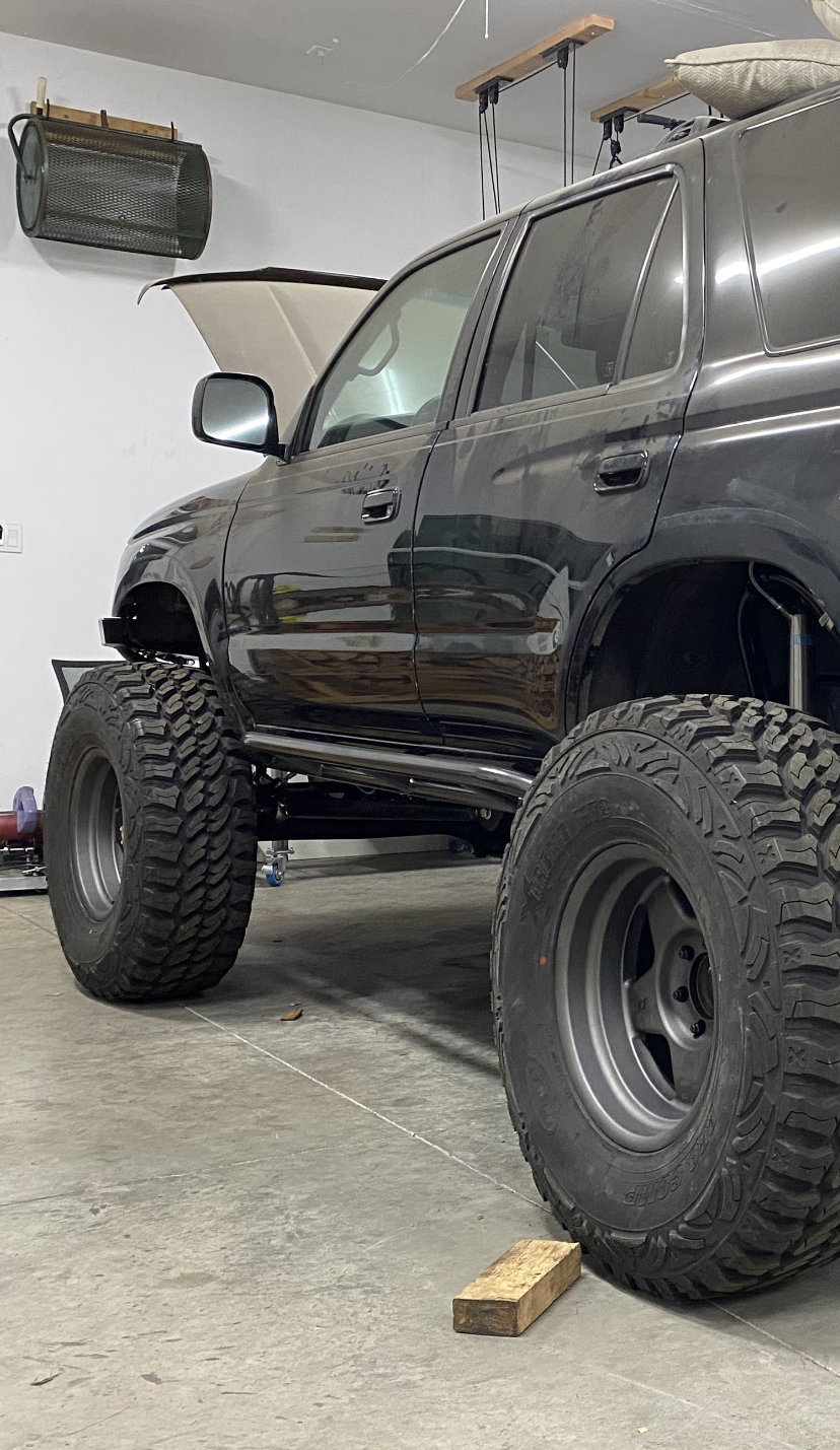

    Driveshafts get dropped off tomorrow. Sliders are on. Frame is sitting at 25.5” with 5” up-travel in the front.

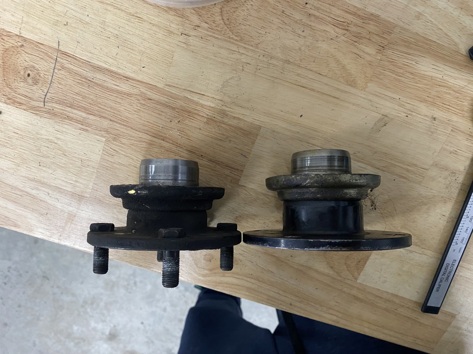

    Picked up driveshafts today, .095” tubed 5vz shafts. Learned the flange bolt pattern is narrower than the 3vz output flanges. Gonna try to swap out both flanges on the 3vz case with those from the 5vz case and then it’s test drive time.

    Out of curiosity, why not tube it with a thicker wall like .120 or .156?

    Unfortunately you may run into length issues. According to Tom woods, most of the Toyota flanges are different lengths. I ordered my front shaft with the wrong flange and they had to retube it because the correct flange was like an inch longer.

    Local shop would only go up to .095", better than 0.65" which i believe is factory but not as much as I would have liked. Ultimately these will be my street and light trail shafts, i'll make spares that aren't balanced for harder trails.

    Well shit, I hope that's not the case...appreciate the heads up. I'll pull them off tonight and measure.

    Turns out you were right, but I should be ok. 5vz case flanges are ~0.3” shorter than the 3vz flanges. There’s enough slip to easily compensate for the delta.

    That’s good! Mine was like an inch and a half different and had to send the driveshaft back from TN to Utah lol
