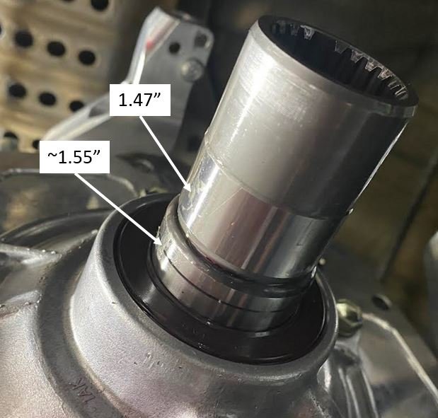

  9. Nov 19, 2023 at 12:54 PM
    #249
    smacaulay
    smacaulay [OP] Well-Known Member
    Nov 6, 2015
    #168830
    294
    Tcase is out, new seal was fucked up more than the one I pulled out. Either I suck as stabbing in a tcase (definitely possible) or there’s a larger diameter shoulder in the tcase input shaft that extends further than it should (measurements are damn close). Going to pick up some additional seals and test it out. 1.47" diameter matches the factory t-case input shaft, so as long as the seal is riding here there shouldn't be an issue.

  10. Nov 20, 2023 at 4:39 PM
    #250
    Crunchytaco69
    Crunchytaco69 Active Member
    Dec 21, 2022
    #413721
    29
    Cam
    Tacoma on tons
    Won Tons
    I had similar issue, my OG seal got messed up when I did the NWF Eco box, tried a lot of seals and the one I found to work was part number 15920 from Napa, brand was CR Seals (3.4 with Auto trans for reference)
    smacaulay[QUOTED][OP] likes this.
  11. Nov 20, 2023 at 5:21 PM
    #251
    smacaulay
    Nov 6, 2015
    #168830
    294
    Dude, thank you! I ordered a couple more factory seals and will pick up the same seal from Napa for comparison.
    Crunchytaco69 likes this.

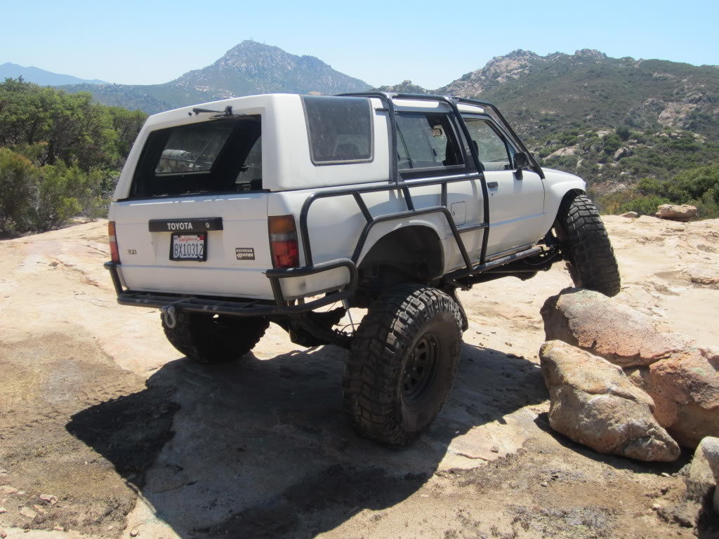

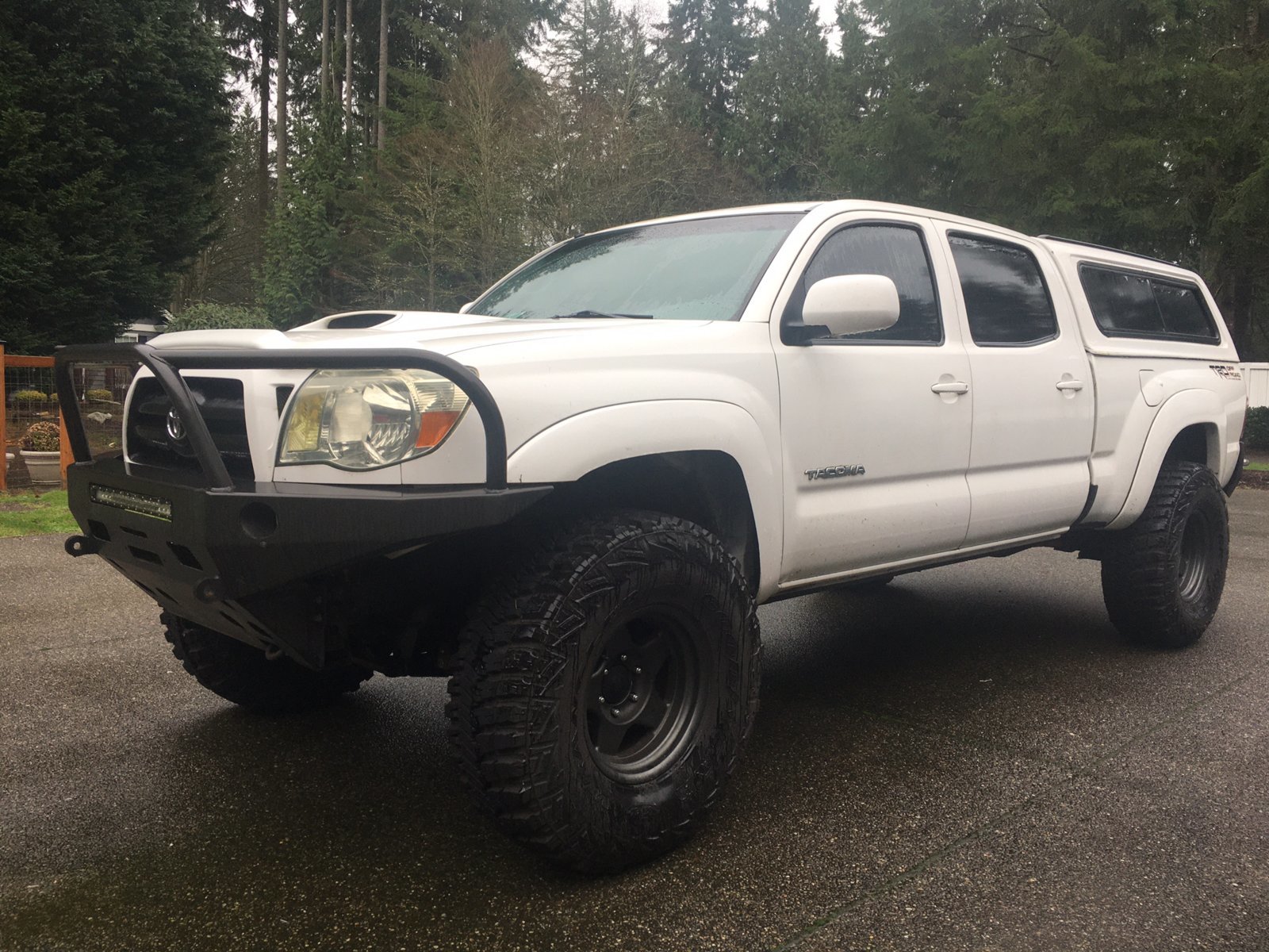

    100%. Been through this process a few times, it'll never be done...just a matter of how long I keep this one and how much I can get done. Adult legos are entertaining.
    Here's the last couple, neither ever finished.

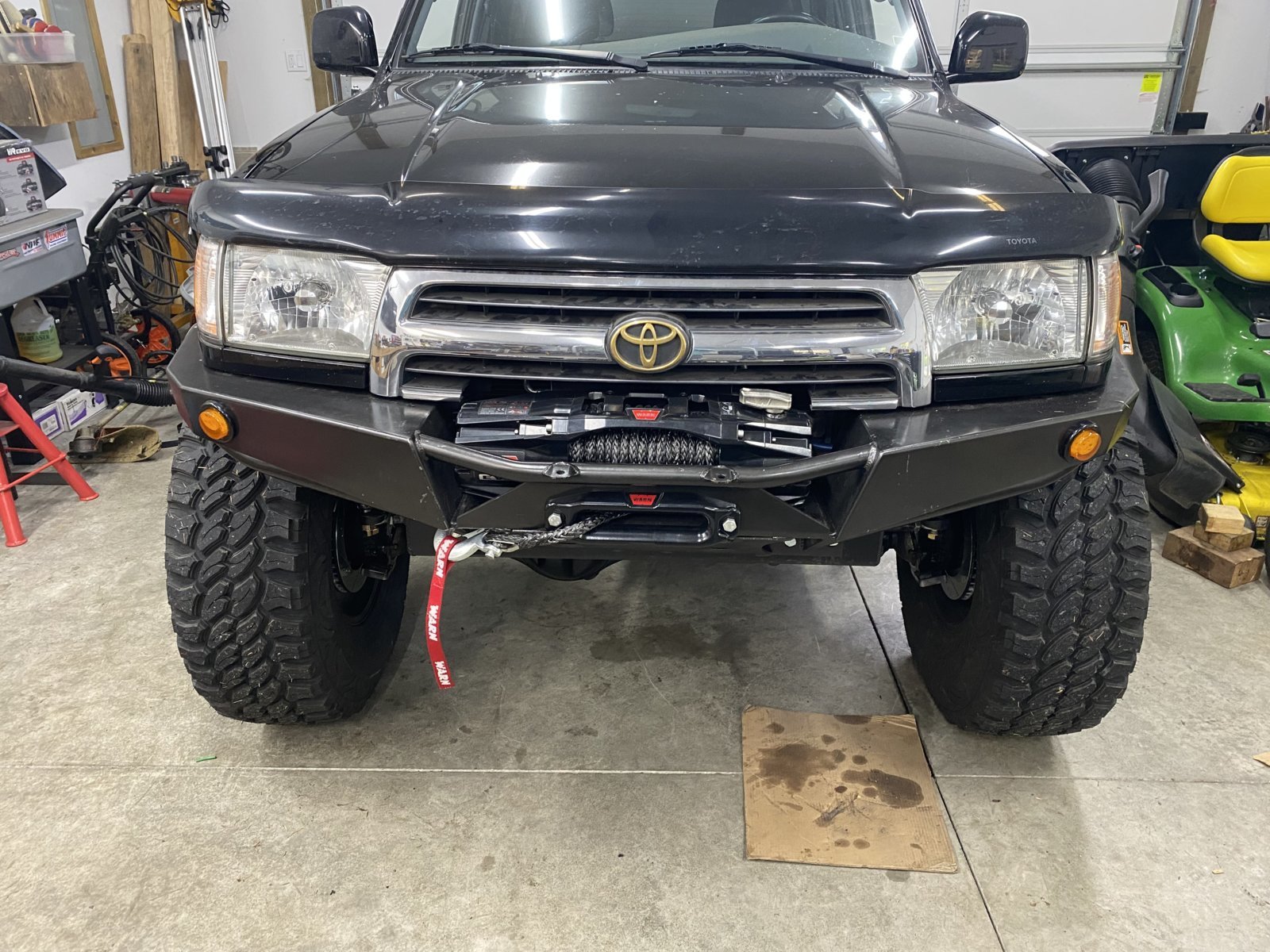

    Trans leak is fixed, winch wired up…stuffed the control box inside the bumper so the compressor will fit under the hood.

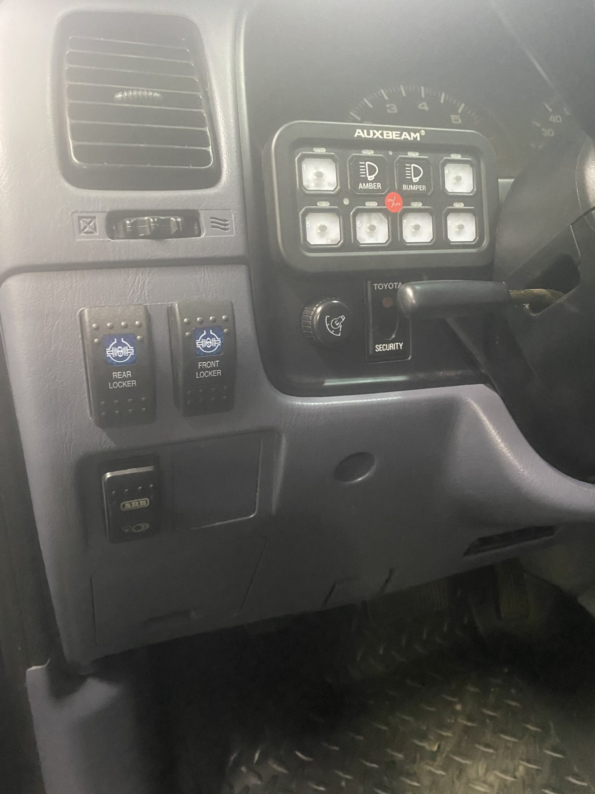

    294
    Lockers wired/plumbed, switch panel in. Trimming is next.

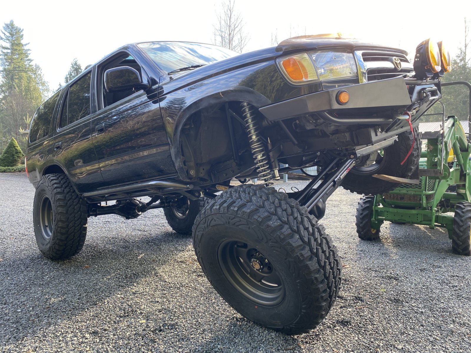

    Nov 6, 2015
    #168830
    294
    Have just a little bit of trimming to do to the front fenders and bumper. Probly 4” of flex left where the tractor tapped out.
