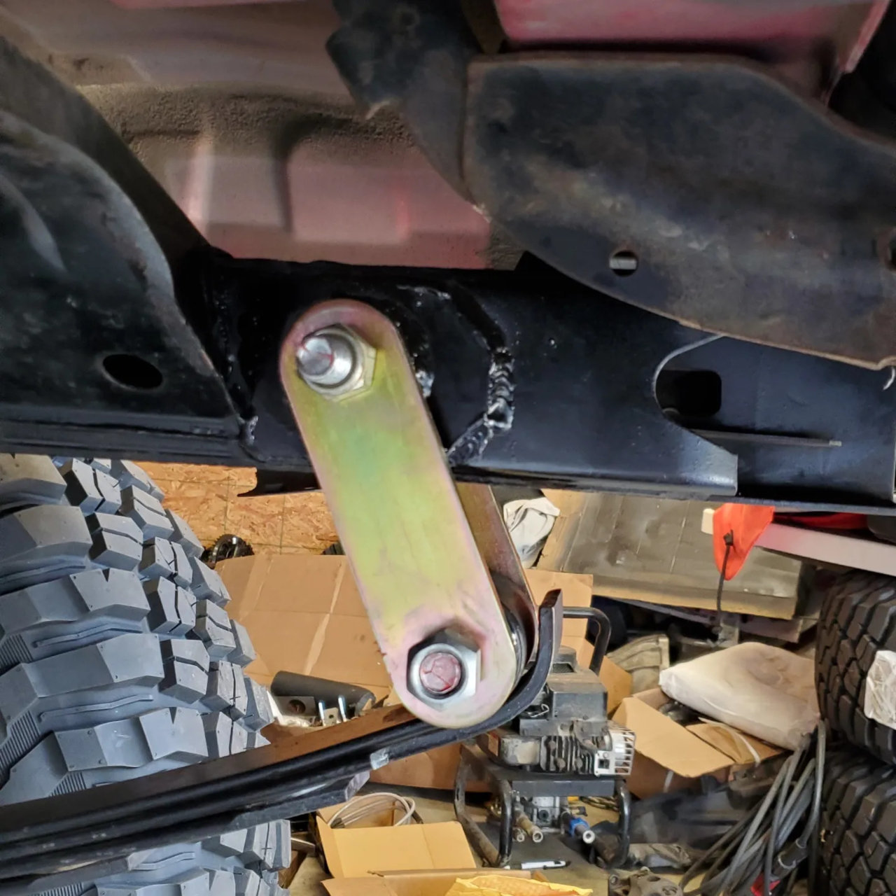

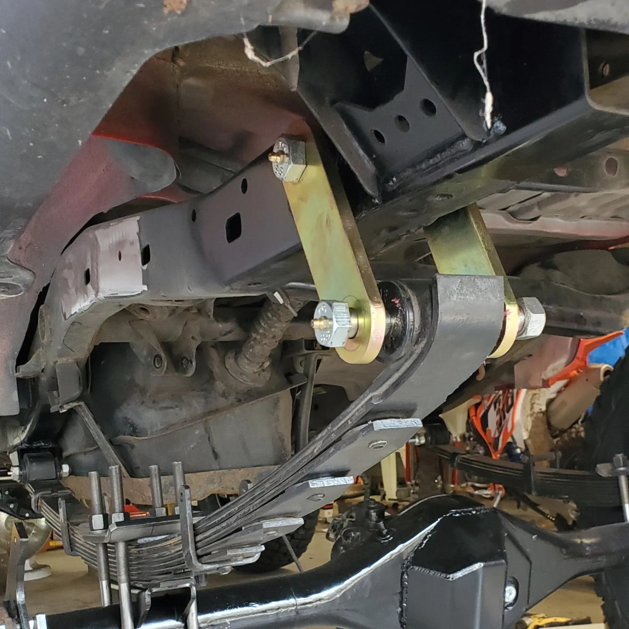

    Awesome build! I just finished my 98 4runner with 4wu kit and used old All Pro rear leafs there are about 57".

    Wow, that turned out amazing...must feel good to have it done! Appreciate the detailed pics for 57" leafs, pretty sure that's the route I'm going. Got the driver's frame rail cleaned up this weekend...progress has been slow.

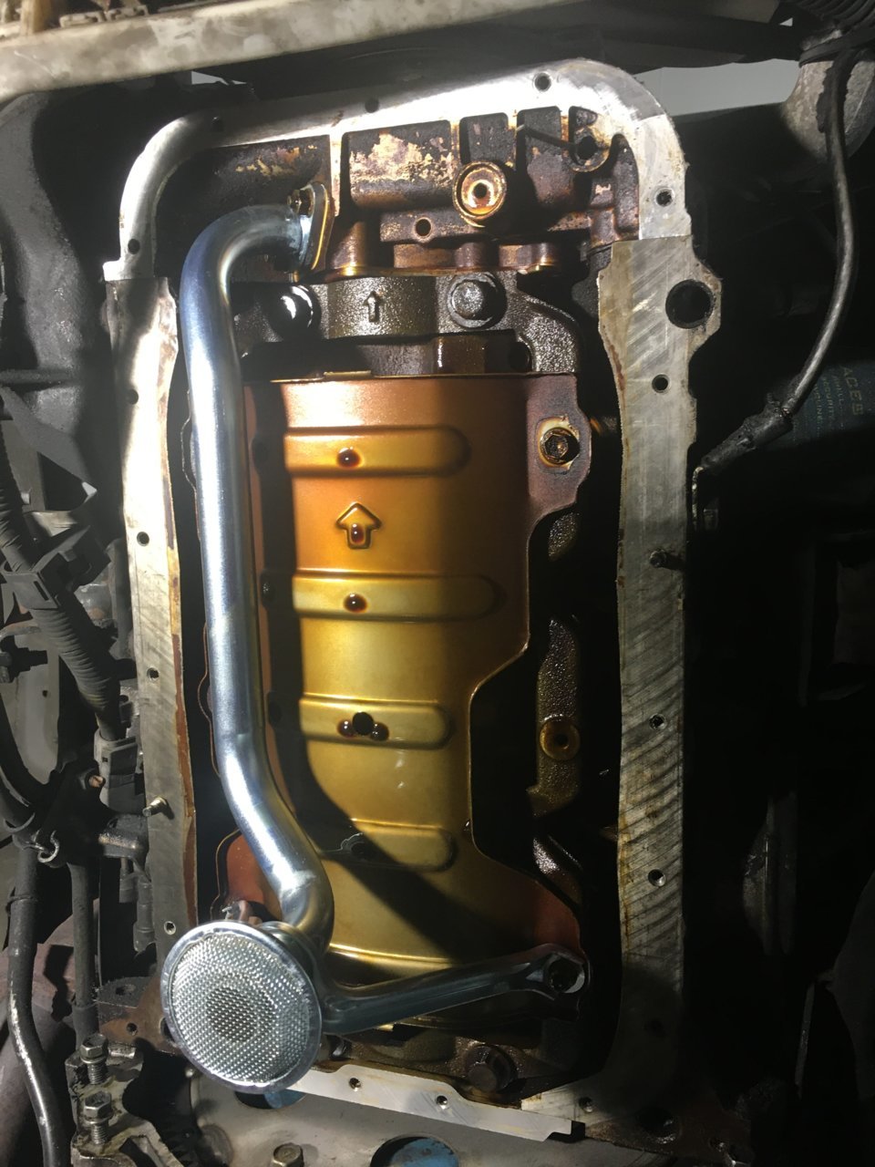

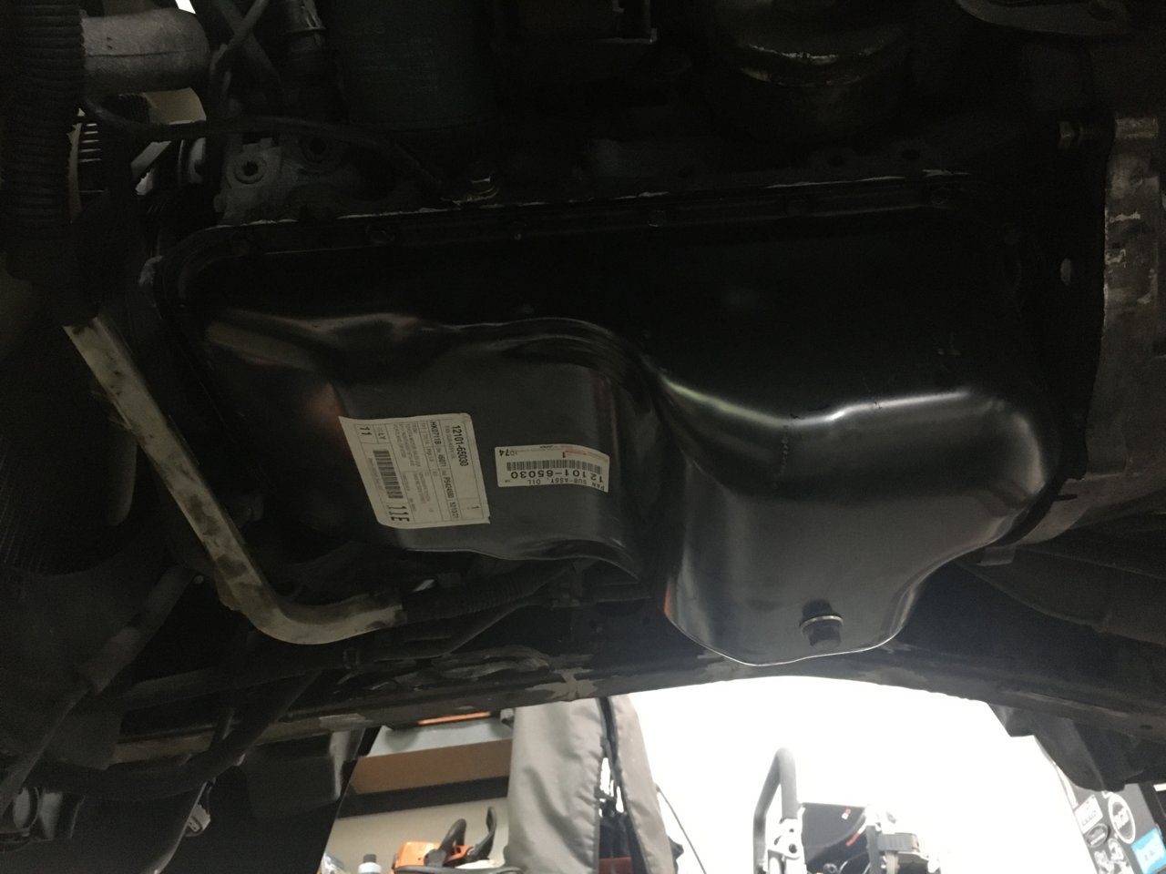

    As promised, very slow progress. Front frame rails are clean and rear sump/pan done.

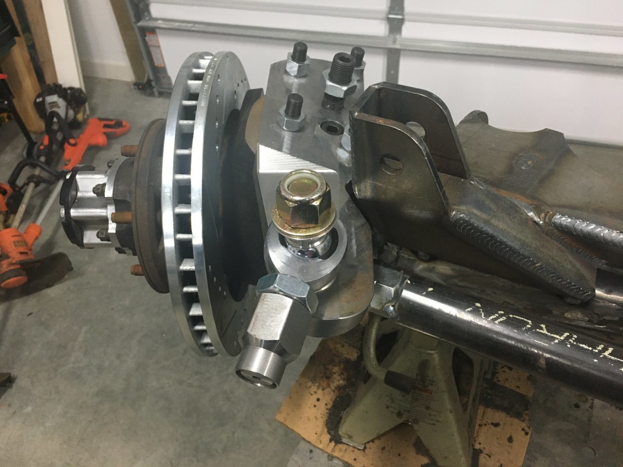

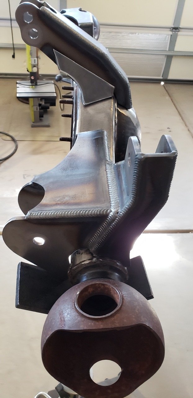

    Steering arm notched and brackets tacked on.

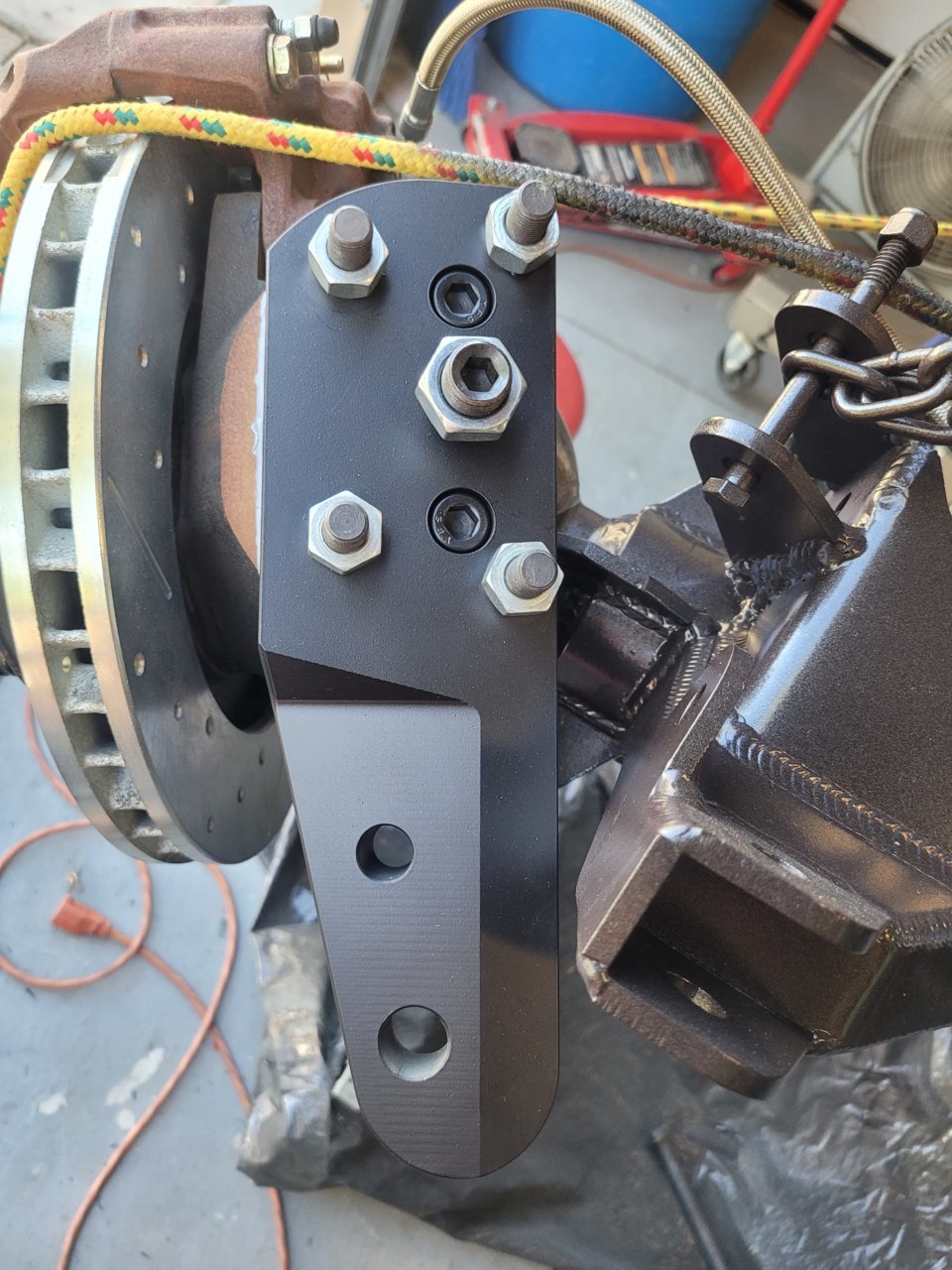

    Thanks for the picture! Your panhard bracket definitely sits further inboard (your axle is wider by a fair amount). Brian sent me pictures of his on an FJ80 axle and his sits just inboard of the tube/knuckle ball bead which is where I placed mine. I may have to place my coilover mount on top of the bracket vs. outboard as there's probably not enough room. I need to get the frame-side brackets on and links mocked up...i'm sure stuff will be moving around once I have a full picture.

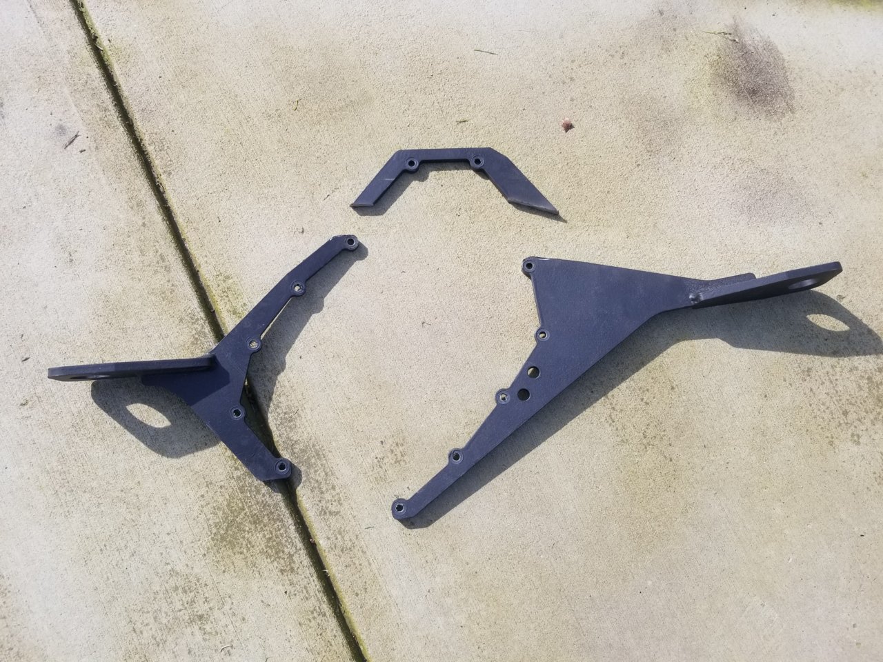

    98rock runner - what did you do for a t-case/tranny mount? I'm about to cut mine out and need to collect ideas.

    I'm running FROR tcase crossmember. Will eventually add a belly skid plate to frame support for the oe transmission mount and rf1a.

    Those cracked fror crossmember are for the rf1a. I haven't seen one cracked for the vf case.

    Turned mine into a 3 (but use 2) piece for easier removal. Plus, my setup is kinda weird.

    I can't seem to find a compatible mount for my VF1 case (FROR only makes for the gear case, or newer taco/4runner chain case). I've sent FROR a question seeing if they make one. If not, i'll probably just fab a simple one up using a factory mount.
