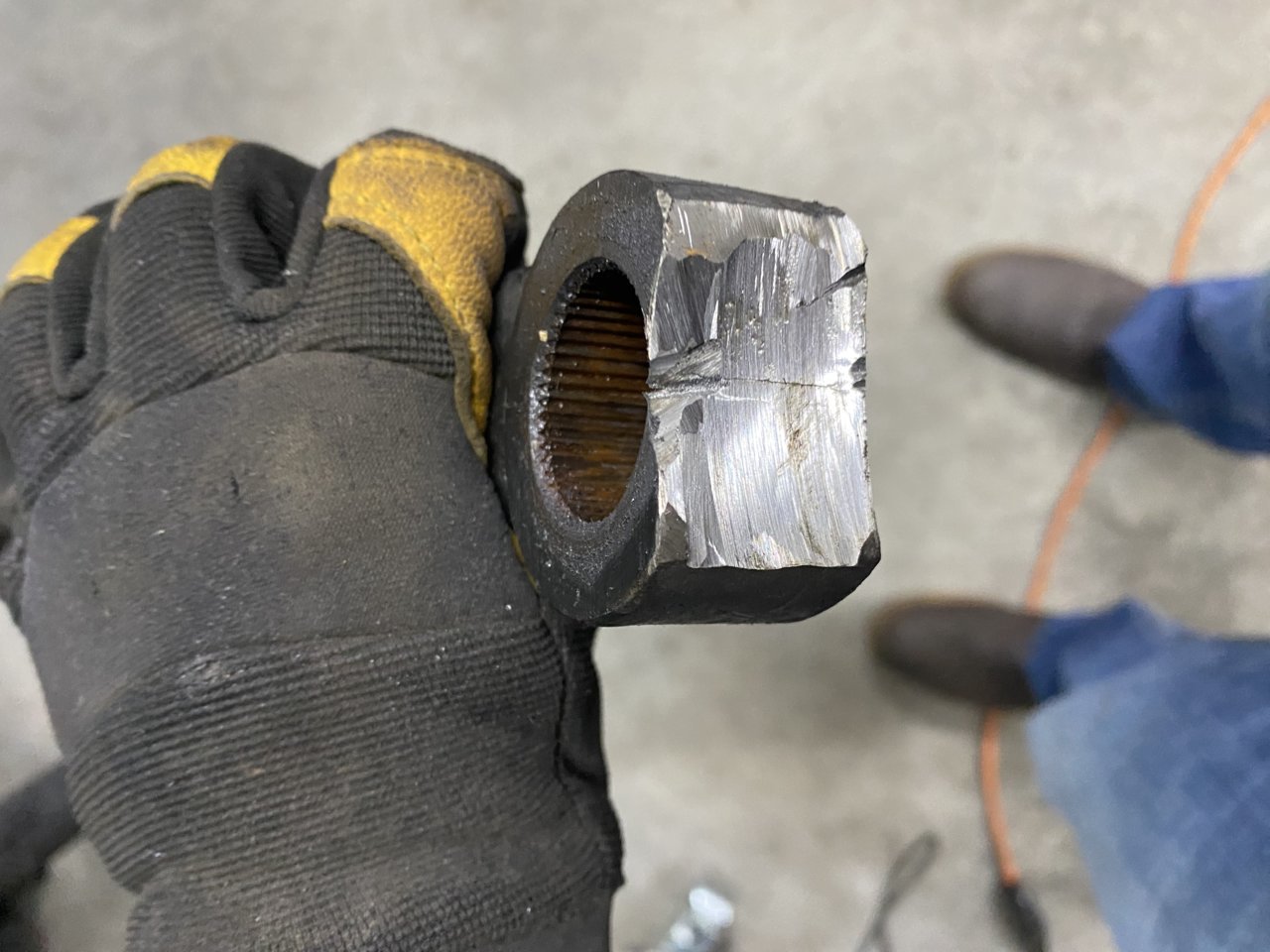

    smacaulay
    smacaulay [OP] Well-Known Member
    Nov 6, 2015
    #168830
    291

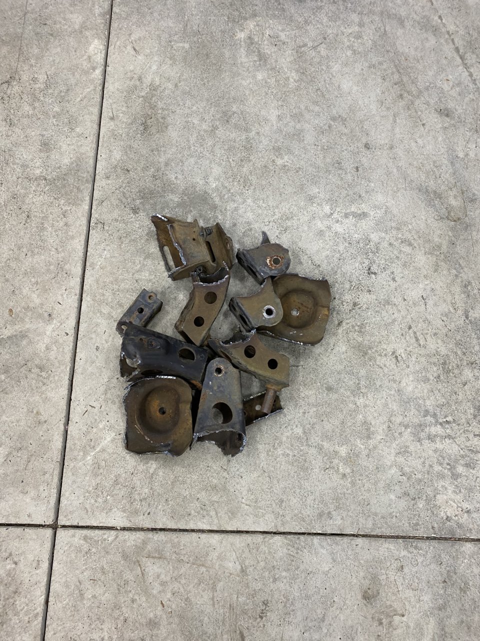

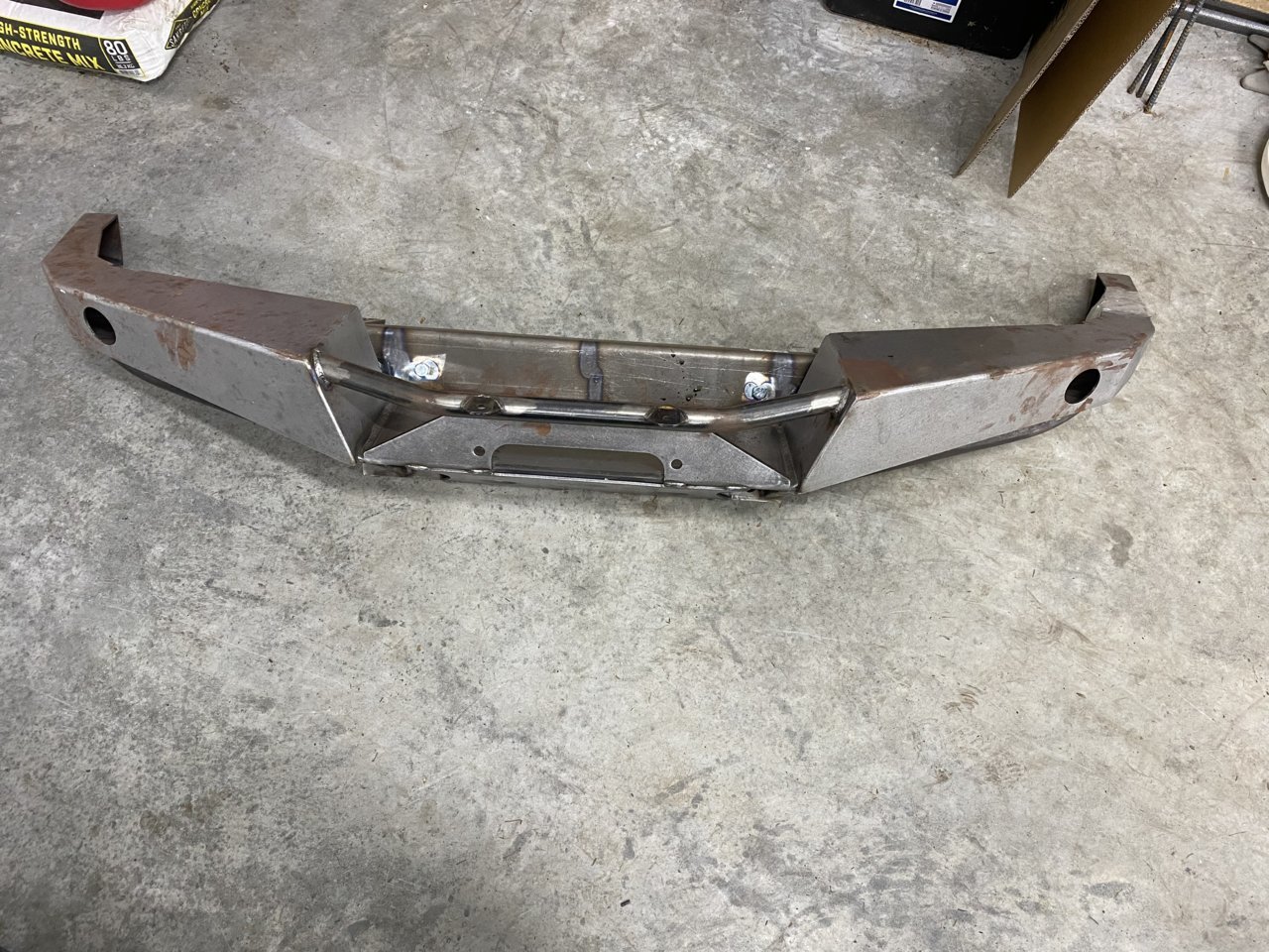

    Have a lot of grinding to do

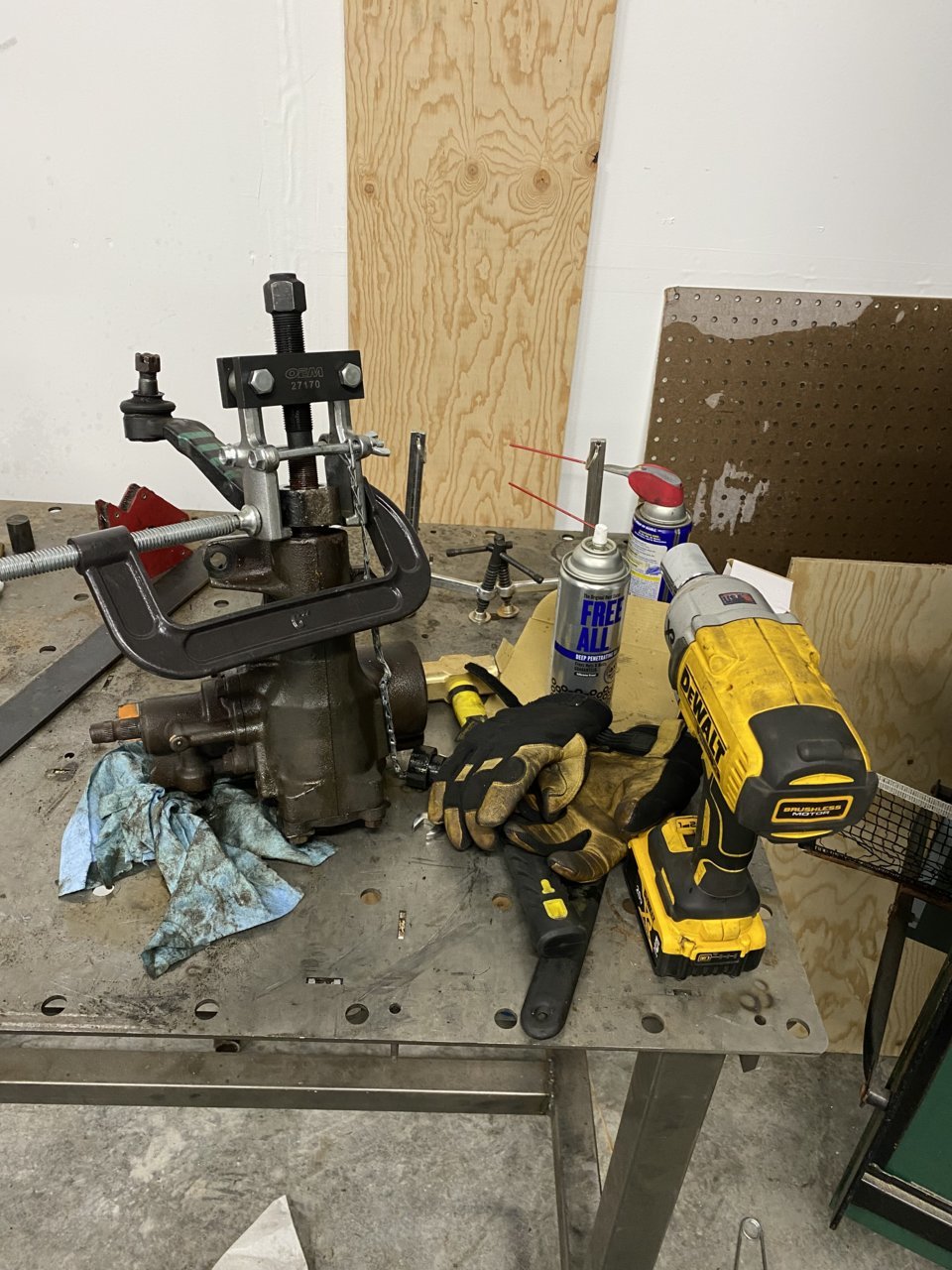

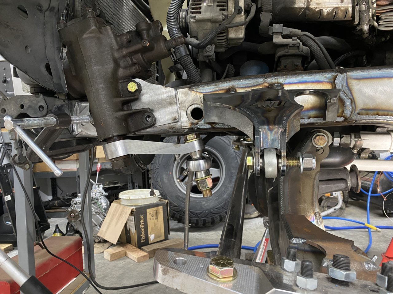

    Pitman arm removal and cleaning frame rails are equal levels of fun

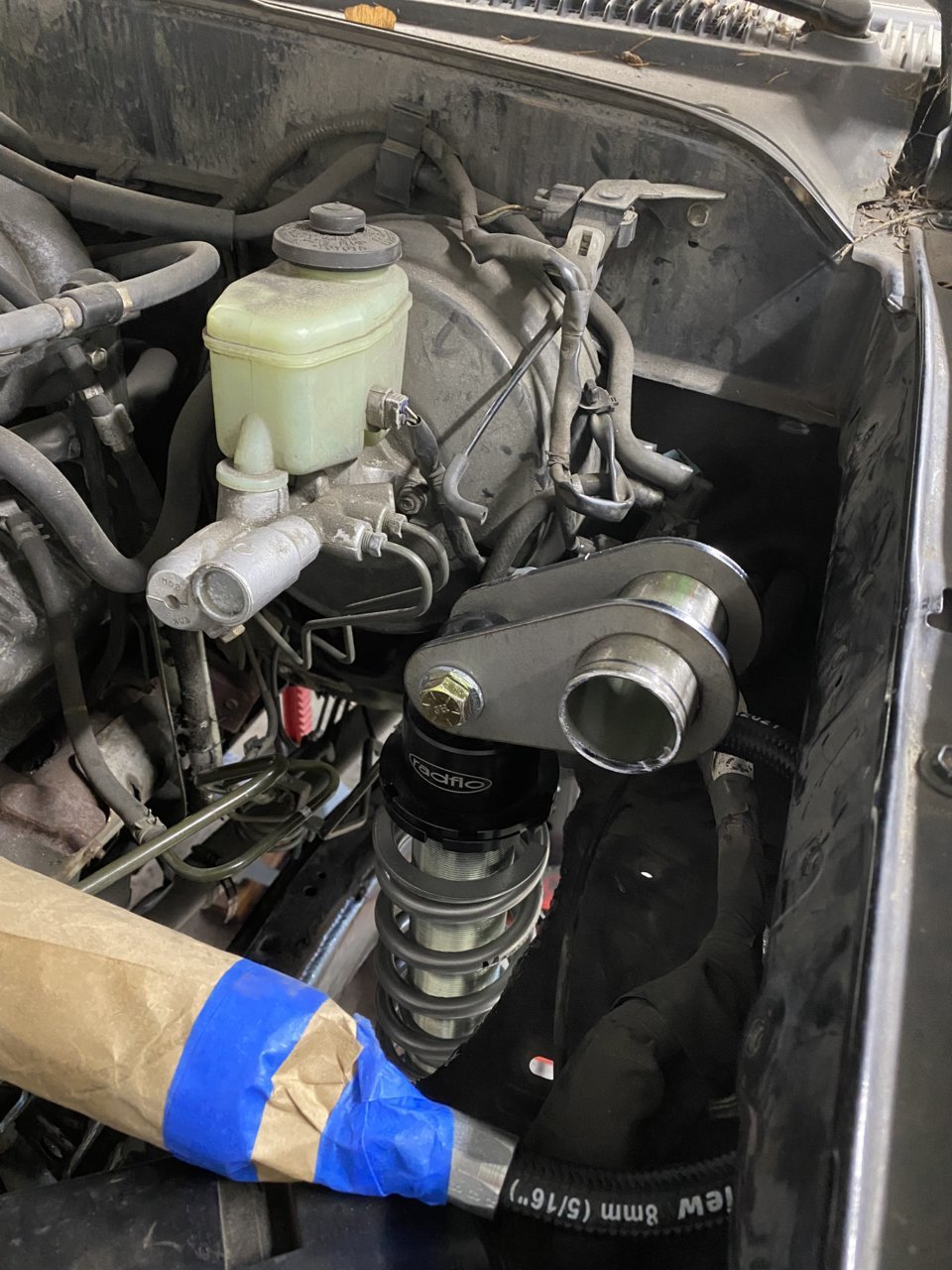

  6. Jan 21, 2023 at 2:26 PM
    #126
    smacaulay
    Nov 6, 2015
    #168830

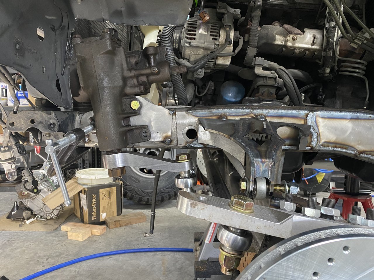

    291
    Drag link heim is still 3/8” lower than the panhard heim (with pitman not fully torqued), probly gonna notch the frame a tad.
  7. Jan 21, 2023 at 2:35 PM
    #127
    02hilux
    02hilux What do you mean there’s no road, I’m here
    Sep 14, 2016
    #197244
    6,312
    Planet: EARTH
    What about tilting the plate and box more down? You have to consider fittings placement if you are running a ram.
    Lock to lock don't bind with the diff cover? TR is very close. Are you mounting the drag heim above or below the arm? Will probably bind if it's under the arm depending on droop, might have to add .25~.50" spacer.
  8. Jan 21, 2023 at 3:49 PM
    #128
    smacaulay
    Nov 6, 2015
    #168830
    291
    Good point, I’ll take a look at fitting placement. Tie rod doesn’t hit the diff cover, but is close. Drag heim will be above the steering arm to keep it inline with the axle side panhard heim.
    I can probably straighten the box and mount it higher, which should provide a bit more clearance…but to get it level with the frame side panhard heim I’ll need to notch (unless being off 1/2” is close enough).
  9. Jan 22, 2023 at 2:41 PM
    #129
    smacaulay
    Nov 6, 2015
    #168830
    291
    Moved the box higher, further fwd, and less angled. 1/2” height diff between pitman heim and panhard frame heim, close enough.
    Duckfatt, Toyoland66 and ToyRyd04 like this.

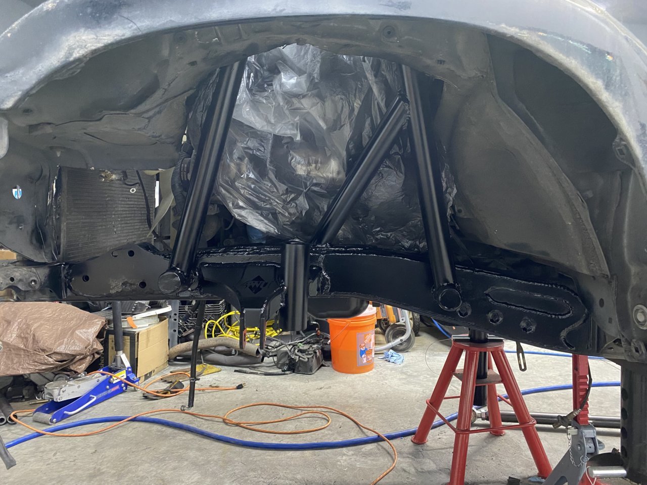

    Seems like this will work, open to suggestions. Will be bracing over the engine, hoops down to tubes off the vertical face of the frame.

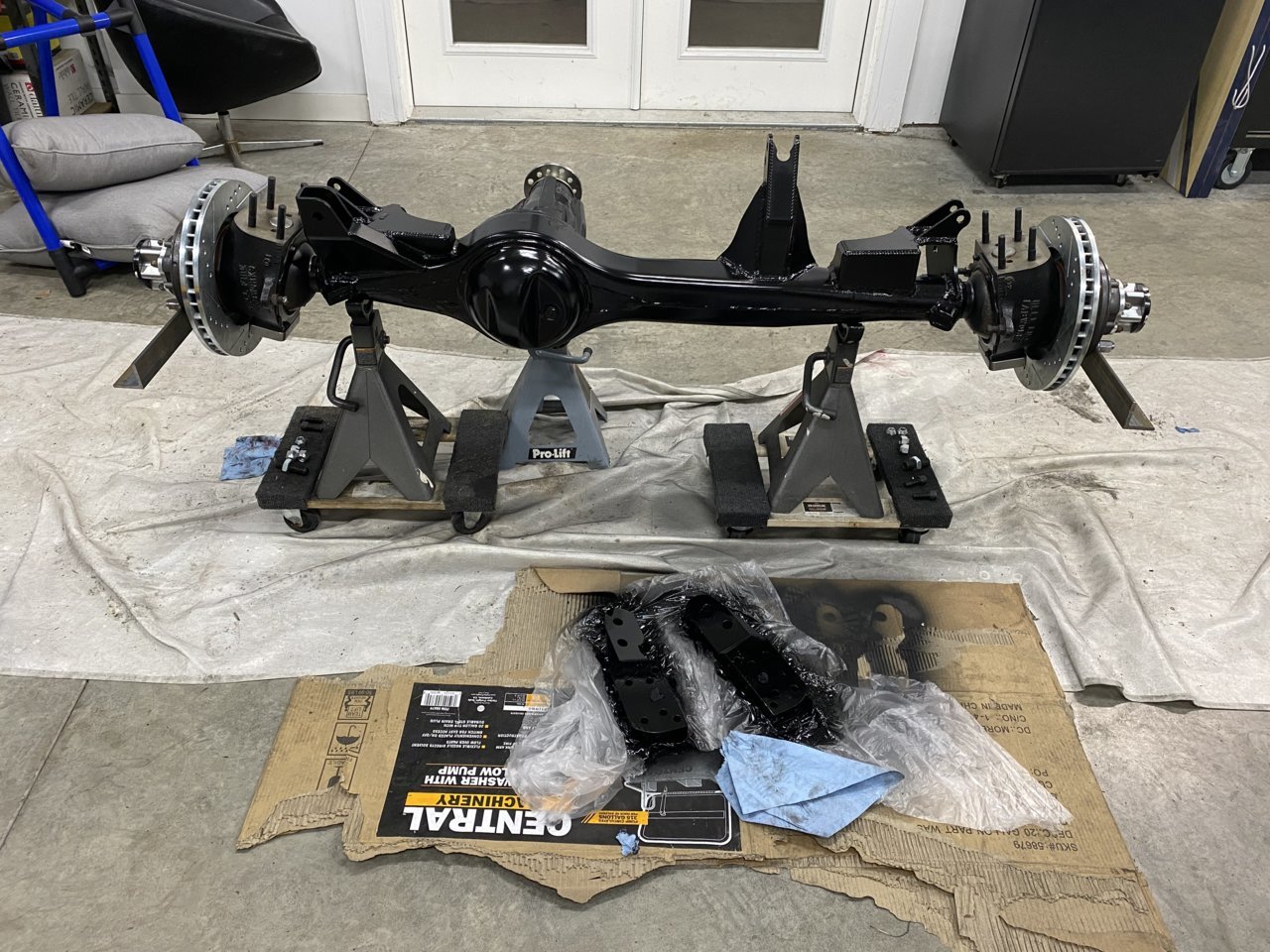

    Diffs are happening

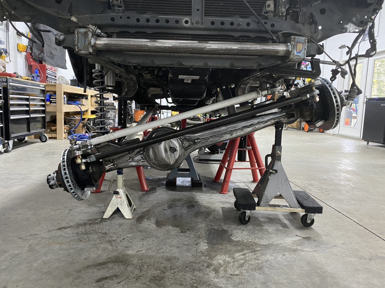

  13. Feb 24, 2023 at 1:59 PM
    #133
    smacaulay
    Nov 6, 2015
    #168830
    291
    Local builder does good work. And of course, a full float fj80 rear just listed locally for $350.

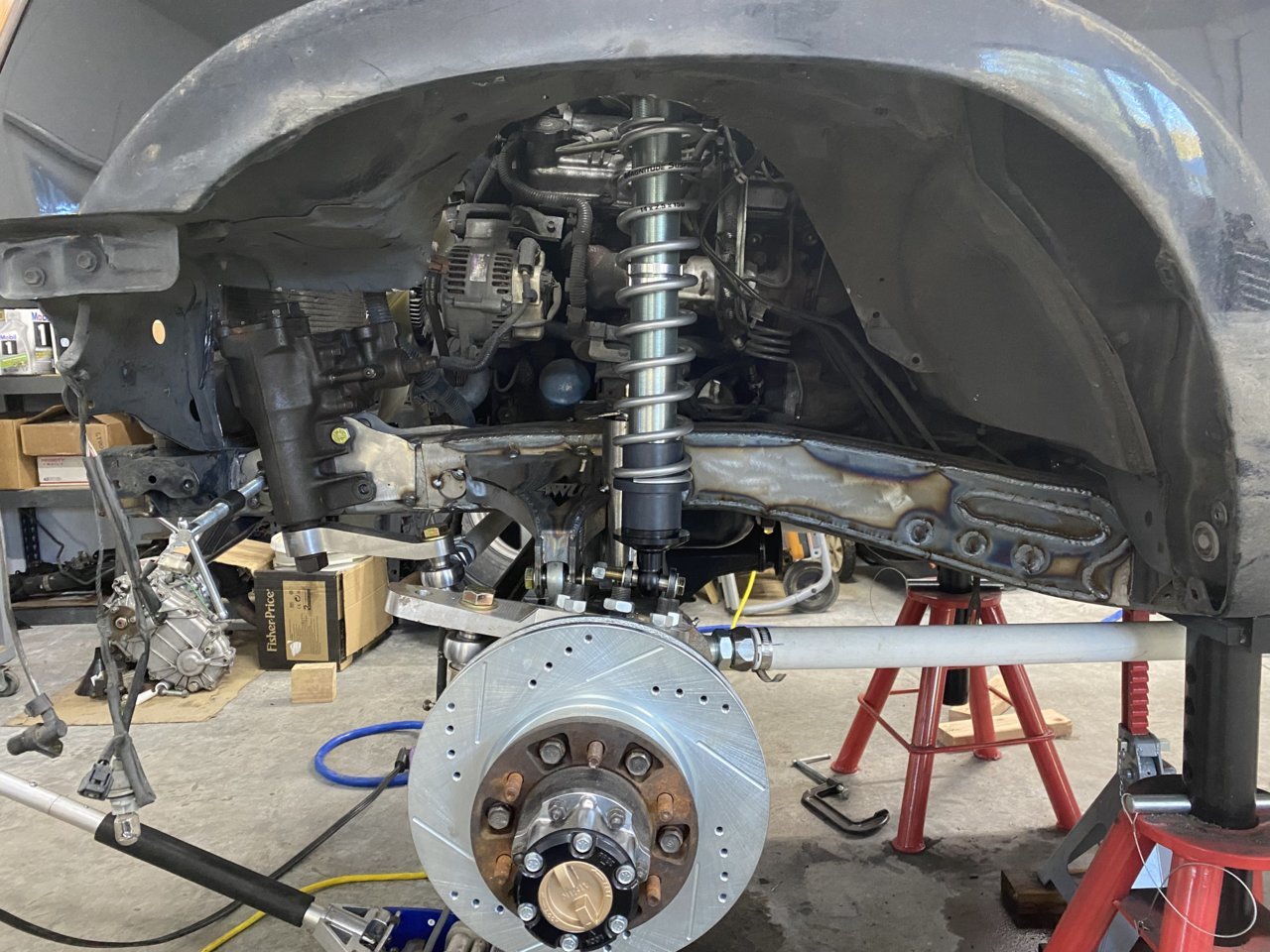

    291

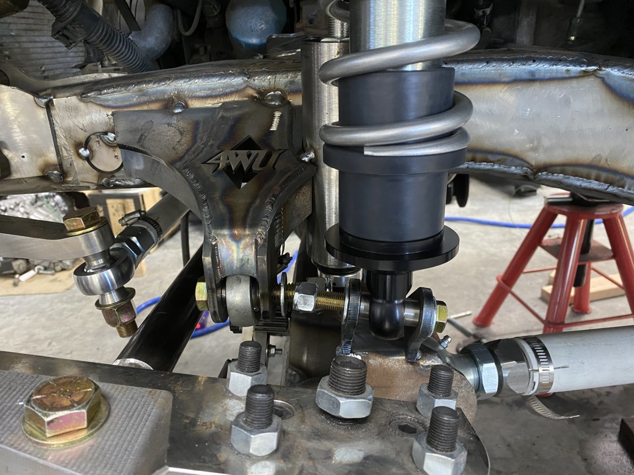

    Had to remake the driver’s shock mount, passenger mount done, steering stops in. Will add braces down to the frame and over the engine. Time to make the front permanent.

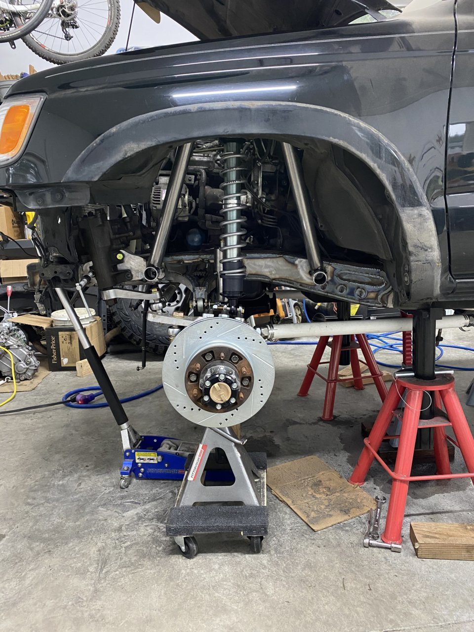

  15. Mar 13, 2023 at 10:11 AM
    #135
    smacaulay
    Nov 6, 2015
    #168830

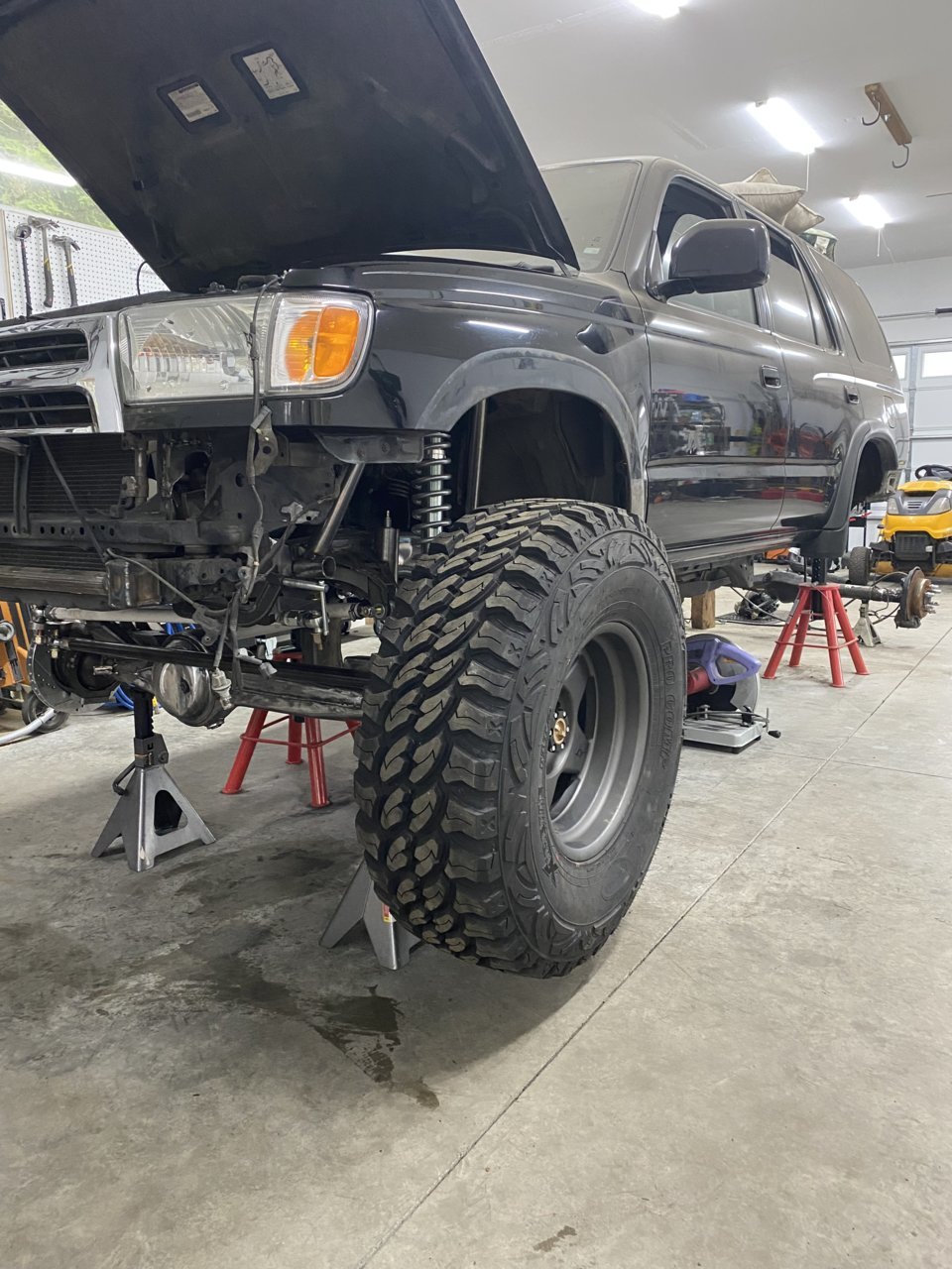

    291
    With 4" of up-travel, frame is sitting at 25" on 37's. Would take a lot more work to get additional up-travel...this will do.

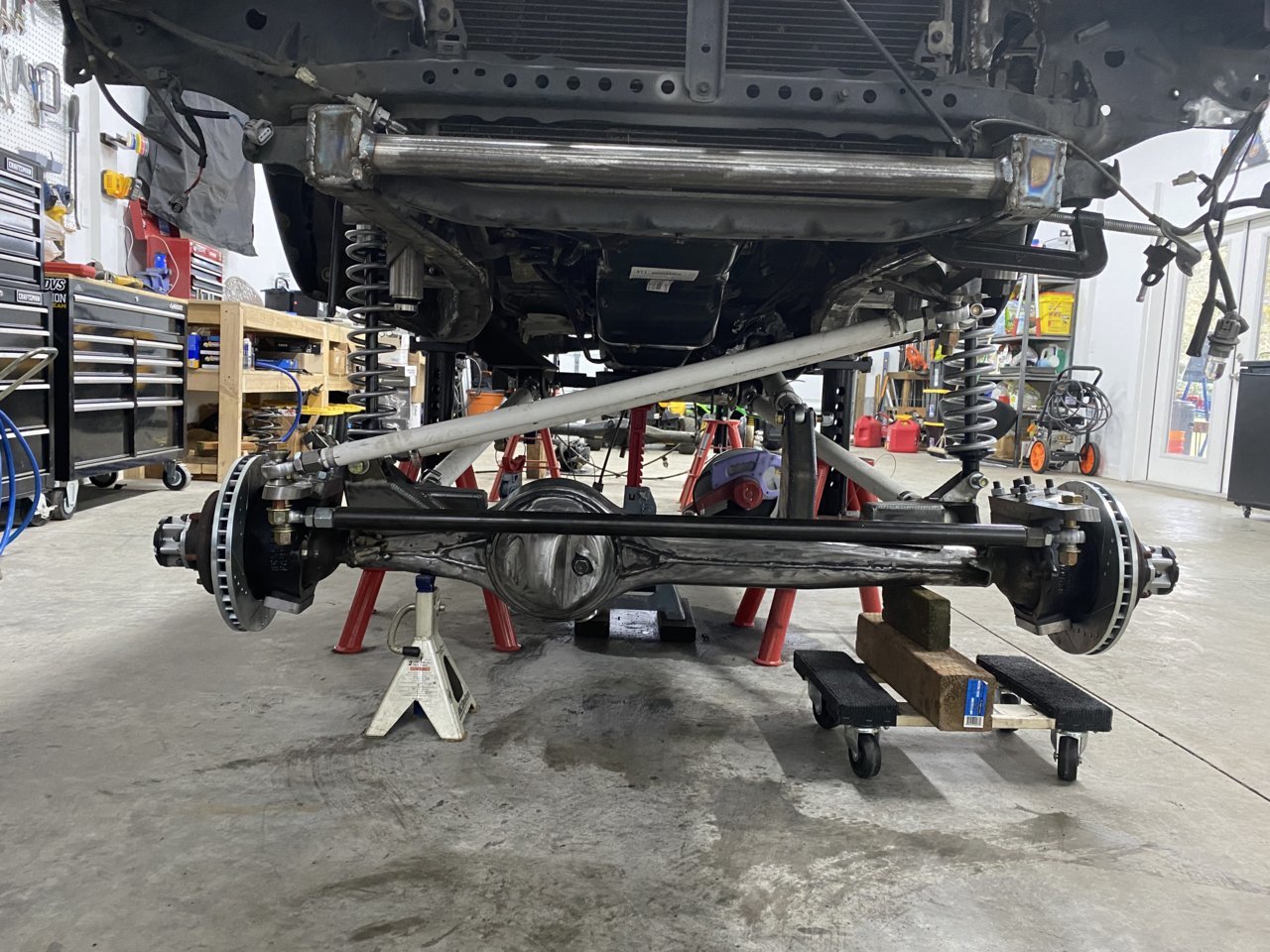

  16. Mar 24, 2023 at 4:55 PM
    #136
    smacaulay
    Nov 6, 2015
    #168830

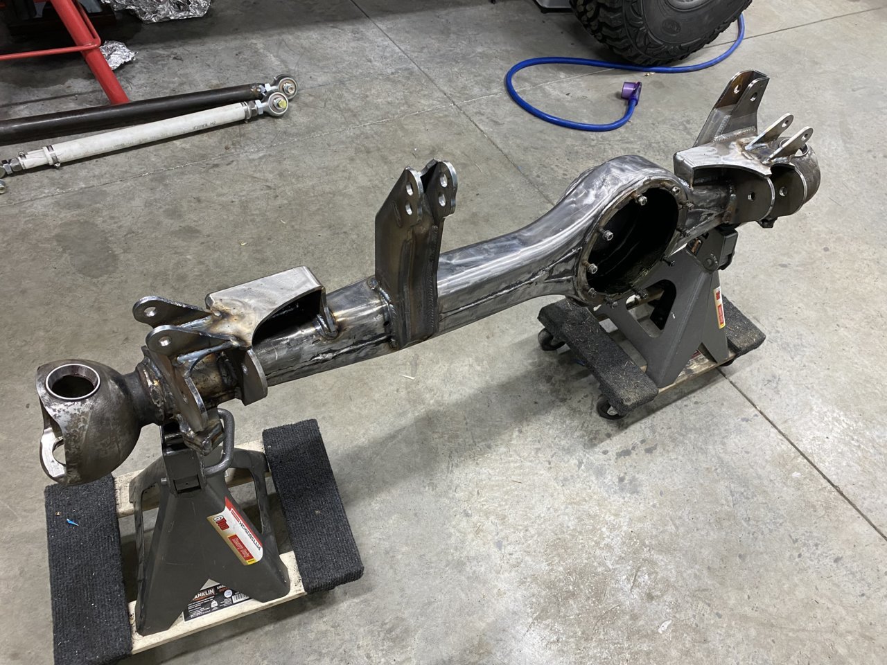

    291

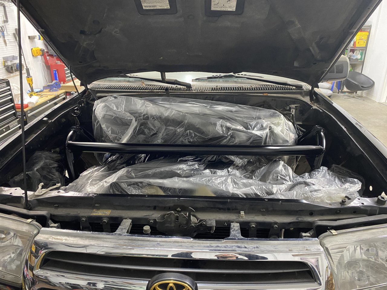

    Slowly plugging away. Lowers made, axle welded up, scored an addicted front for $650.

    291
    Steering box mount sleeved, hoops braced, axle together for hopefully the final time.
