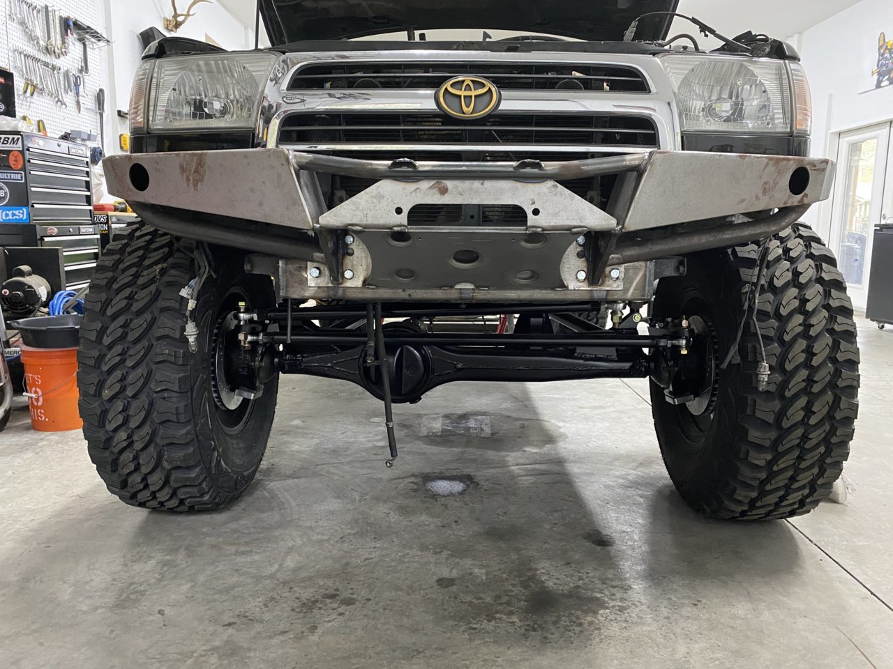

    I wish I would’ve held out for an 80 rear. Hopefully getting the front on the ground tomorrow.

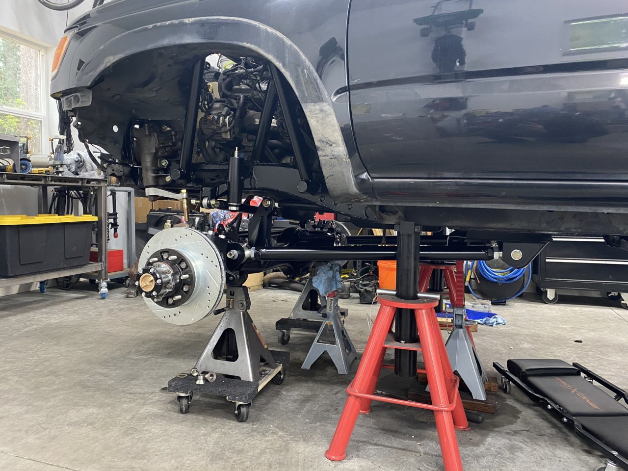

    It didn’t break yet.

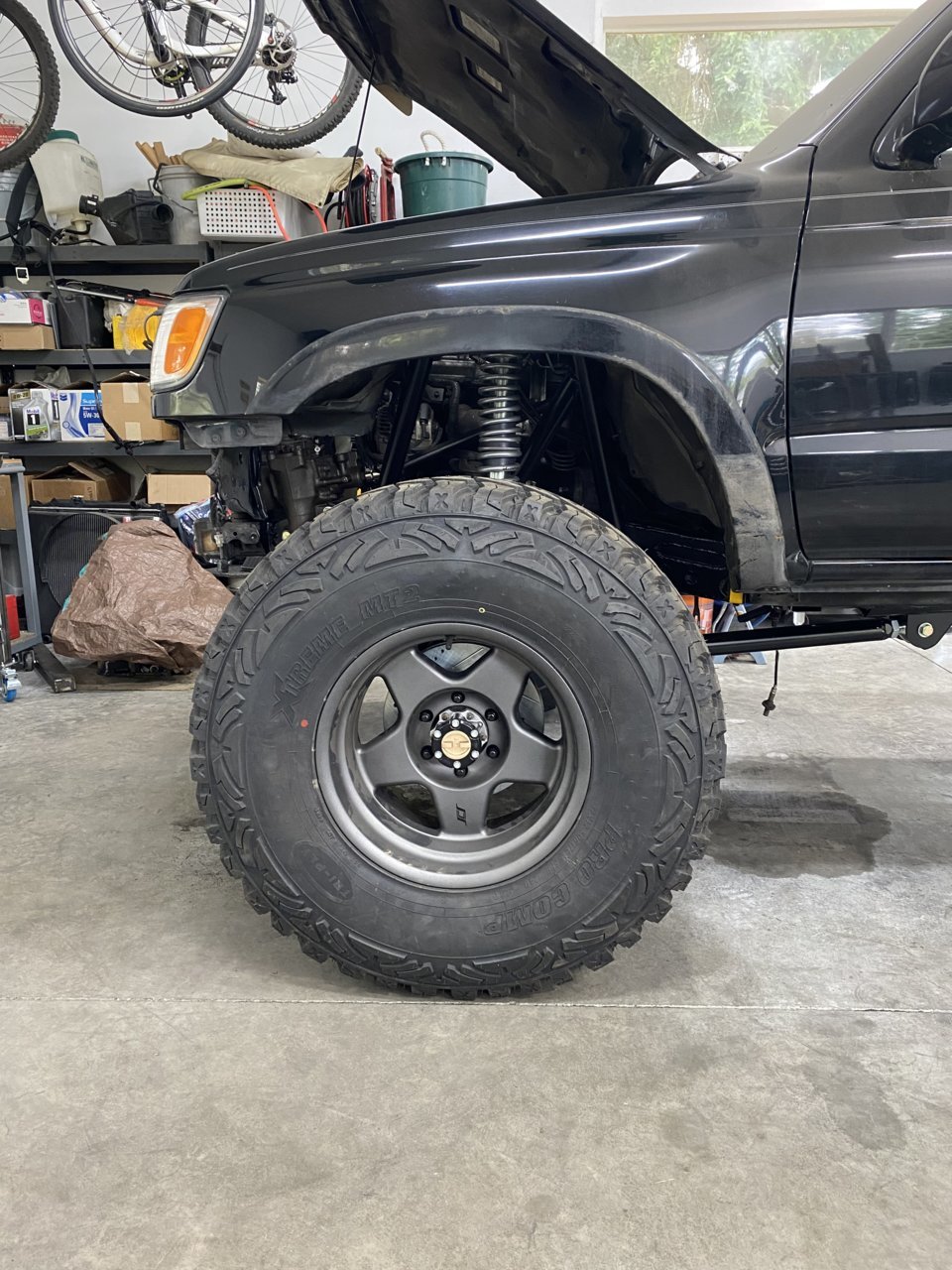

    Ordered some liquid iron rear sliders, ruff stuff front hangers, and trail gear 4" springs (pull leafs as needed for ride height). Decided against going the F150 route (TG springs are also ~57").

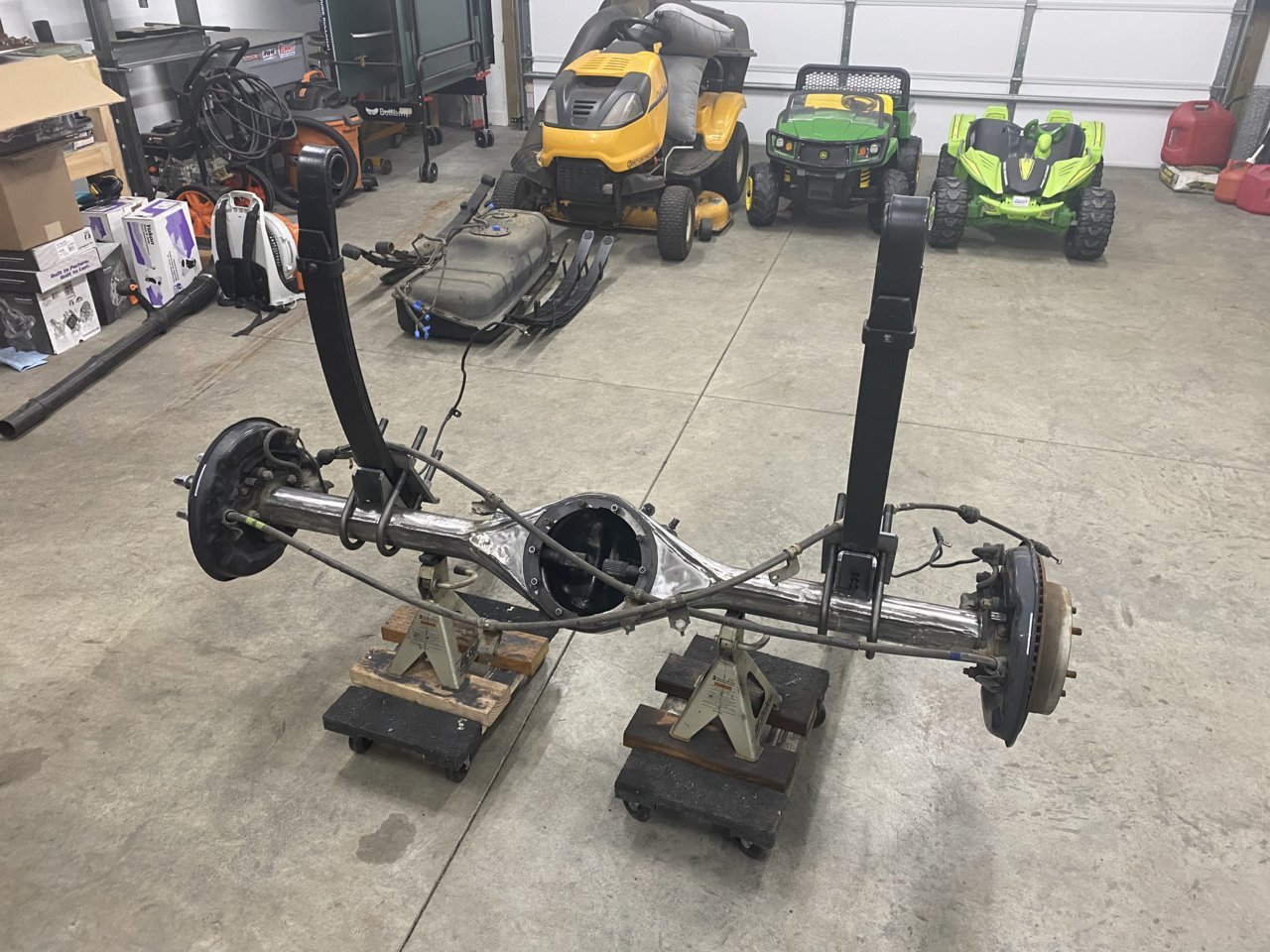

    Gas tank removed, rear frame rails cleaned up, bumper on…waiting for parts.

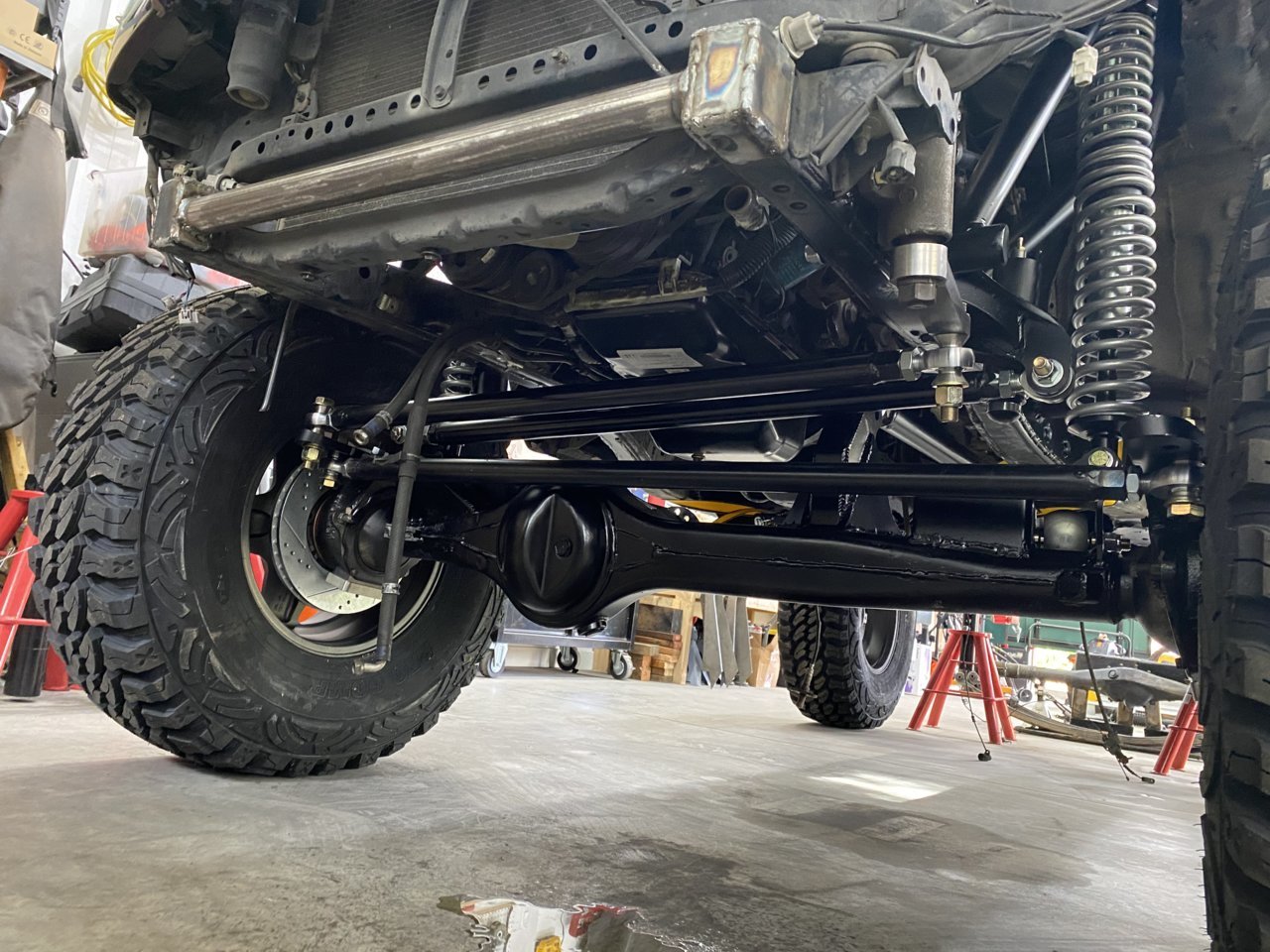

    Damn I should’ve gone high steer. I’m fighting panhard placement right now and I would have no issues if I were high steer.

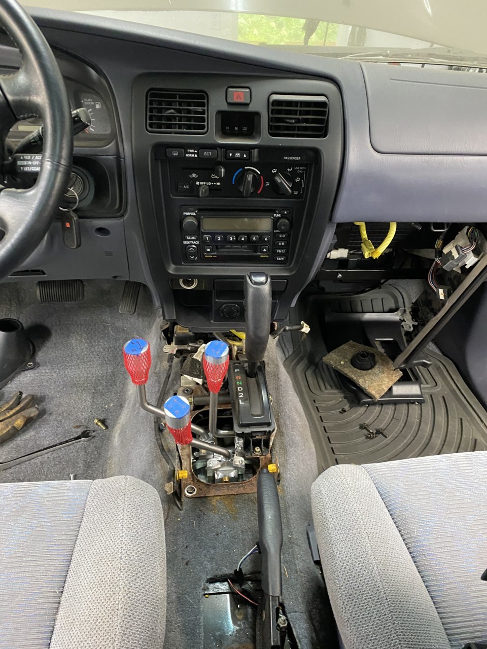

    Well, trail gear bushings are kindof a weird size and utilize 18mm bolts. Drilled the ruff stuff perches out to 19mm, and Amazon'd some 9/16" ID, 11/16" OD bronze spacers to accommodate the liquid iron bolts (and UMHW pucks/sleeves). Need to get the t-case in next.

    Tcase doesn’t fit in its home even with 0 clocking…hammer time.

    Nwfab with 3vz case. Hammered it a bit and it fits, but it’s tight.
