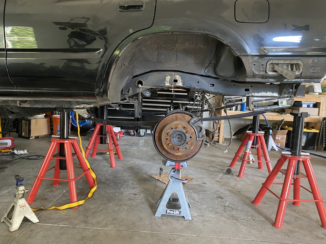

    Weird, I’d think the case would be almost the same. Maybe I have it jacked up too high? Do you still have the factory mount on the rear case, and if so what’s the angle?

    The RF1A seems taller and that the forward output isn’t like a direct line from the input, so you have less risk for interference to the tunnel. The factory mount on it is damn near flat currently.

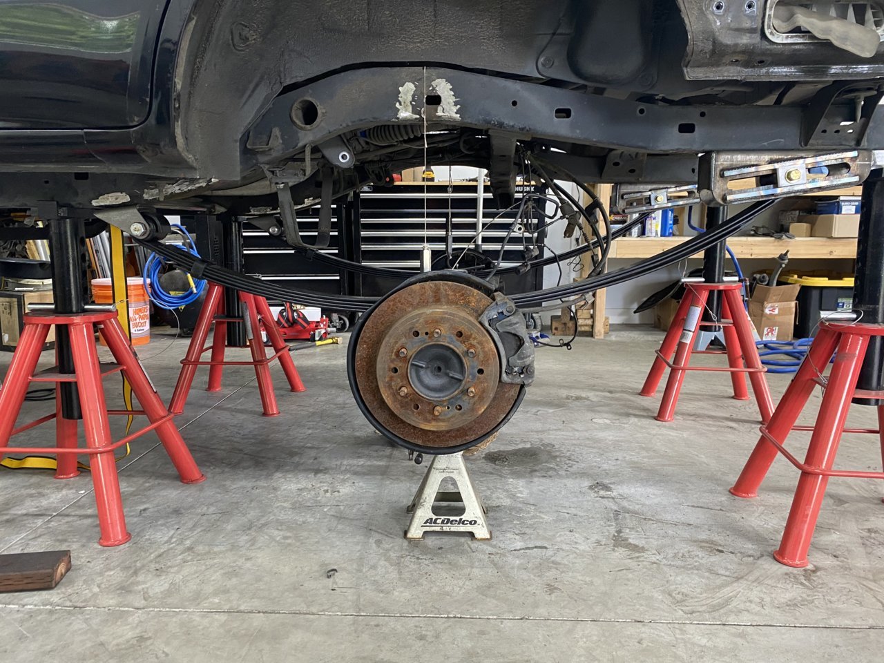

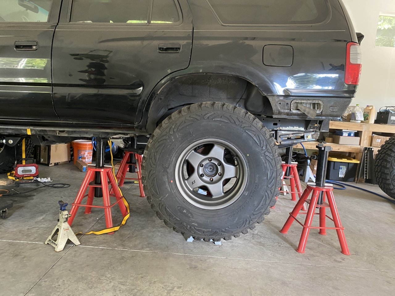

    I’m running out of steam, mounts are going here for now. Gotta build up the packs and set it on its weight to double check before burning them in. Ass will be a little high I think.

    A little high in the rear will be offset when loaded with gear

    This is what my buddies are trying to get me to do. Going to hold out and 4 link it though. Lmk how you like the leaf setup. What’s your plan for shocks?
  10. May 10, 2023 at 9:53 AM
    #170
    smacaulay
    smacaulay [OP] Well-Known Member
    Nov 6, 2015
    #168830
    291
    Long term, i'll probably relocate my tank and 4 link it as well. Shocks will likely be outboarded fox 2.0's. I need to fully cycle it to determine what I can fit and get them ordered. Will def report back.
