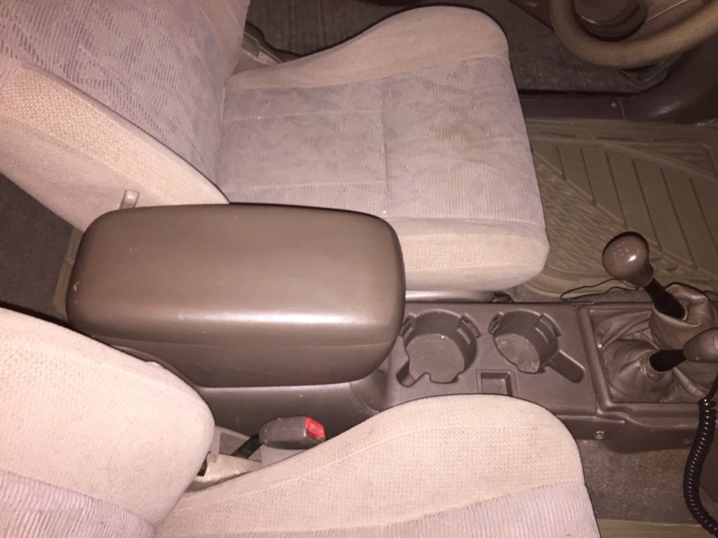

    A while back I put 3rd gen 4Runner seats in my Tacoma. It's super easy! A few people had been asking to see some photos so here you go!
    As far as the install goes, 3 feet line up perfectly, but the front inside needs to be cut off the old Tacoma seat frame and swapped out with the 4Runner seat frame. I cut then bolted it When you test fit the seats, you'll see exactly what I'm talking about.
    Today I installed a center console from a 4door Tacoma. It lines up great. I didn't have pre drilled holes so I ghetto rigged it with self taping metal screws for now. If it gets loose I will drill out and bolt it down.

    Strange, my 01-04 console bolted right in

    What is different about the 4 door console?

    00 SR5 yeah, difference is, actual cup holders, and instead of one compartment there's two on the 01-04s. Much better console overall

    Odd I have a 00 SR5. Yea the dual compartments are nice

    I also have the TRD package and I had a console and bucket seats
