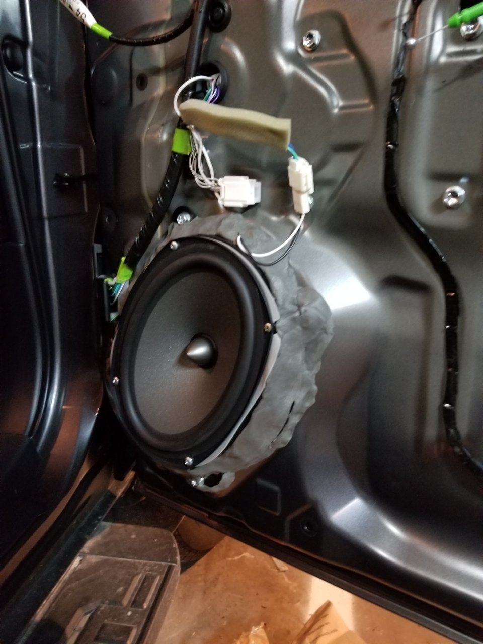

    OEM audio plus, dual amp
    Focal 6x9 components, $299, toyota specific so they come with the needed 6x9 ring. I have em in our 16 4Runner powered frrom the head unit and they rock. The gray duct seal in the pic covers the 6x9 adaptor, it was added as that stuff adds mass to the plastuc ring.20180203_162930.jpg
