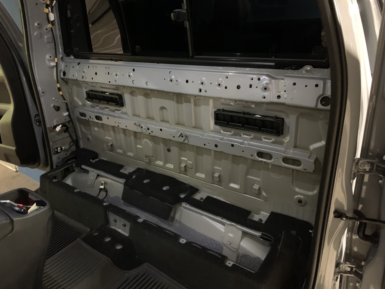

    Trim panel removed:
    Delete panel installed (note this is a 2015 with grey panel 64270-04140-B0 installed, the panel is the same just a lighter colour):
