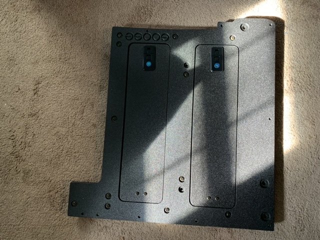

    Got my Goose Gear platforms in this week. Well made and as advertised. Hopefully can get time to install in the next week or so.
    DB6268A0-CDD8-4ED0-B2CF-32C034776765.jpg 9E78AD29-D493-4979-93F4-3851E84938EF.jpg

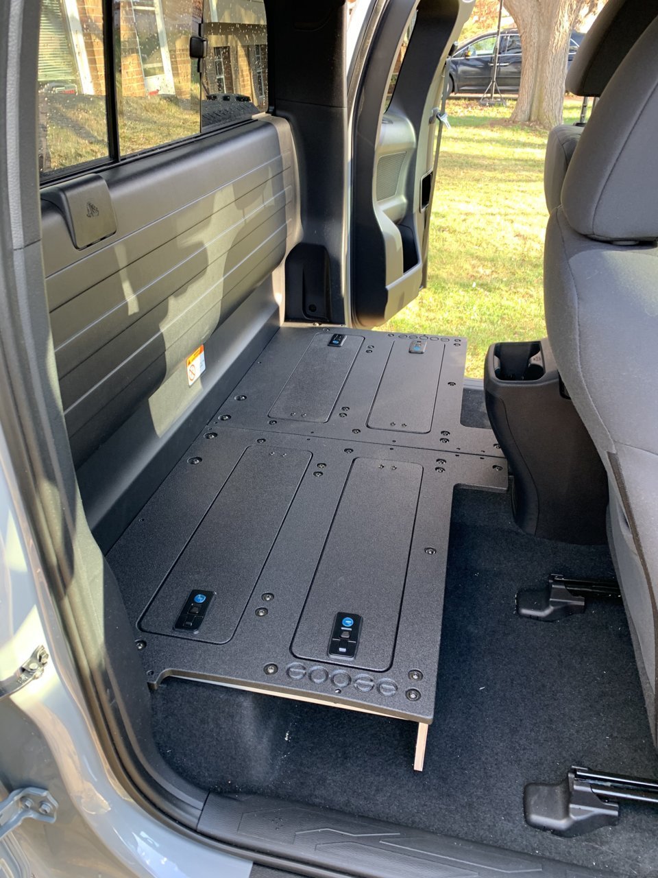

    Spent yesterday putting sound deadener on the back and got the platforms in today. Love the way it turned out. Dog can fit now and much more usable space without the seats!

    Looks great!

    Came out great!

    looks great, wished the back wall was that clean looking on the double cab option. i would pull my seats and do that, in a heartbeat. Ski

    Thanks, the utility panel really does take up less space than the panel with the seats. I'm really happy with how it turned out.

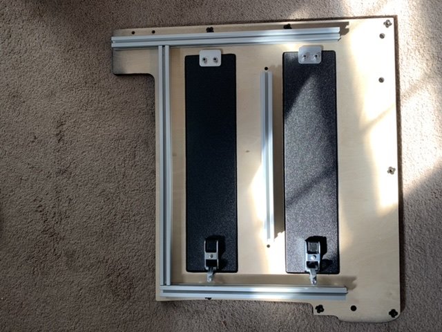

    They are definitely spendy, so speaking just for my own needs, I believe they were worth it. The price that I had to pay for that utility back panel actually stung a bit more than the Goose Gear platforms. I did see on their website that they now offer a set where you keep the seat back panels. I do believe they are a bit overpriced for what they are. Some things I considered when going back and forth on deciding to buy or build:
    1. To your point with the clean/factory look, that was definitely a driving factor. I bought my truck in September and it has less than 5K miles. I decided I wanted something as nice as possible to complement the truck. I plan on having this truck for years so I've had a real buy once, cry once mindset with it considering I'm planning on many years of use. I wanted something more than just a carpeted plywood platform which was my original plan
    2. I've done a bit of woodworking and carpentry, I have the tools needed. I also know that to make something that is on the same level as the Goose Gear would take a bit of time and money. The cost of baltic birch ply, the hardware, 80/20 extruded aluminum and having it Line-X'd isn't cheap. Then there's the time to measure everything, get all the curves and contours right, make a template to route out the hatch doors...it's a lot of work. While I'm competent with this, I'm also not a pro so I make a mistake on something and waste a $100 sheet of play, then I need another one...haha.
    Some things I don't like: I feel that the bottom should be fully enclosed to make a compartment for the forward hatch. The front supports aren't line-x, they are just raw plywood, doesn't even seem to be coated in any way, I think that's pretty cheap and cutting corners for the price paid. Other than that, they really are a solid product that fit the functionality needs I had and look pretty good.

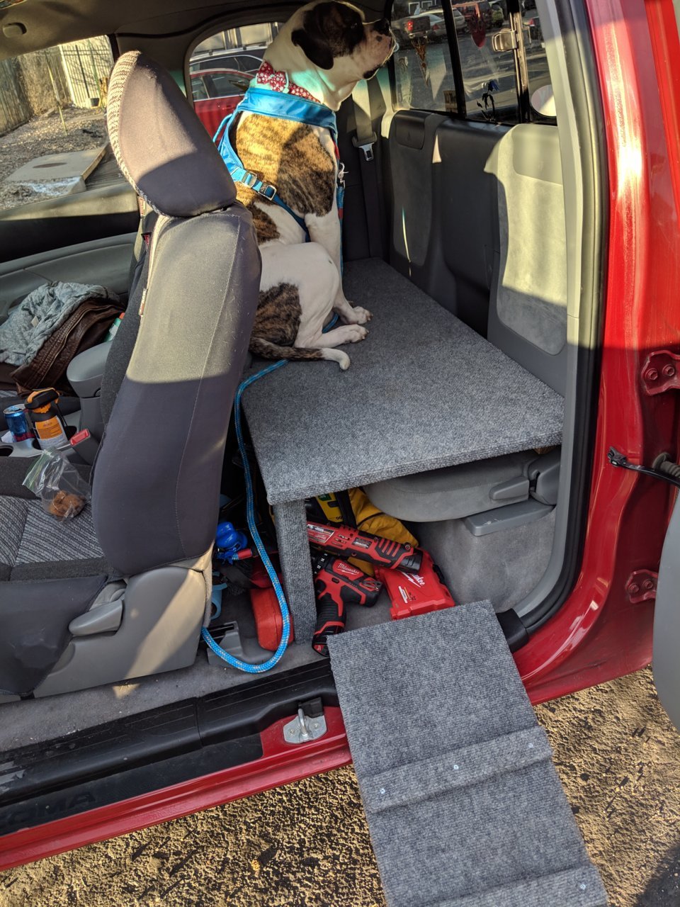

    I'm looking at these again as the stimulus check is pending one of my bank accounts so they're looking more enticing. I'm also looking at the 2nd gen AC version, which looks to have the front/sides of it more enclosed/lined. I live in an apartment so I don't have the means to make something of this quality. I had to make the one that I have out on our patio with the saw extension corded through the doorwall. I think if/when I do get this, I'm going to have to fully embrace the 'buy once, cry once' mentality as the plywood one I have in there now is starting to come apart. This also sits lower than the one I have in there now because I didn't pull out the bottom of the seats or the middle console in the back yet. When I put in the plywood one I have, I had to make a little ramp for my dog to get in because she's a lazy bulldog who can't get her ass up that high and the Goose Gear one is low enough to alleviate that, I think.
    Thanks for your feedback. Considering your drawbacks seem to be a non-issue on the 2nd gen AC version, I think this will be something I invest in.
    EDIT:
    A pic of the one I have in there now for reference (with said lazy dog):
