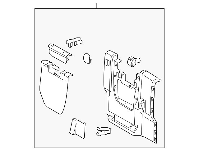

    How do I find that rear panel? I tried ordering one with the part number that was posted and they sent me the wrong part. I also went to a local dealership and he said that they discontinued that part. Does anyone have a link to that exact part where I can buy it?

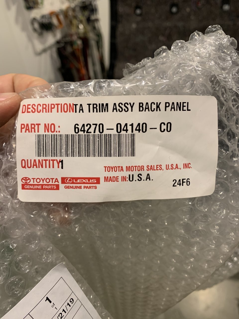

    Did you use, “64270-04140-C0?” If so, what did they send you instead? I ordered mine earlier this year through Toyota of Lake City (Washington) - they have great customer service.

    When I search for this part number (64270-04140-C0) online or an online toyota parts site the results are a different looking panel. This is what is coming up.... I placed a delete seat in the back cab and this won't fit, also I prefer the version that is posted in this thread. That design might be discontinued.

    Search 64270-04140-C0 on Google. The C0 is black; I don't know what the other color codes are.
    If your VIN isn't an SR5, the dealership will tell you it doesn't fit but it does. I shopped around online, then had a local dealer match the price.
    https://parts.toyota.com/p/Toyota__Tacoma/TRIM---BACK-PANEL-BLACK/66815207/6427004140C0.html

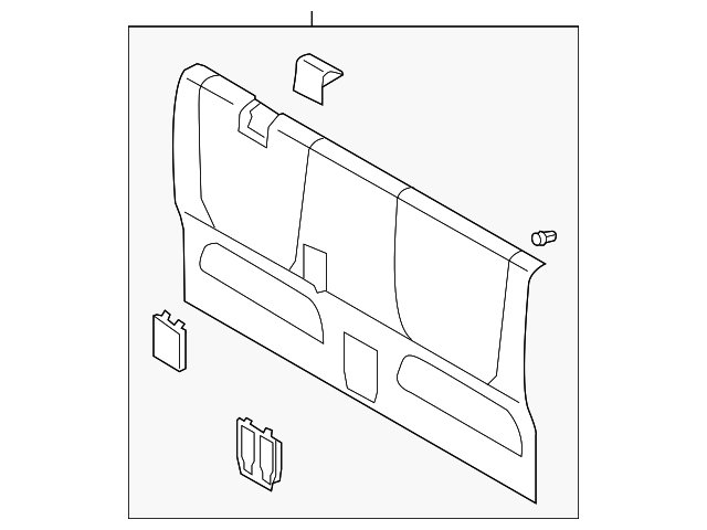

    Does anybody know if this will fit a 2019
    Part: 64270-04140-b0
    The new version of 64270-04140-C0 is very different from those posted on this thread.

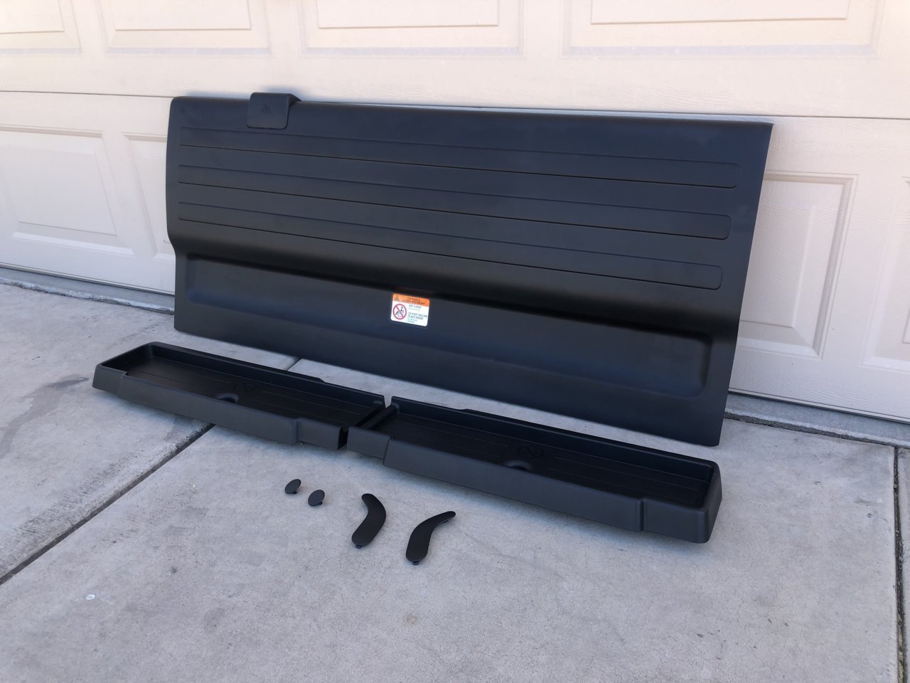

    When I got mine (the panel in the middle leaned up against the garage door), the number was 64270-04140-C0. This was the back panel for a SR5 access cab. When I changed out mine, the dealer swore up and down it wouldn't fit an 2016 OR and I'd have to pay a restocking fee if I returned it. It snapped in just fine. It's not like Toyota built different cabs for SR5s and ORs. BTW, I didn't get the storage lids or the other parts; this is a stock photo, but it looks like the back panel I put in.
    It looks like the single piece back panel is now 64270-04140-B0, although the pattern on it doesn't look like the one I bought; it looks like it has indents for seat backs.
    https://www.discountpartsmonster.co...LiOHqdgGFJ9qkvvGsMZ9Lh028WqJ9nXhoCAlcQAvD_BwE
    The other one (64270-04140-C0) now is a portion of the two piece back panel with the two jump seats.
