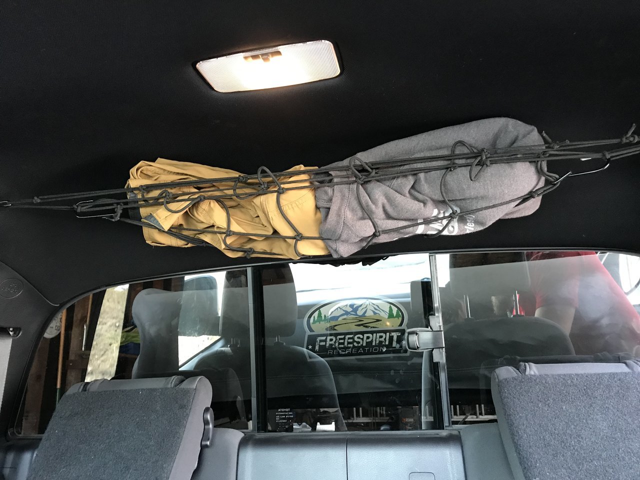

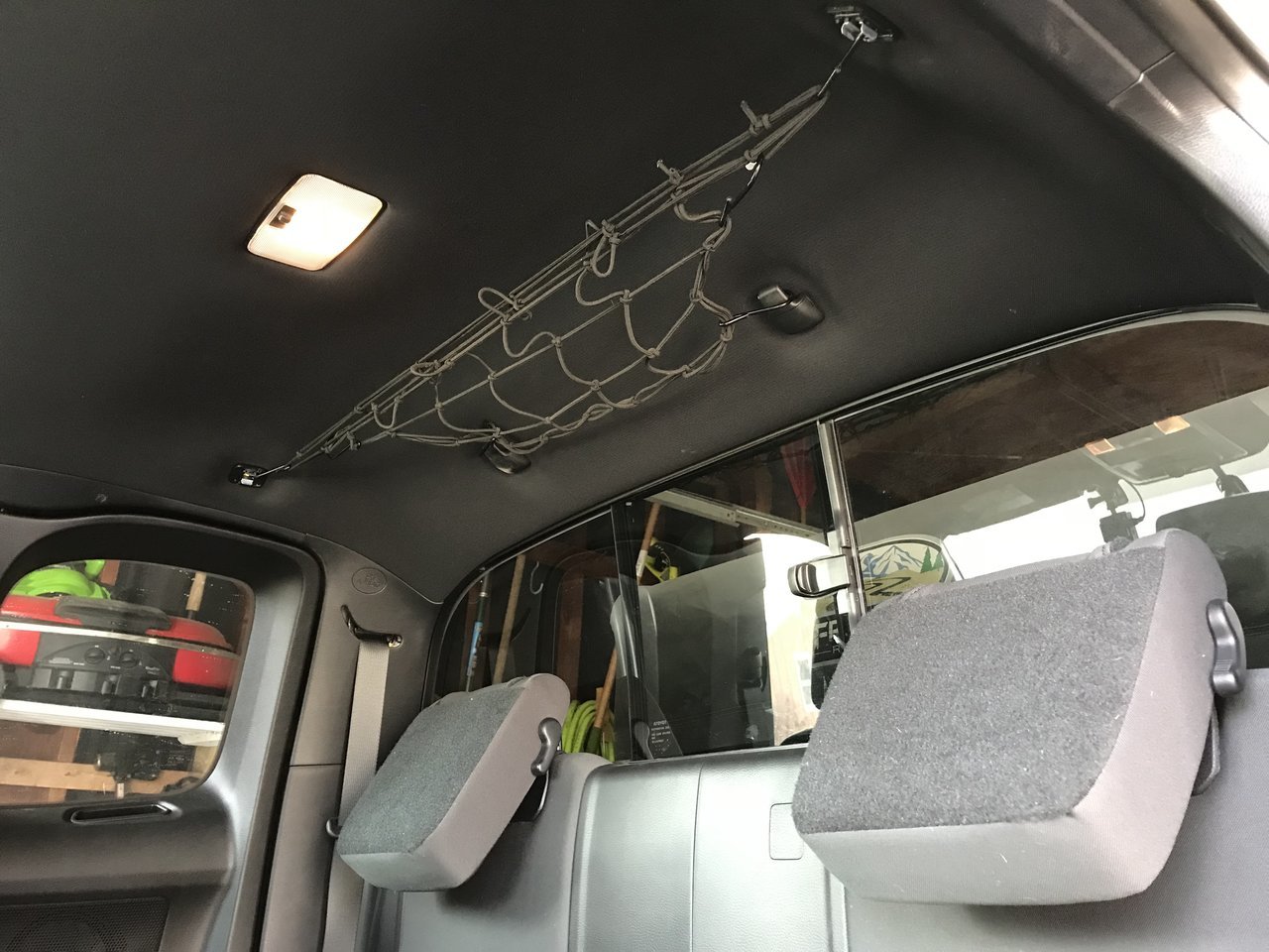

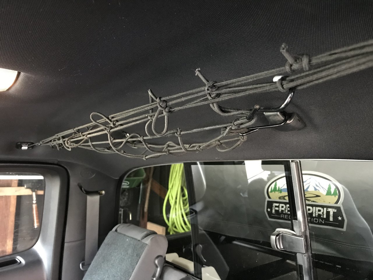

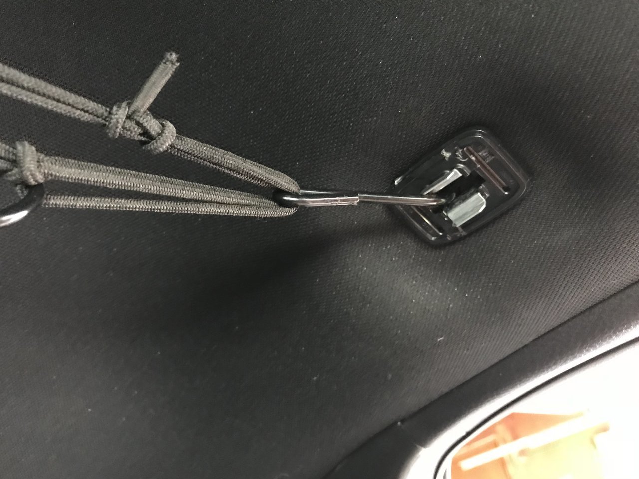

    For anyone who might be interested I was actually just cleaning out my truck today and stumbled upon a way to string up a cargo net in the back of the 3rd Gen access cabs. You can use any 12x12 or 15x15 cargo net (https://www.amazon.com/s/ref=nb_sb_noss_2?url=search-alias=aps&field-keywords=cargo+net+for+bike). You need to get a small flathead screwdriver and pop off the plastic covers for the headliner clips. This can take a little bit of work but if you just work slowly they will come off. Then remove the aluminum spring clip and the plastic housing. Then take the housing and reinsert the spring clip and weave your hook through the assembled component. You'll see there is a gap for the hook to feed through. Then carefully insert the hook into the headliner opening and snap in the housing/spring clip assembly. Repeat on the other side. You can then attach your rear hooks to the factory coat hanger clips. Someone may find this useful in some capacity. You could also weave your own setup with paracord. You would just need a way to attach the paracord to the front headliner clip openings.

    3.5 years later but this is great! Thank you for showing this. I was skeptical of what was behind the SR5 plastic but your post helped. Going to make a clothes rack now.
