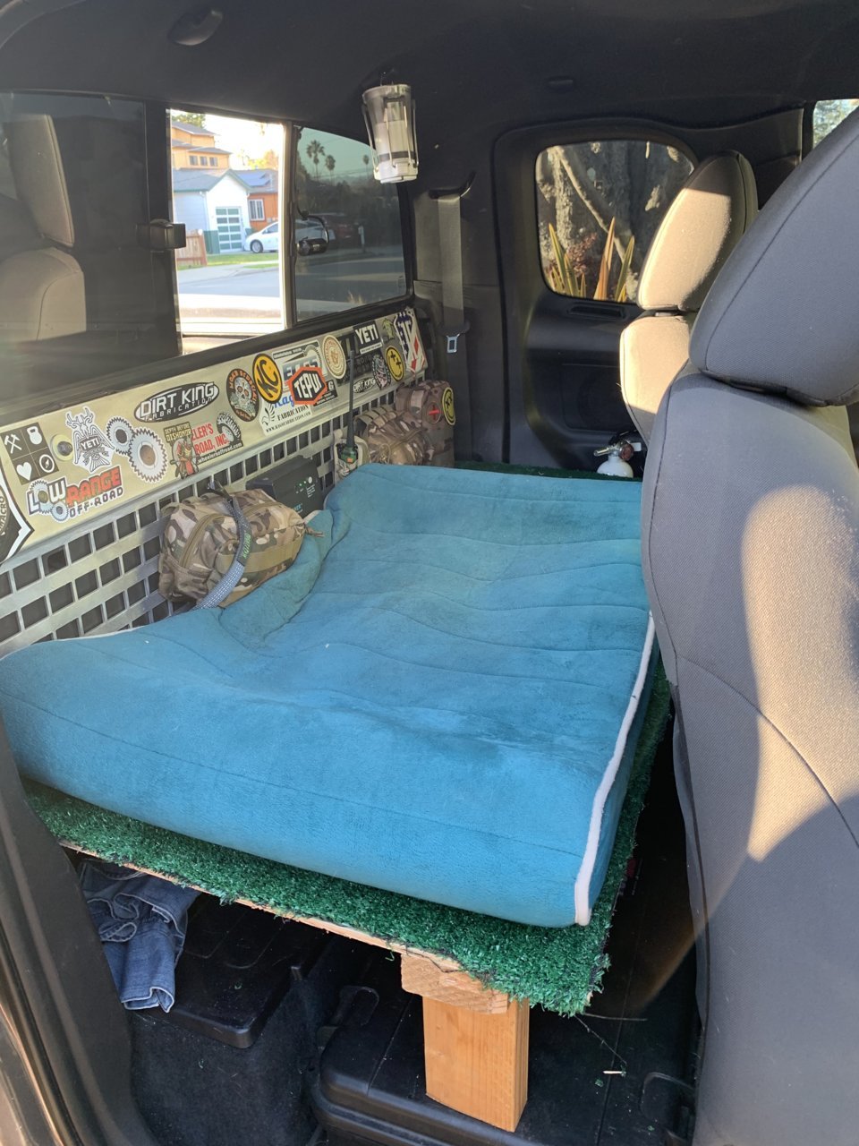

    Mine was pretty cheap. I’m going to redo this but good enough for now.
    Initially I just had the boxes and then the plywood with his bed on it. Then I raised it up for more storage and so he can see out the back window a little better.
    The boxes were really hard to get out so I am going to build some little cubbies for them and mount vertically so they’ll support instead of the 2x4.

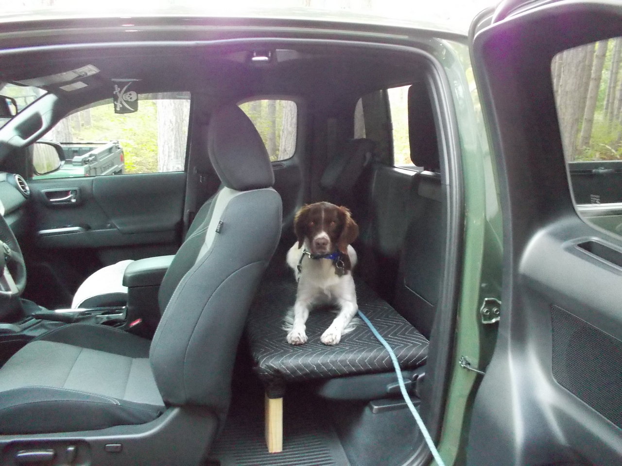

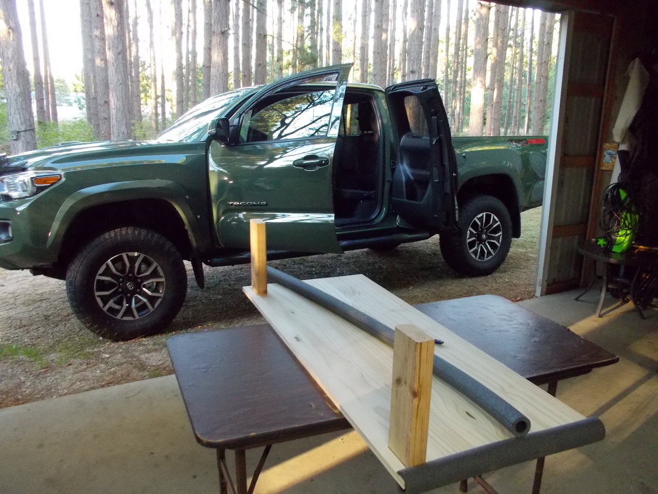

    Following advice from others on the forum I got a pre cut shelf board 3/4 by 20 by 48 inches and cut 2 10.25 inch 2x4's for legs. Used some pipe insulation around the edges and wrapped it in a moving blanket from harbor freight double thick on top for some cushion. I think he approves.

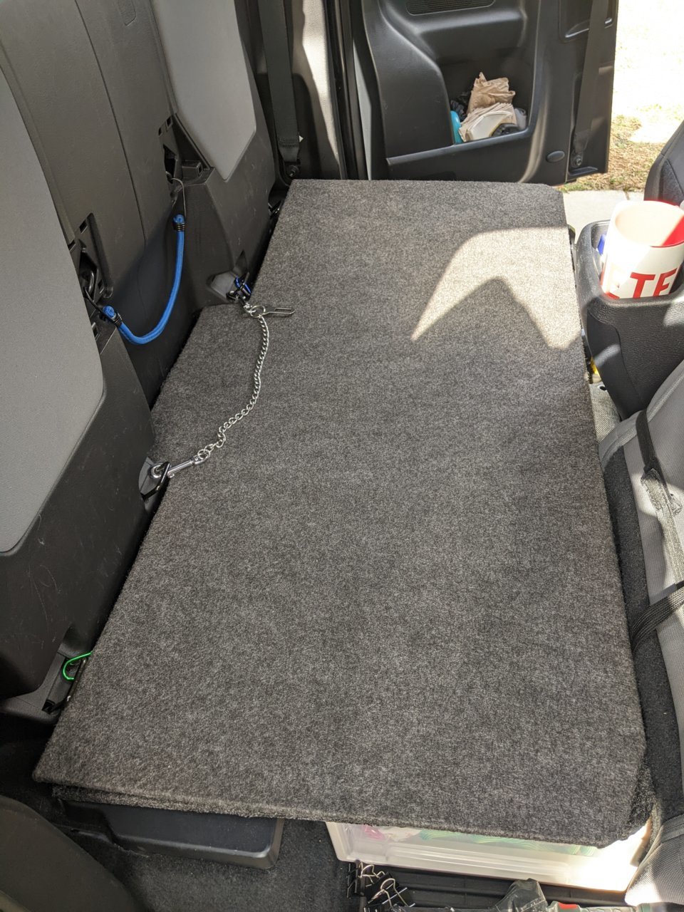

    I started with the DeWalt toolboxes and Foam kneepad that is popular here, then just today I added a 1/4" sheet of plywood and carpet.
    I use it as a flat platform and add a dog hammock when my lil buddy rides with me.

    Just the standard one from Amazon that hooks up to the rear of the front seats and is supposed to clip to the front of the "back seats" but I just clip it to where the headrests used to be in the access cab.

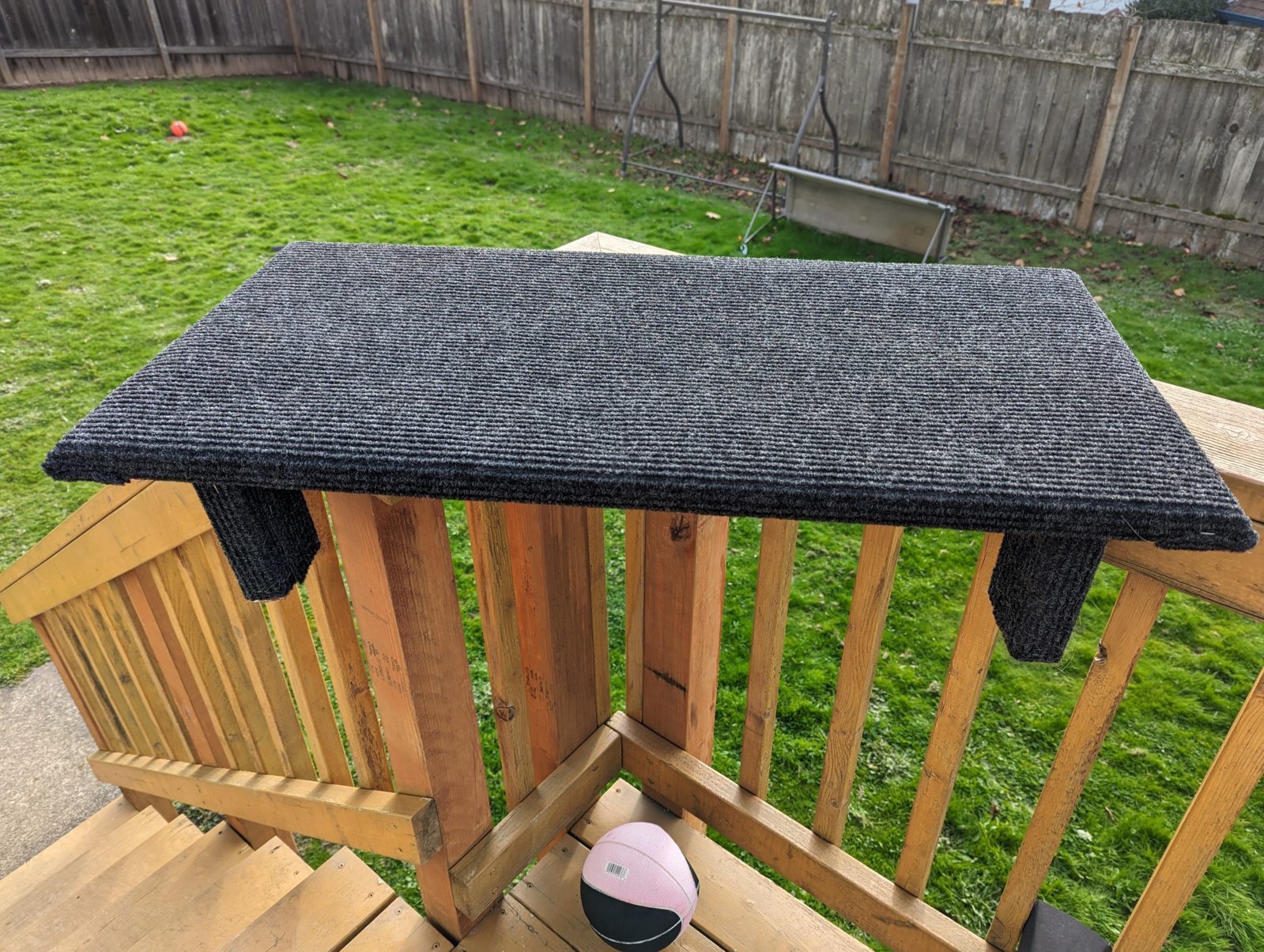

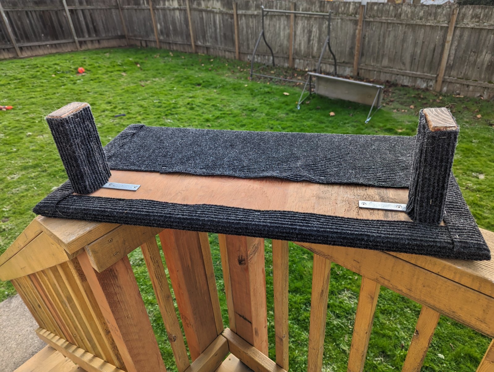

    After 8 years of use, I re-carpeted my dog platform this month. Took a couple of pictures since I had it out. The platform sits on the access cab storage cubbies with the rear seats folded up
