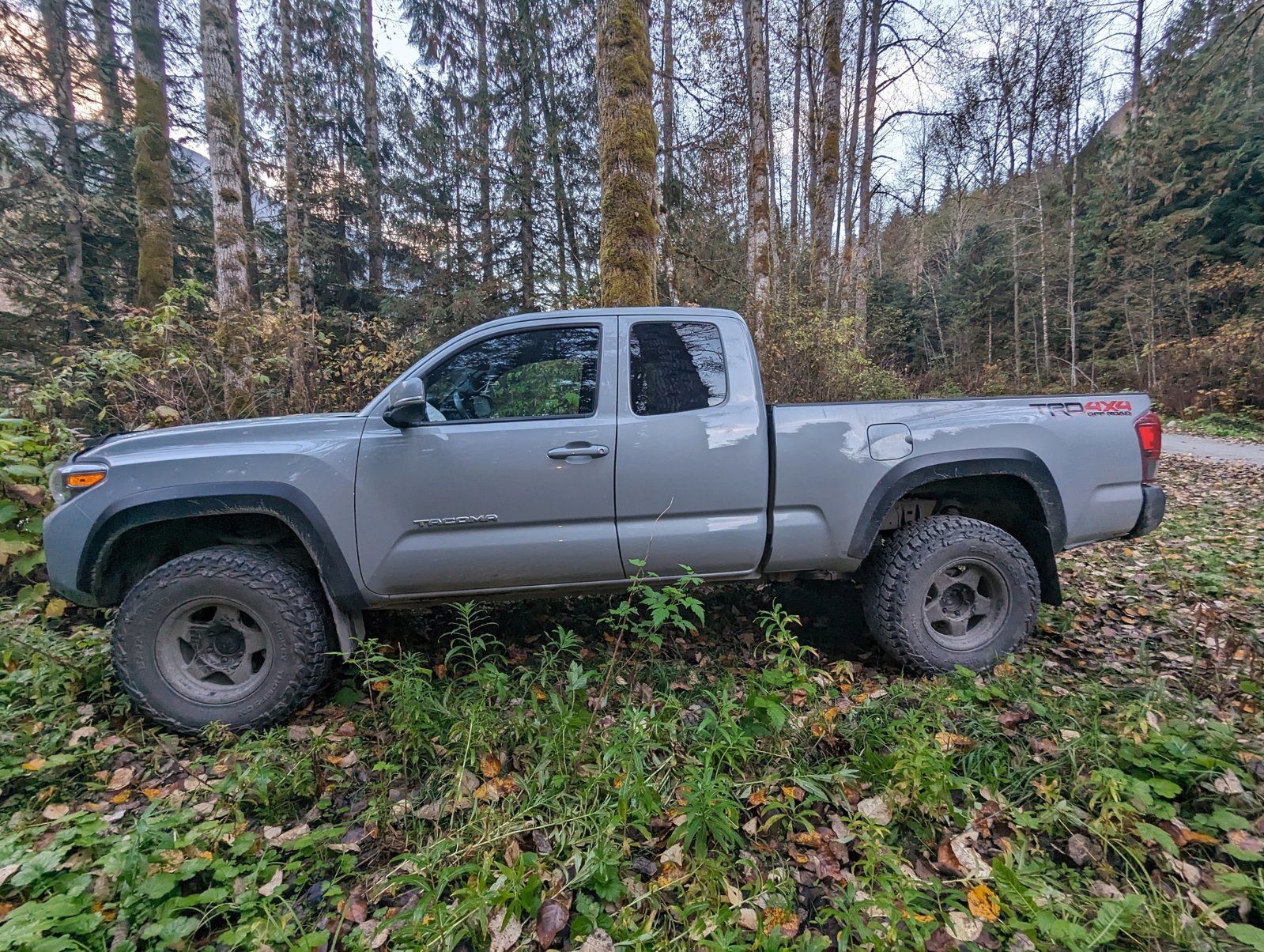

    I have 885s, 5100s, Icon RTX pack on my access cab. Rides great, not harsh at all. Truck as slight rake.

    Stock UCAs. Haven't had any issues.

    as ive said in other threads. uca is not "REQUIRED" even up to 3" lift. just wont have desired castor. why is stock coil on top clip not an option? 2884 would probably be an even better option that 2885 for 2" lift. same spring rate but 5mm shorter
