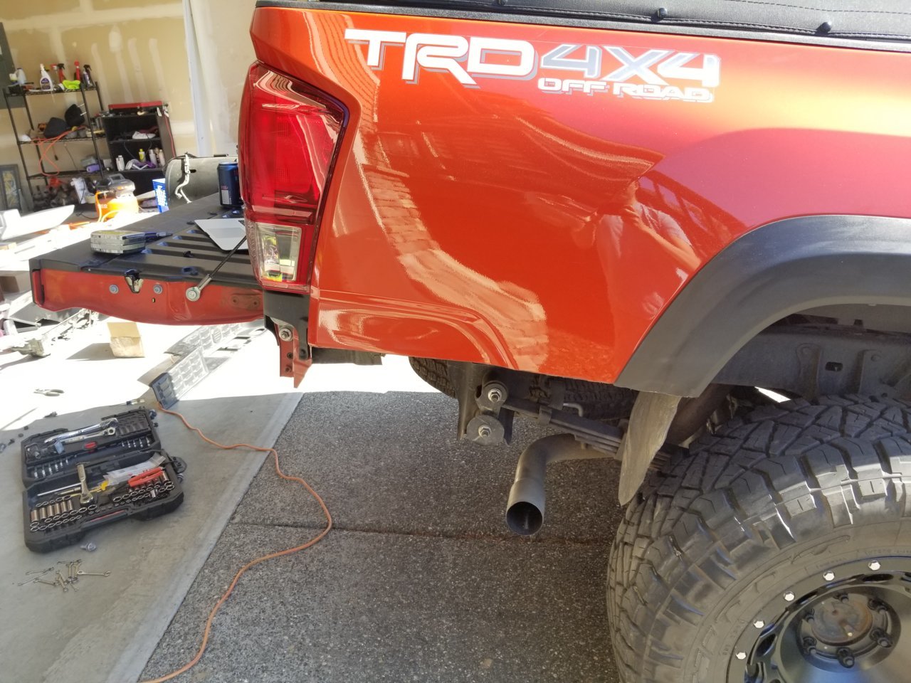

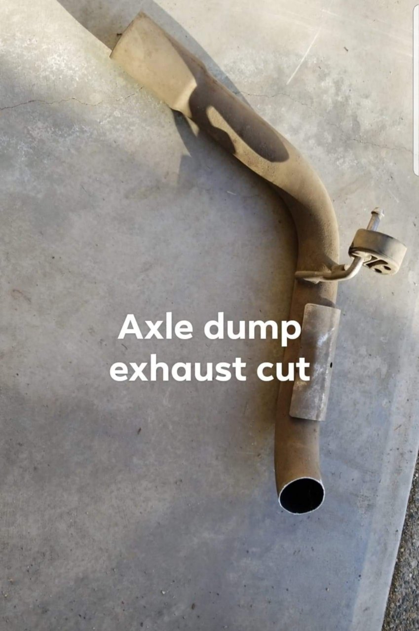

    I have not heard a single aftermarket exhaust yet I that would pay for. Only thing I did is an axle dump cut once I got my high clearance bumper.
