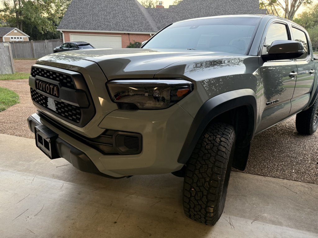

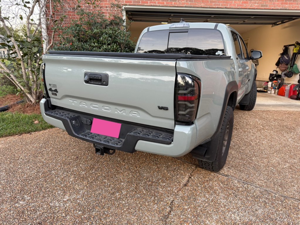

    not sure why I didn’t take a single straight facing photo, but for OP’s consideration, here are alpharex lights.

    Looks good .What model alpharex are these and are they black on black or just black? I’m trying to decide on a pair for my truck.

    Headlights*?
