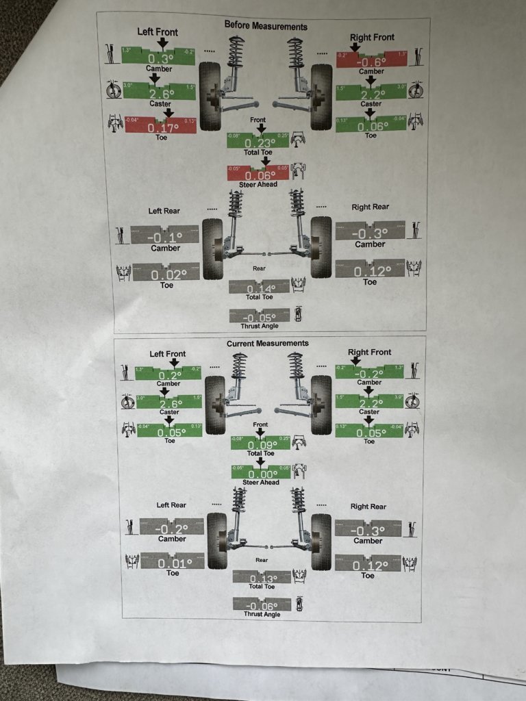

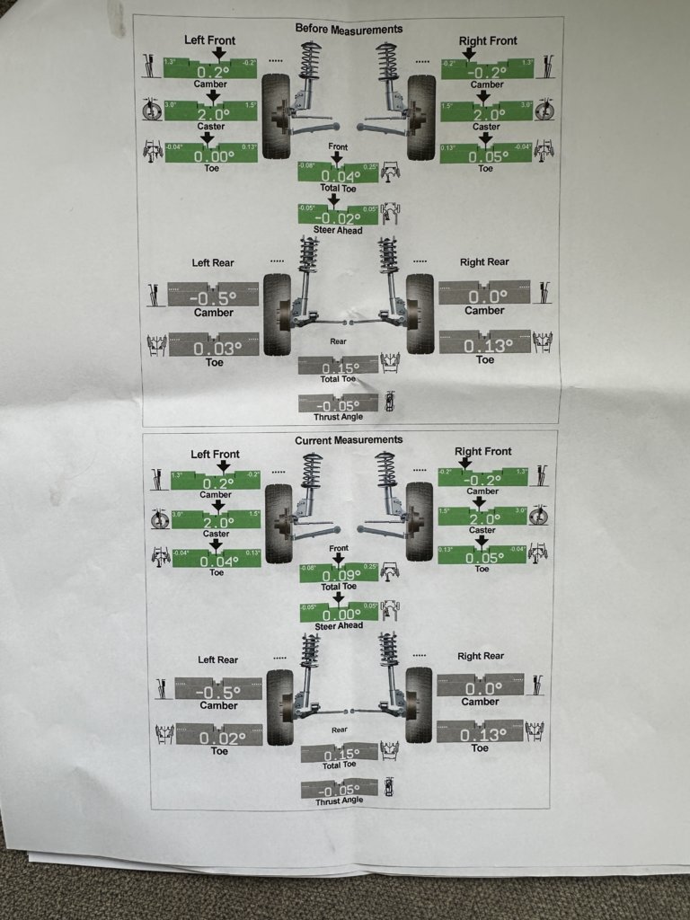

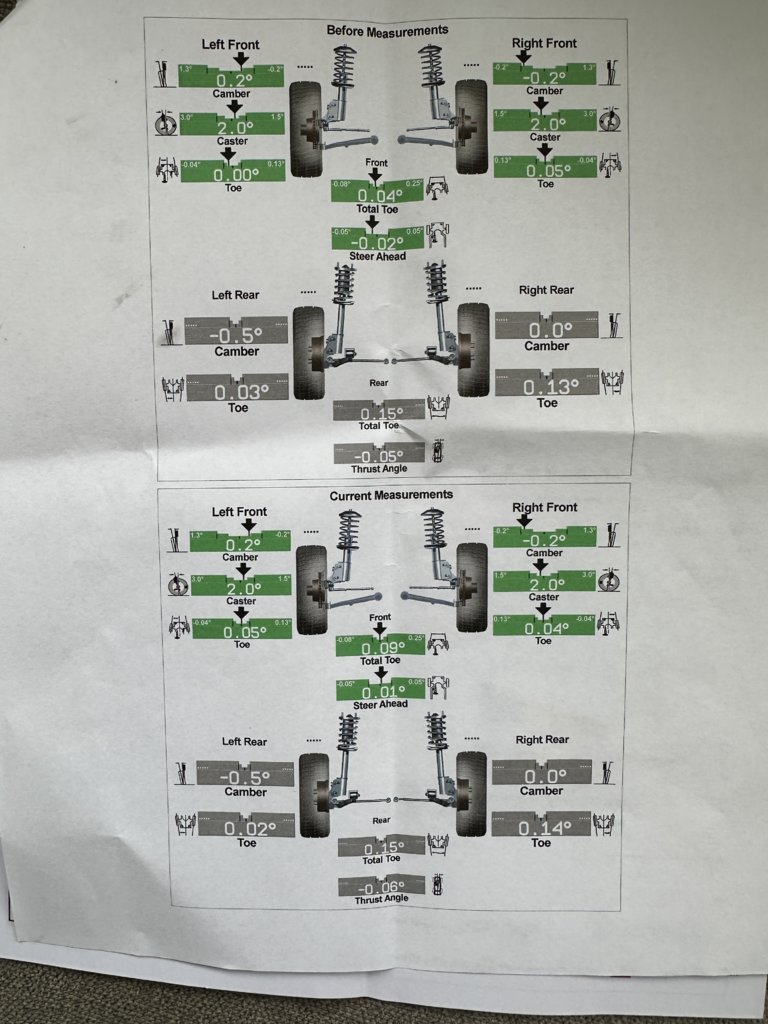

    Hey guys, I’m having an alignment issue on my 2021 Tacoma, where it’s constantly pulling to the left even in the slow lane where it pulls past the crown of the road. I brought it to the dealer four times and it’s still pulling to the left even after they aligned it. They checked under the truck and they said that nothing‘s bent. They’re trying to say it’s my tires which are brand new so I highly doubt that. There also is a slight vibration starting around 60 miles an hour. I’m wondering if anyone else has had a similar problem?

    Why don't you start by posting the most recent alignment sheet that they should have printed out for you.

    Check your tire pressures and post up your alignment sheets from the last 4 alignments.

    I can’t find the second alignment sheet, but the first one that seems to be unaligned is the first time I went there and then the other two are the last two times I went. as for tires, they’ve been rotated swapped all over and it’s still pulls no matter what!
