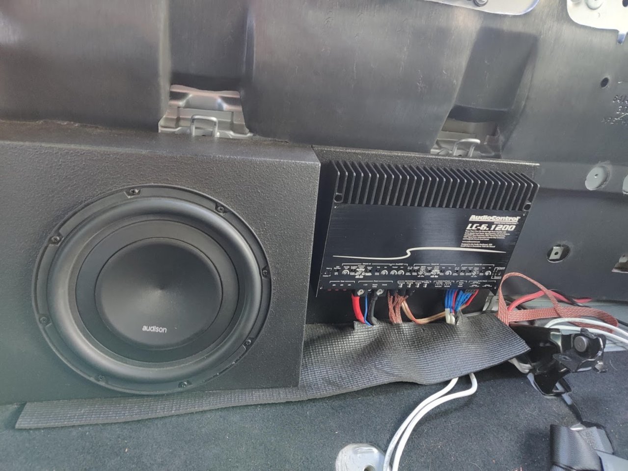

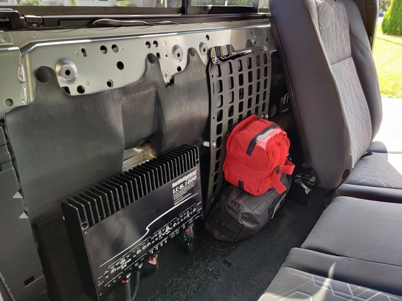

    Taking the opportunity to reconfigure behind the seats, as well as order a new box from Mr. Marv, with a 12" sub, I went to work moving the amp rack over to behind the passenger rear seat:

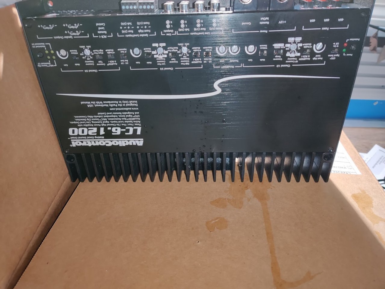

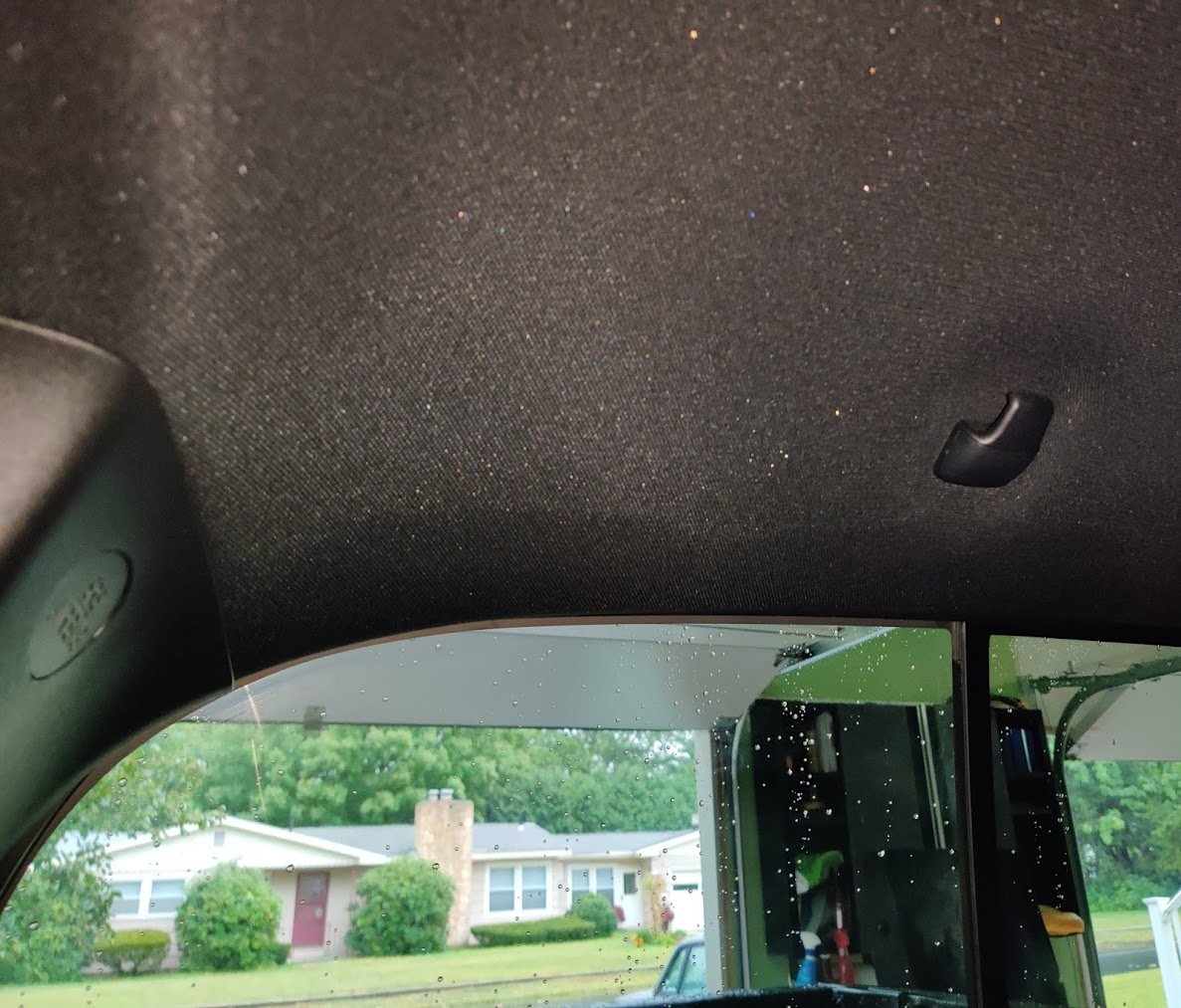

    And then we had rain. Heavy ass rain. My truck had all the windows closed, and I discovered this:
    I had left the truck outside because the wife and I were watching the rain from the garage - it had been a while - NH was in a drought. So I pulled it in and removed the amp right away. Called AudioControl - and Josh (we're on a first name basis now) told me as long as it did not power up while wet, to just let it dry out for a few days.
    I had the third brake light repaired (out of pocket because my roof had been vinyled by a third party vendor) - then reinstalled the amp, and it powered right up (after three days drying in front of a fan)
