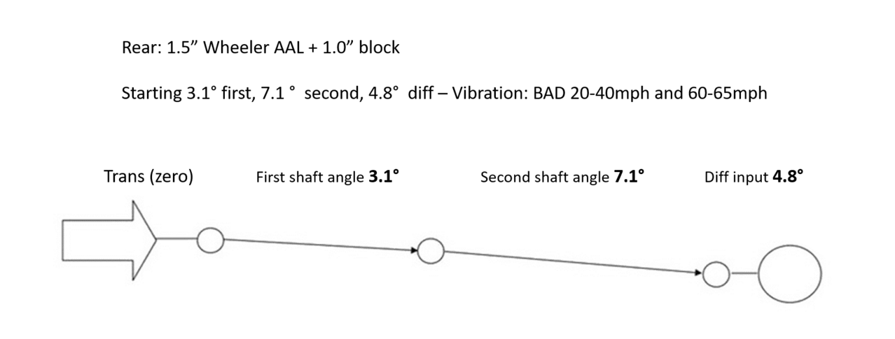

    Using great guidance from this site, I measured my driveshaft angles, here:
    I ordered Toytec 2.5 deg. shims which will get the pinion angle to ~ 2.3 degrees which is around stock. Then I'll play with the carrier bearing if needed.
    I COULD NOT BELIEVE, no how, no way, that the driveshaft angles were causing steering wheel shimmy/vibration. SO, imagine my surprise, when I'm going 65MPH on the freeway and the steering wheel is shaking badly, and I drop to 4th gear and the steering wheel vibes GO AWAY. Basically, by dropping a few gears, I changed the driveshaft speed which changed the load/frequency and the steering wheel smoothed out.
    I still can't piece it together in my head. As far as I can tell, the driveshaft vibes must be traveling up to the motor mounts or chassis and causing some inbalance of energy transfer side to side which is being picked up in the steering.
    I will update this after the shims are installed. In the meantime, people may say you're crazy for thinking a rear driveshaft can cause steering wheel vibes and they'll tell you its the tires like I was told 50 times. If you're lifted, especially over 2", do the math and get your driveshaft angles right.
