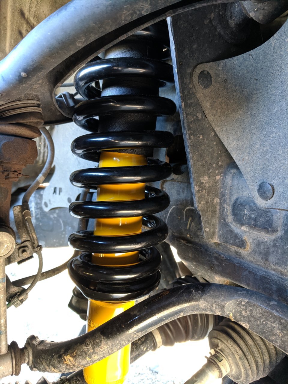

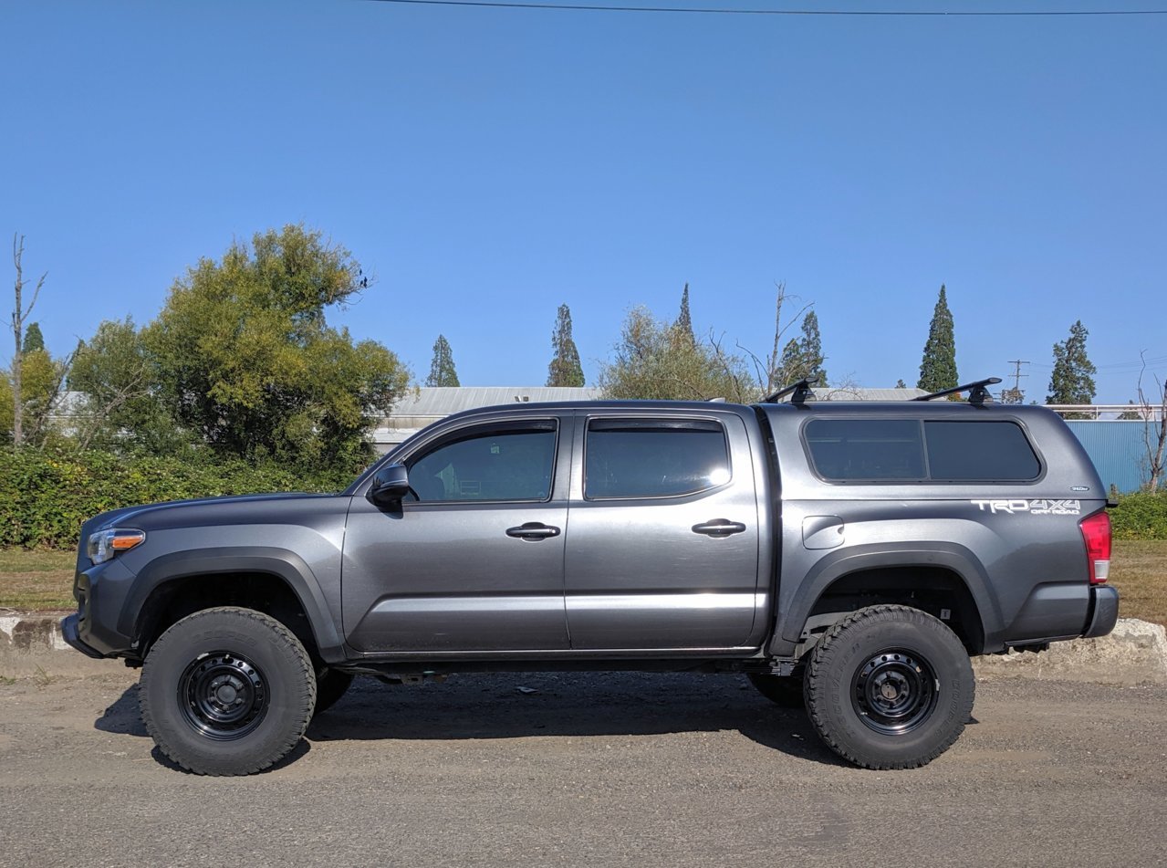

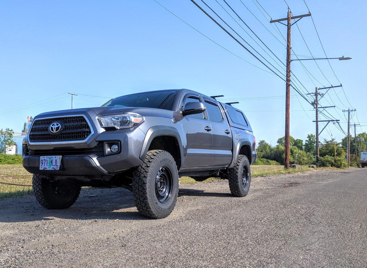

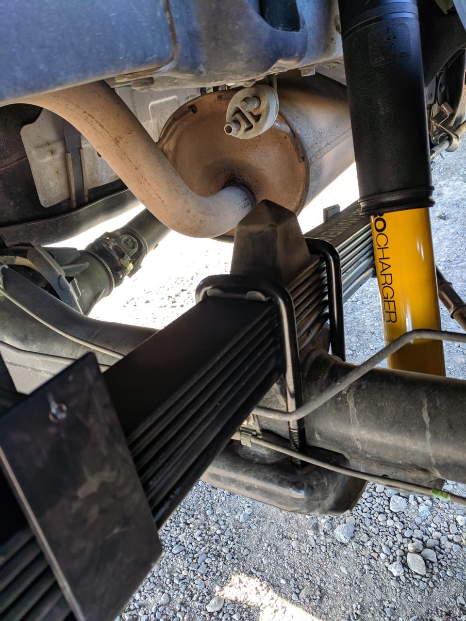

    I did the OME HD with the Dakars in the rear. My tires are Cooper 255/85 R16.
    I'm very happy with the setup, the stiff suspension has allowed me to the wood de woops pretty fast. Now I'm thinking about taking off the sway bar since I have a firmer ride.

    9000 struts and 886x coils if I remember correctly. I wanted a firm setup because I plan on doing bumpers and armor in the future.
