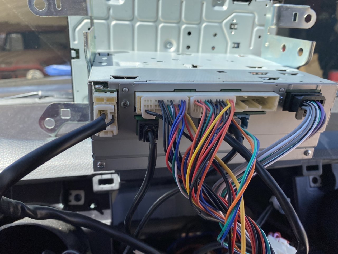

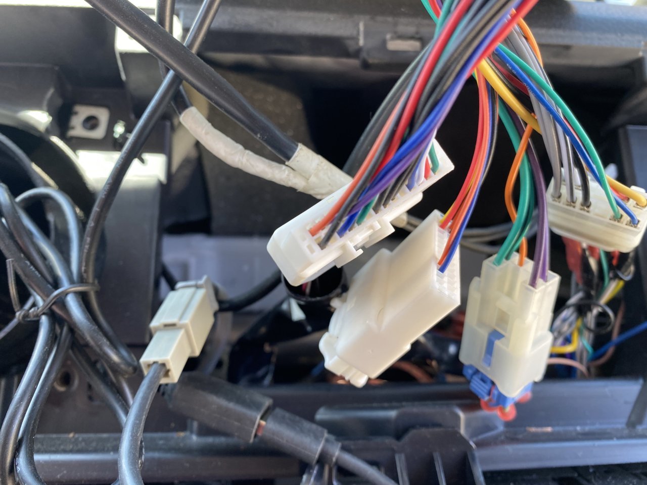

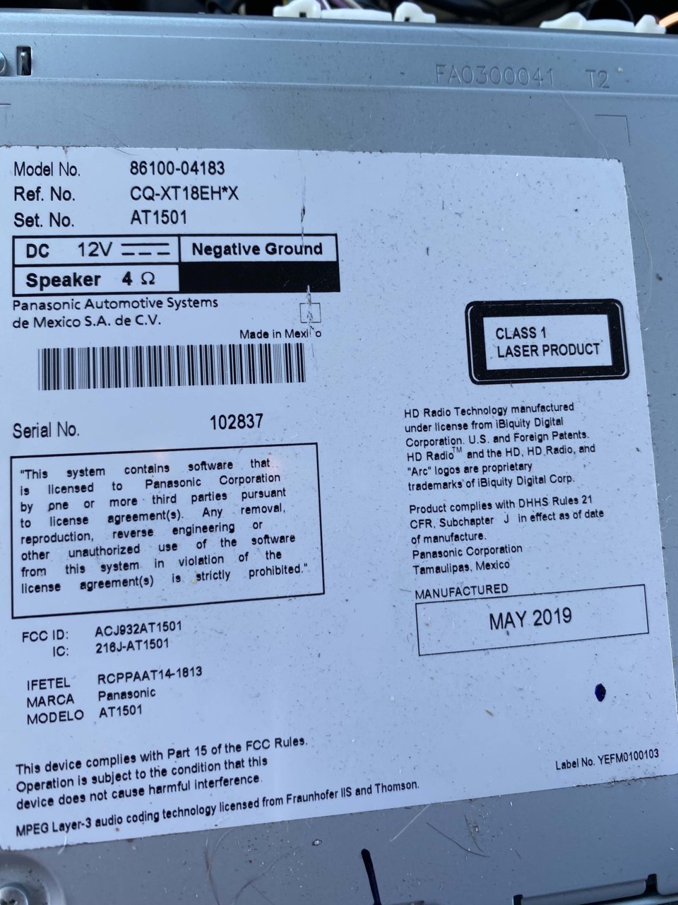

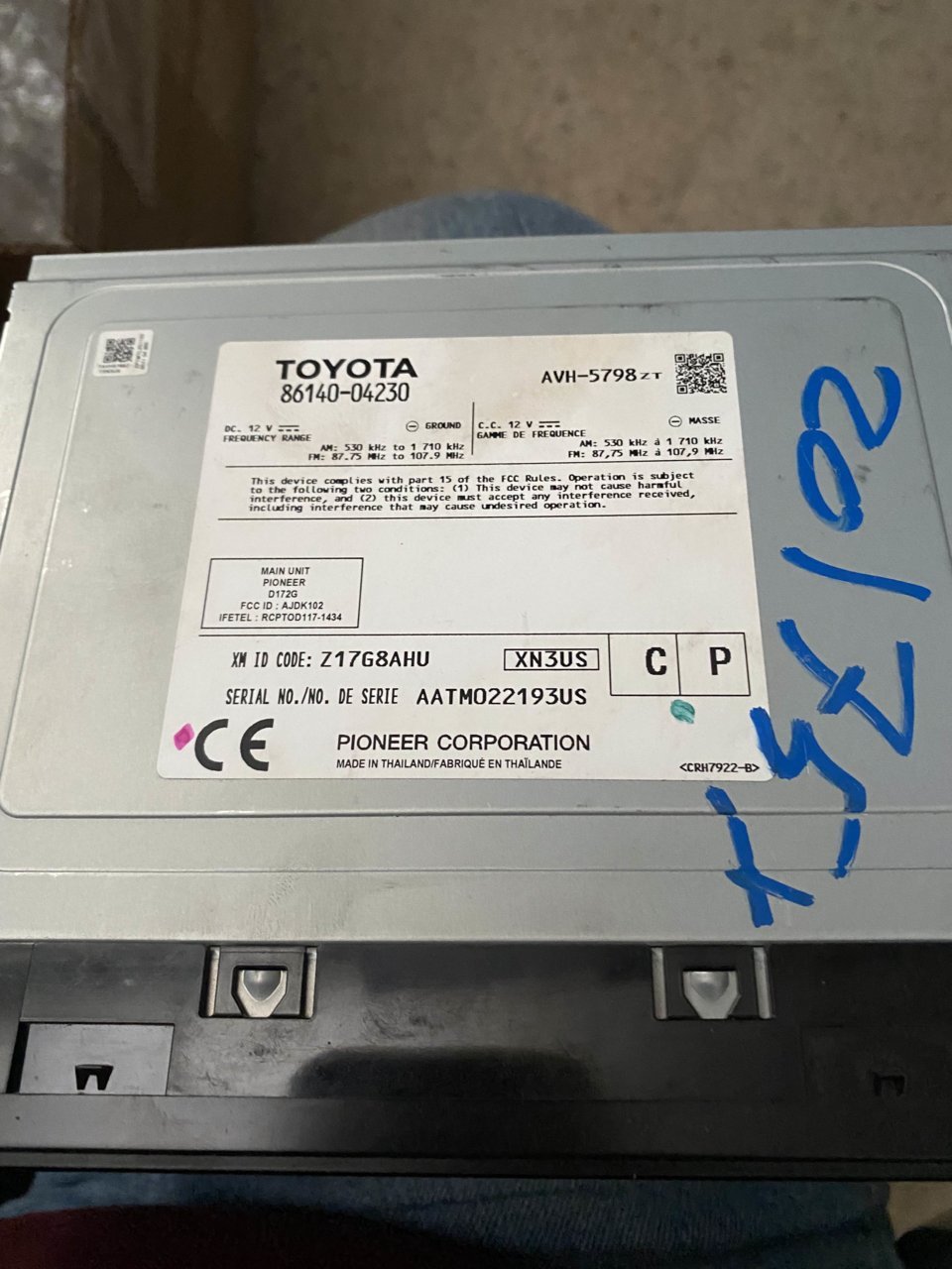

    Promised to report out from my efforts.
    First effort was a bust.
    Custom harness from autoharnesshouse.com appears to have connected the way it should. Looks like it can only connect to existing harness.
    But the new unit, salvaged from 2021 Tacoma, from Benzeen Auto Parts, in Rancho Cordova CA, which appears new, would not power up. Picts below. Anything from the groups collective experience would be helpful/appreciated. btw found them by way of car-parts.com
    Updating a couple of hours later - got email back from Brian at autoharnesshouse.com with the solution. Moved the 28pin connector to other side next to black connector. Works great. Many thanks to Brian at AHH, and to others with comments and suggestions. And to IMXPLNR who posted the original solution - scroll up!
