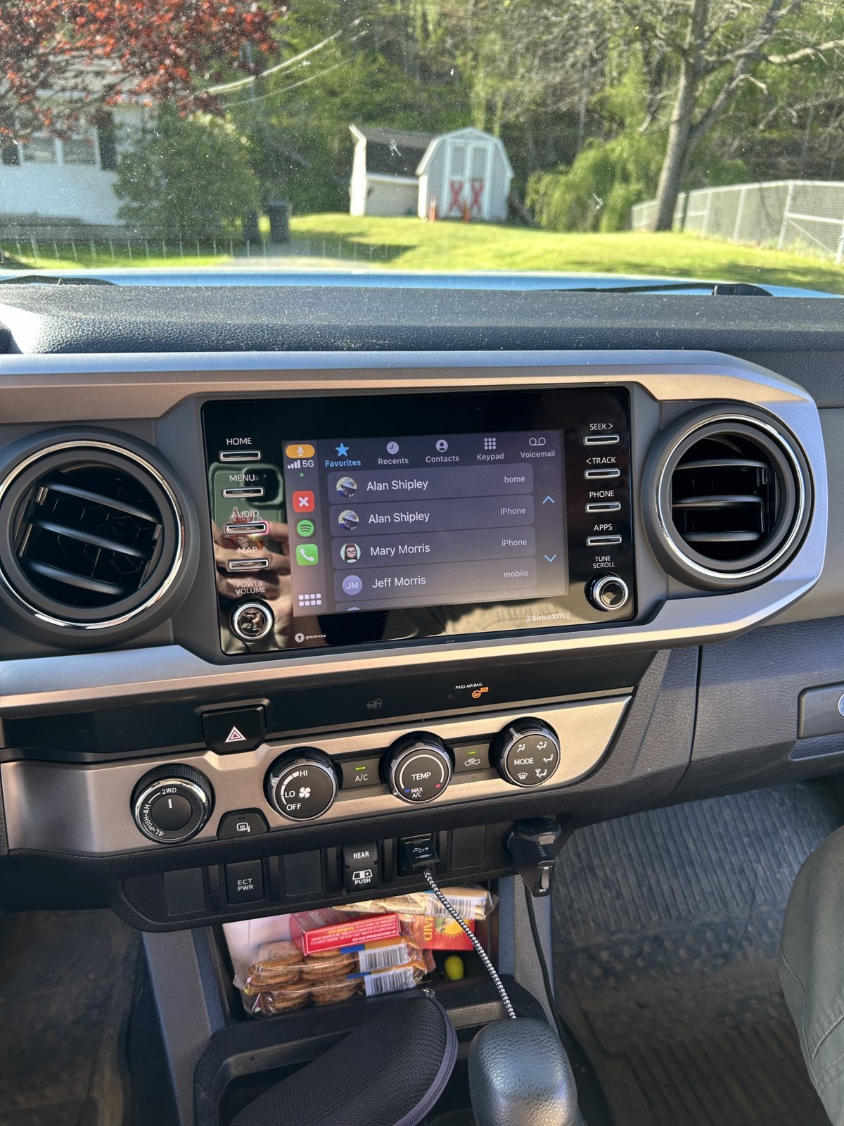

    I have a 2019 Sport, and the bezel seemed to fit over the newer headunit. I just ordered the harness myself. I will physically check to see if the unit fits again.
    EDIT: double checked and it fits perfectly in the bezel.

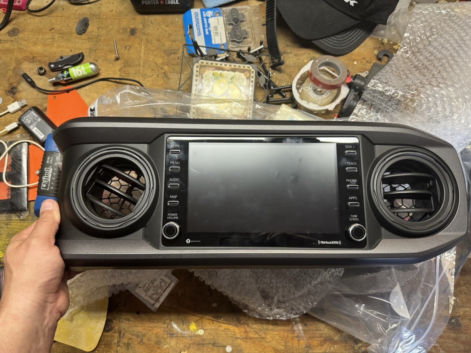

    I ran into the same thing last week… didn’t know it wouldn’t fit but the screen is an inch bigger. I decided to bite the bullet and just buy a new one. Bought it from a Toyota dealership in Richmond VA. This is the part # you need: 55405-04130-C5 unfortunately it’s a couple hundred bucks but I couldn’t find it on ebay. Hope that helps!

    I tried, and the bezel covers up the knobs. The radio I had installed prior was the basic Entune 2.0. :(

    The shipping is crazy! Thanks for the part number. I may decide to do that…I’m contemplating a few of the bezels on eBay. I could swap the trim out with the bezel I have so it matched color-wise.

    Thanks all. I was able to order a bezel online from Nucor Toyota of North Attleboro. Part # 55405-04130-C5
