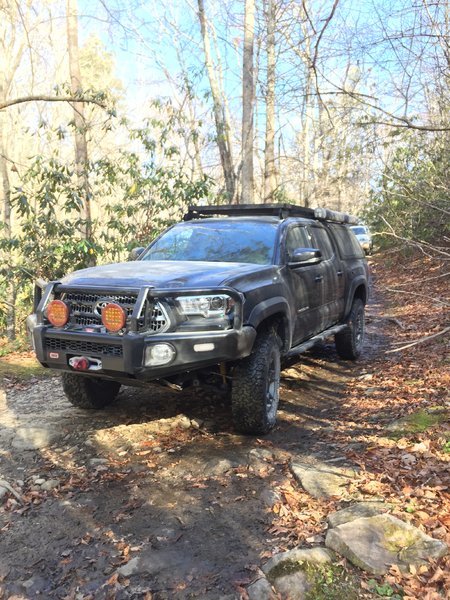

    I'm running it. Pictures on here and on Instagram @overland_nc

    Did that bumper increase/decrease/neither your approach angle? I LOVE that bumper but it just looks like it sticks so far out in front that it would decrease it. Always been a fan of the ARBs!

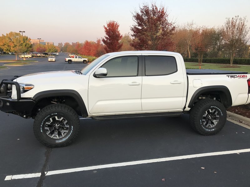

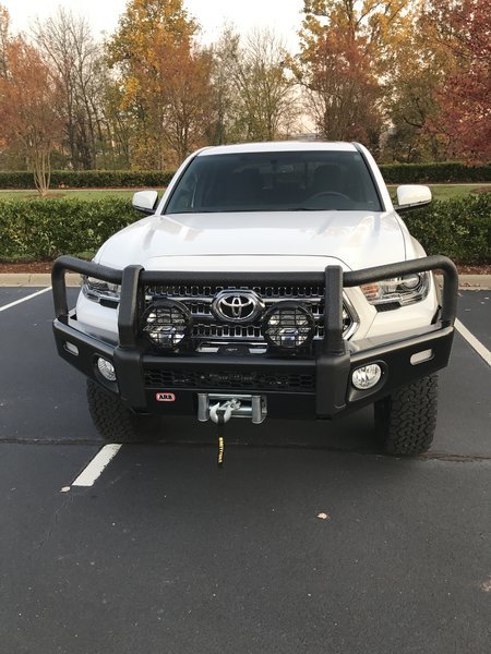

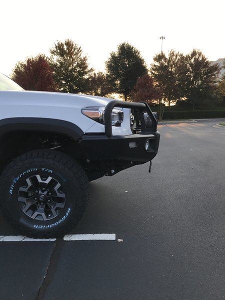

    I did end up doing the suspension prior to installing the bumper. I went with OME BP-51's and Camburg UCA's. With the added weight from the winch you can see that the front end is slightly below level with the rear. That is with the coilovers being set for 300lbs of additional front end weight.

    Looks great!! How do you like the OME setup? It looks awesome but DAMN is it expensive - lol!

    Looks awesome! Man do i want this setup, i just dont trust myself to install nor do I just any local shop to cut my truck...

    I was in the same boat. I know Midstate Toyota does a lot of these installs but they are pretty far from you.
    In the end I decided to just give it a shot and to be honest there were a few (sh*t I should have done that step first) moments but all in all it is pretty easy as long as you allow yourself enough time to correct mistakes and take your time.
    I'd be happy to answer any install questions you may have when it comes time for you to install.
    On the BP-51's, I really like how it drives and how it performs off road (not much time off-road) but I am a bit disappointed in the adjustability. The rear is easily adjusted but the front is not so. The supplied wrench does not like to fit between the coil itself to reach the adjustment perches. Seems if I want to really adjust it I will have to disconnect the UCA if I need to adjust both the rebound and compression.
