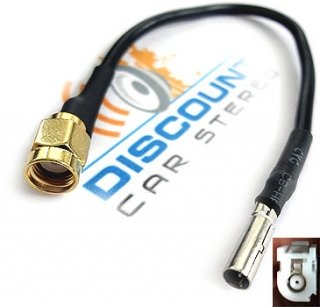

    It appears the black one is the XM Radio Antenna. The white one is the GPS antenna. I took the white case/plug off which left just the round metal connector on the inside. I had ordered this off Amazon thinking it would plug into the white connector (it doesn't): https://www.amazon.com/gp/product/B07MCL8R3G/ref=ppx_yo_dt_b_asin_title_o01_s00?ie=UTF8&psc=1
    So cut the blue end off, stripped the wire while keeping as much as the protective/ground layer as possible, then pushing the inner wire into the white female end and made sure the protective/ground mesh wire rested on the metal of the Tacoma plug. Is that confusing enough? Anyway, I have GPS signal without needing to use the puck included in the Joying package. I'm still looking for a more elegant/plug and play solution, but this works.

    Thanks - someone posted on Amazon for that same kit that it does not work on a 2018 Tacoma. I did find an adapter that is referenced in the Alpine Halo9 head unit, but haven't found a part # yet. If/when I do and the price is reasonable, I may order it up and see what's what.

    Weird. Maybe the '18s are different, but those antenna adapters worked for my aftermarket headunit. I'm using the OEM sharkfin for GPS and satellite radio.
    Edit: on Crutchfield a dude says it works fine on 2018 Tacoma. Iunno.

    It’s weird because one person states it did not work for their 2018 Tacoma and another person says it worked perfectly on their 2017 Tacoma. The picture listed on both Amazon and Crutchfield appears to have the matching end. I think I may grab this so I don’t have what seems like 20ft of gps cable stacked behind my dash for the plug in puck antenna that came with the unit.

    I'm going to order it with this: https://www.amazon.com/gp/product/B071FGB6Y9/ref=ox_sc_act_title_1?smid=A8GRJU0V6WTPX&psc=1 so it'll screw into the back of the Joying unit. Will report back in a couple days.

    It for sure worked on my truck. So that's something I guess. You can always send it back to Amazon if for some reason it doesn't work.

    I ordered it. Fingers crossed it fits. Now I get to feel like my wife and stalk the UPS and Amazon drivers until it gets here on the 2nd.
