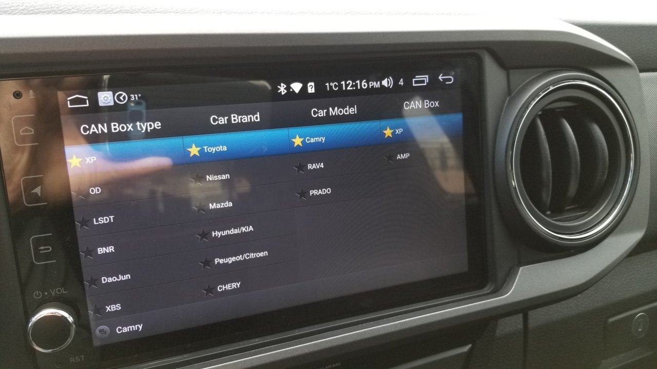

    Installed and I am not getting the steering wheel controls working. There is an app on the stereo to program it and at the bottom it states something along the lines of press the program mode button on the steering wheel.
    Is there is program mode button on the steering wheel?

    mine had two connectors for the SWC that that I may have switched one to the other to trouble shoot my buttons not responding

    Go into settings, car info, then select toyota, 2013, then pick the generic toyota model and it should work.

    I figured it out. I had disconnected the canbus in and out by accident thinking they shouldnt be together prior to my install. All good now.

    I used the mic and gps that came with. I also did a firmware update after reaching out to Joying and they helped me set up the Canbus to my steering wheel.
