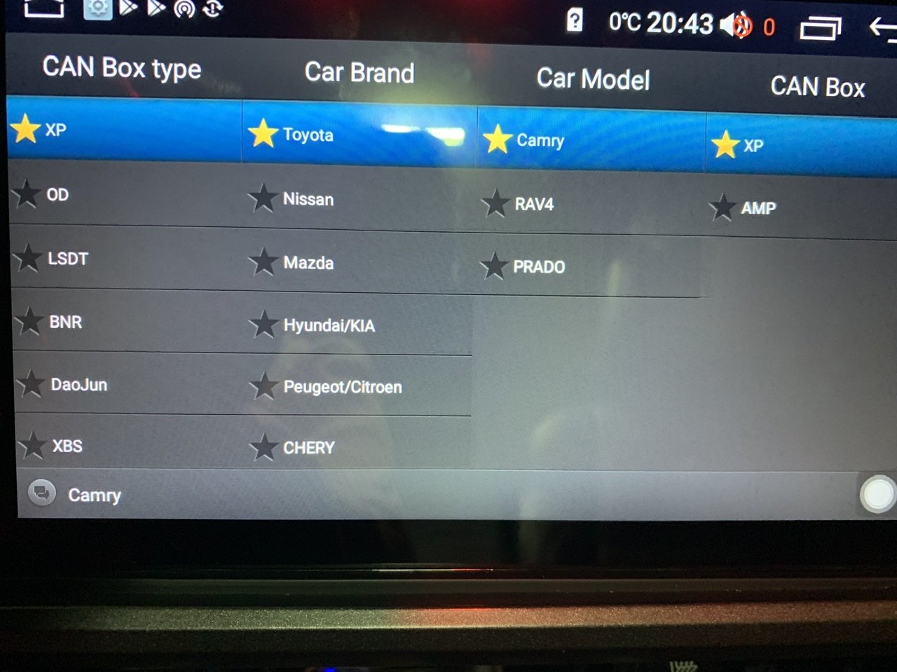

    Some teething problems thus far, they could be not solvable or they could be.
    • Volume control works, but up and down (forward and back) do not. Cannot learn buttons dues to canbus.
    • Hard to switch between CarPlay and getting data to unit via tethering. Wants to keep switching back to zlink app and not stick. Can't do CarPlay and tether data at same time.
    • I at some point was able to switch what the home button went into a launcher, but now cannot. I'll keep messing around with it.
    • When you open and close doors, it shows on the head unit. But the rear doors are reversed. Can't find a setting on that.
    • Did anyone select a different can in the menus? Apparently it gives you a different car selection, but I don't know which one is correct for the truck.
    I'll have more to say on it in a couple days, but if anyone is familiar with any of this please let me know.
  10. Jan 22, 2020 at 5:23 PM
    #410
    5nahalf
    5nahalf [OP] I build dumb things
    Sep 22, 2018
    #267058
    10,934
    Erik
    Minnesota
    2018 Inferno Longbed
    I think I used 2013, toyota, then the generic model, but I think rav4 works also.
    As for the doors thing, you can shut that off in the settings. You can also tell the home button what to do in the settings.
  11. Jan 22, 2020 at 6:00 PM
    #411
    raykru
    raykru Well-Known Member
    Oct 28, 2017
    #234370
    61
    CLE
    2017 Cement TRD Pro
    Mine worked right out the gate. See picture. One thing I can’t figure out is the volume is crazy. I don’t go over 6 it’s super loud. For the rear door reversal turn off the rear door exchange in factory settings and go to original car agreement. Panel key learning is what you may have used for the home

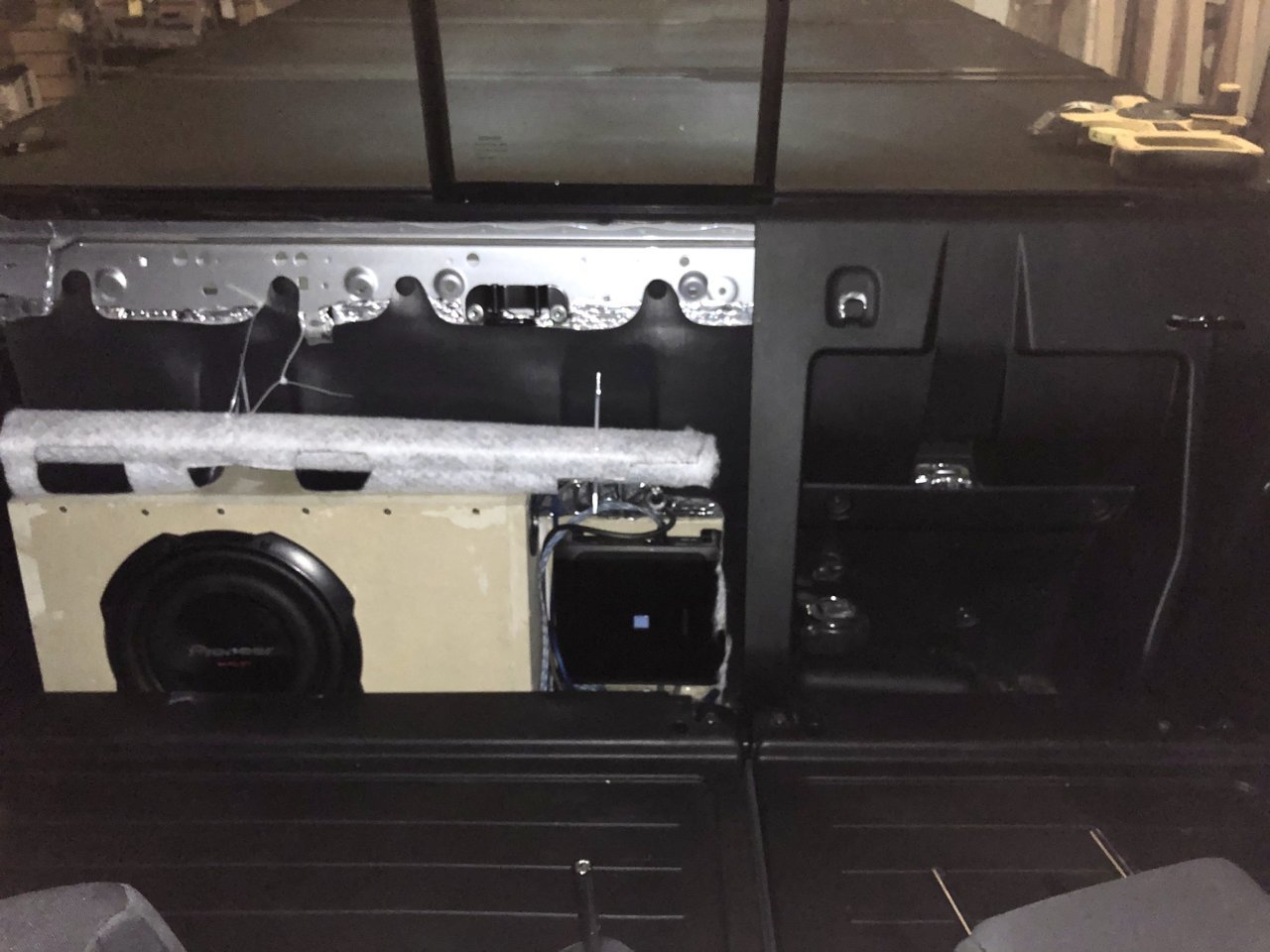

  17. Jan 23, 2020 at 11:41 AM
    #417
    cruxx
    cruxx Well-Known Member
    Apr 20, 2017
    #216831
    1,199
    Huy
    2017 TRD Sport
    Was able to fit a 10” amp and keep the driver26F4027A-9F33-4D32-B319-E719CC4D0488.jpg side storage bin
