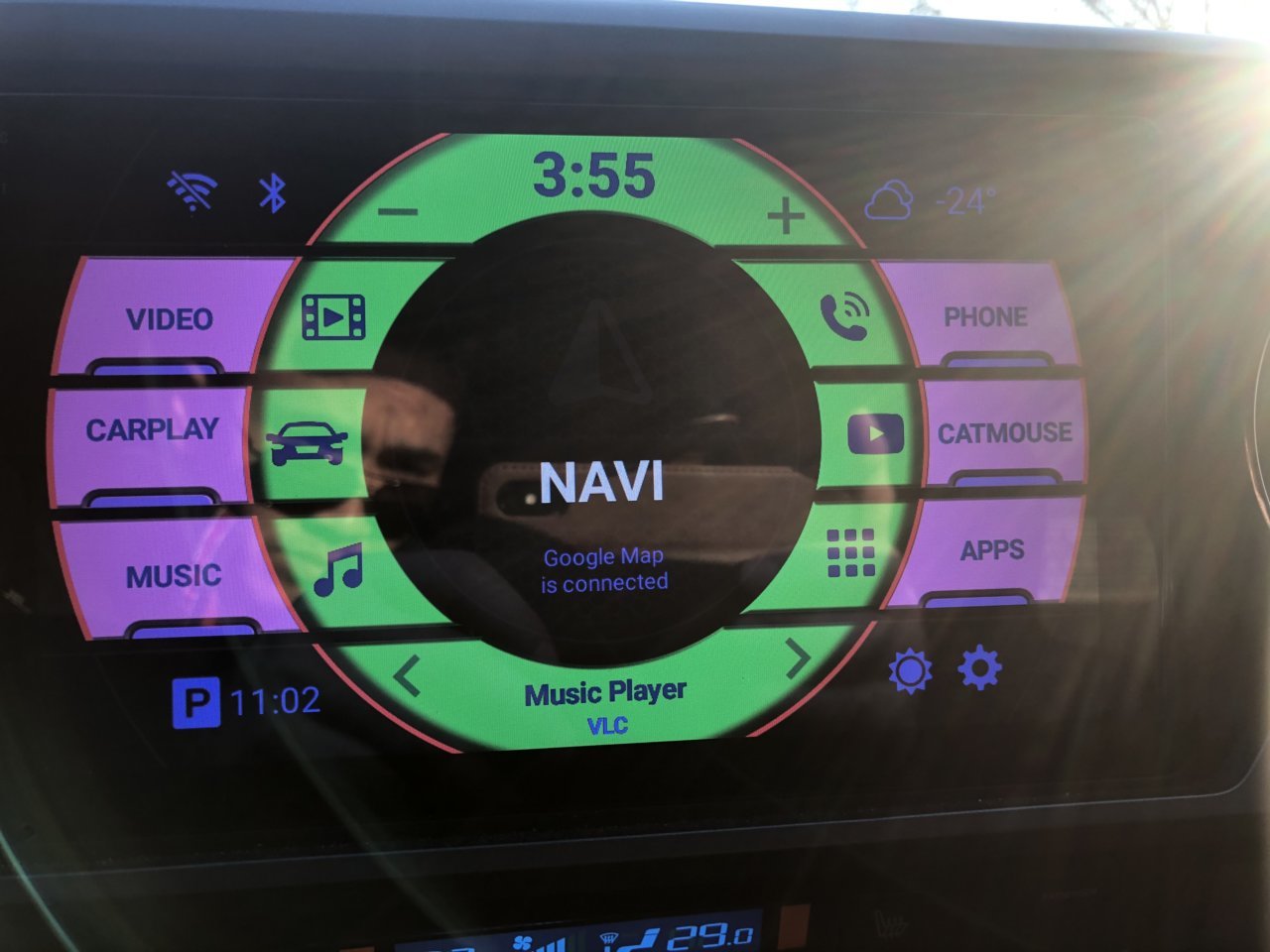

    I got it so i have one button to press for carplay to start. Your home wifi may interfere with its finction, so best get it started away from home wifi.
    As for music memory, the only one that remembers and autoplays is the native video player, so now i play music videos instead of mp3s. There is memory in other apps such as poweramp, but no autoplay
    Which app are you using for carplay?
    Check out agama car launcher. Its a convenient way to setup all your buttons to your liking. As you can see i start my carplay with that one button. I have music video auto start with the video button and my mp3s playing through vlc on the music icon, so in reality, i can play 2 different tracks and chamge between them and they will remember where they left off. Volume is that green band so you can circle for up or down. When you drag each button to the middle more apps pop up. all buttons are customizable and the so is the color scheme

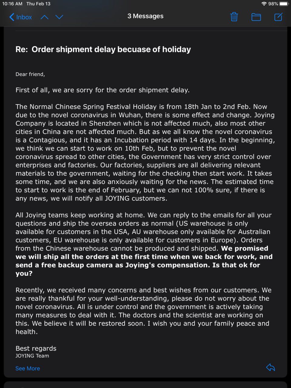

    So I ordered from China on February 5 and got an email stating that they would ship it out February 10 due to being on holiday and today I get another email about a shipment delay this is why I’m always nervous about ordering from China. I guess we’ll see if I get a third email for delay I might just try and cancel the order.D02673C2-46BB-4680-A868-ED36799339C2.jpg

    I mean, they're basically quarantined.

    They will finish the order, they need the money and need to keep a good reputation. The country is crippled right now, just give it time, I have a bunch of things currently sitting in china waiting for the all clear.
