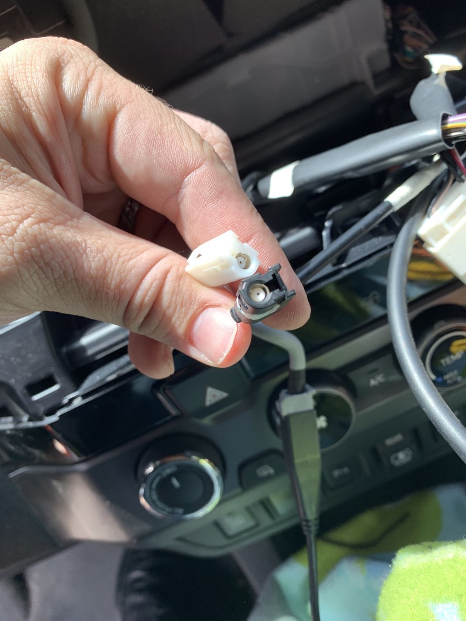

    Is it one of these?
    22C0837C-D861-4E8E-8F2A-118AA3399DD6.jpg 22C0837C-D861-4E8E-8F2A-118AA3399DD6.jpg

    No not those. It's another one. Those you don't use. There is one more back there that plugs into an USB adapter that came with the unit. I don't have mine taken apart right now to show you.

    Sorry if this has been talked about before, but I just ordered a similar stereo the PX6 from car trim home. My question is, doesn't that cable that this connects to also supply the FM radio reception? I believe this is the stock connector that I purchased the adapter for that went from this white OEM connector shown above to the aftermarket FM male connector that plugs into the radio for FM antenna. So is there another adapter that is used for FM radio signal? Thanks and sorry if this is confusing.

    IIRC, there are two identical wires. The one coming from the right is the radio, the one coming from the left of the dash is GPS.

    Awesome! So ill be using the one coming from the left-GPS?. Cool going to definitely refer to this thread when I do my install.

    Am I missing an adapter to plug the white connector to the FM input?
    Anyone have a picture of it, or a link to purchase?
