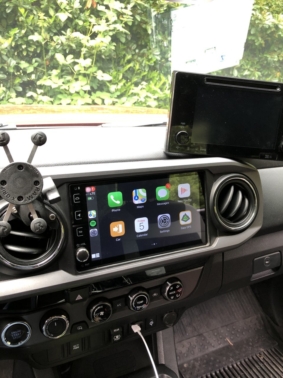

    Install took me 45 mins. I was nervous about the mess of wires, but literally all you have to do is connect ones that match. Others who have posted are right, there are 2 square white connectors that aren’t used. There also are 2 circular connectors that aren’t used.
    I used the Joying GPS, didn’t install 4G antennas, and didn’t install mic (plan to use integrated one).
    Now to figure out all the settings...

    Also I used stock bracket. You can see the lip toward the bottom of the unit, but it's pretty minor and not worth the hassle to me.

    Is there an overlapping circle in the top left corner where the time shows?

    They still have the accessibility button enabled.

    correct, and I later disabled it. Been enjoying the unit so far, still trying to figure out some small annoyances with it but otherwise it's been great!
