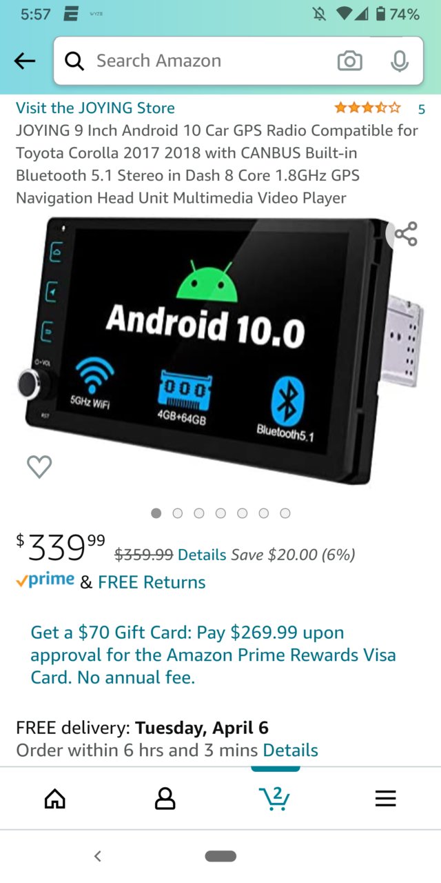

    Welp. I really want to give this a try. I've never tried anything even close to removing a head unit. Is it really as easy as they say?
    I mainly just want android auto. I don't have mobile Hotspot from my phone. What else do I need for installation if I try it? Is this the correct head unit from Amazon? Do I need to buy anything else?

    Yes, its 4 bolts, unplug old, plug in new and put in bolts. There are a few install guides in this thread too. If all else fails, your only about 4-5 hours away from me if you wanted to make a road trip.
    But also make sure you dont have the JBL system, as the joying radio is a little harder with the OEM JBL radio.
    You loose satellite radio with the Joying.
