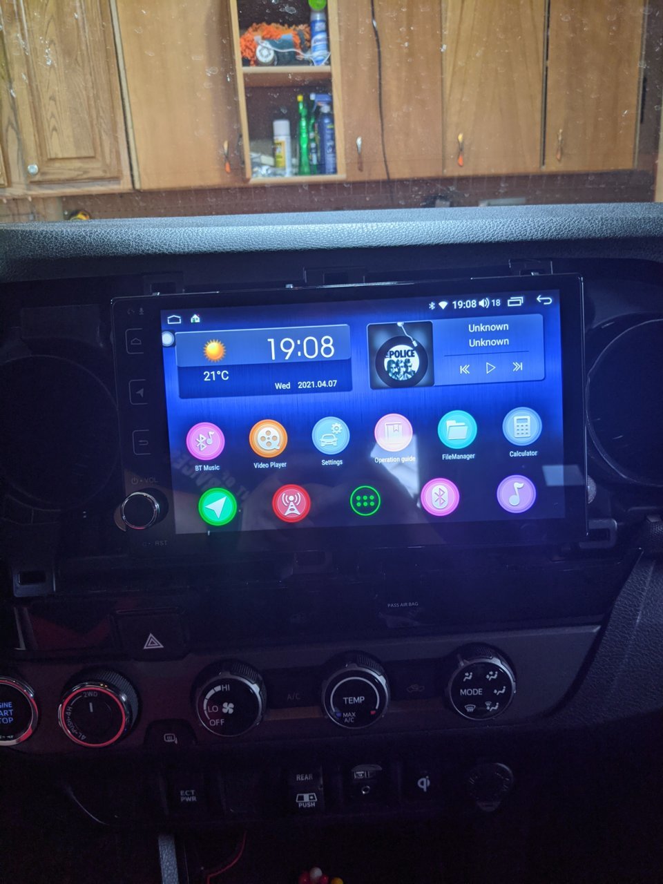

    I'm loving it but takes time to customize to your liking I'm amazed at how much faster it is compared to stock

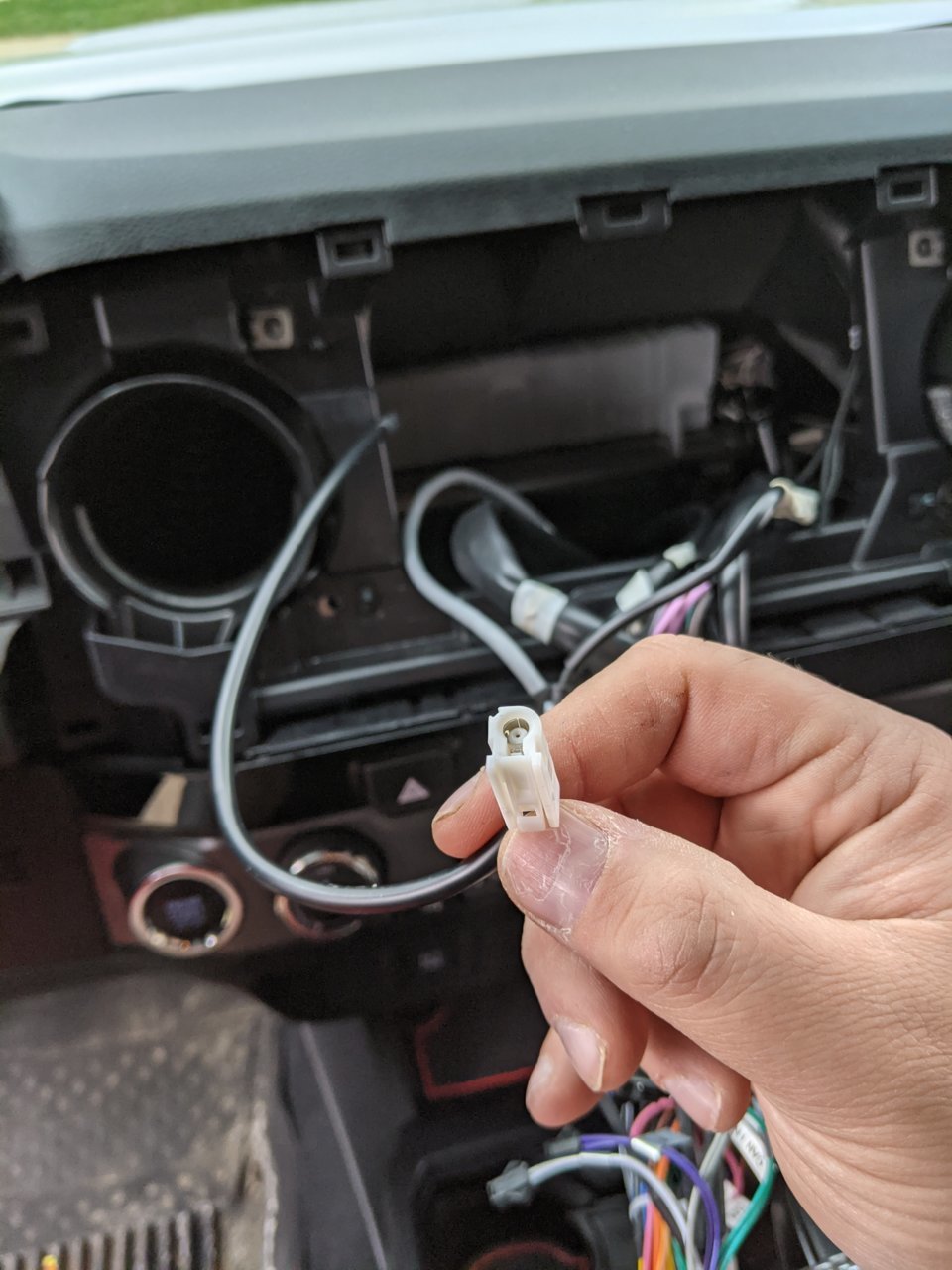

    I cannot get my steering wheel controls working or the USB cord.
    What am I missing here?
  4. Apr 8, 2021 at 7:06 AM
    #764
    5nahalf
    5nahalf [OP] I build dumb things
    Sep 22, 2018
    #267058
    10,959
    Erik
    Minnesota
    2018 Inferno Longbed
    Go into "car settings" and select your car. Sometimes the car is not selected so it doesnt read steering wheel controls. There may not be a tacoma option in there, I used 2013 rav4 as my car setting and it all works
    As for the USB, make sure its all plugged in right. Otherwise it should just work.

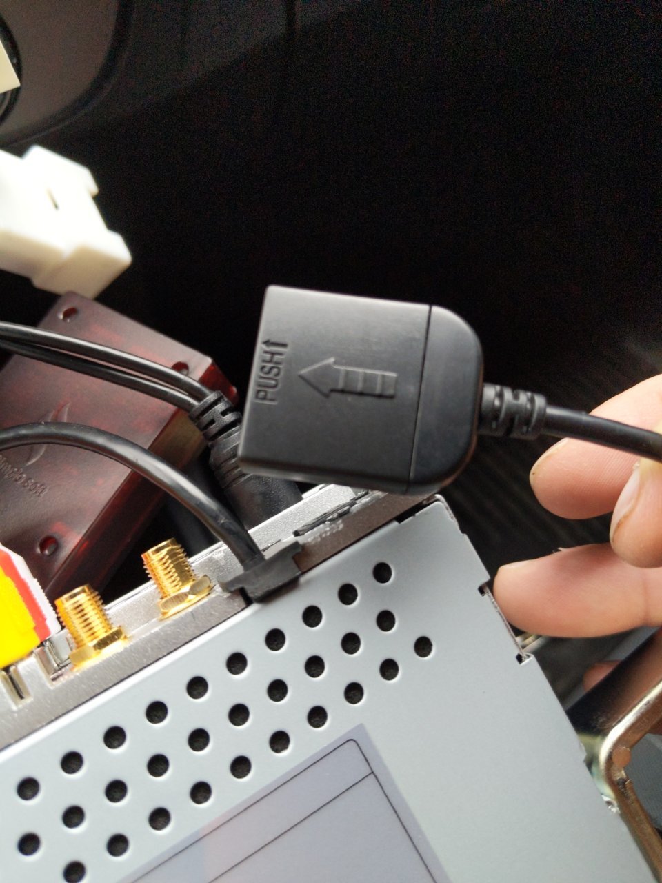

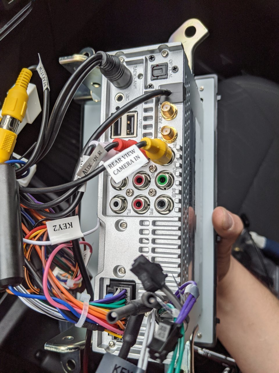

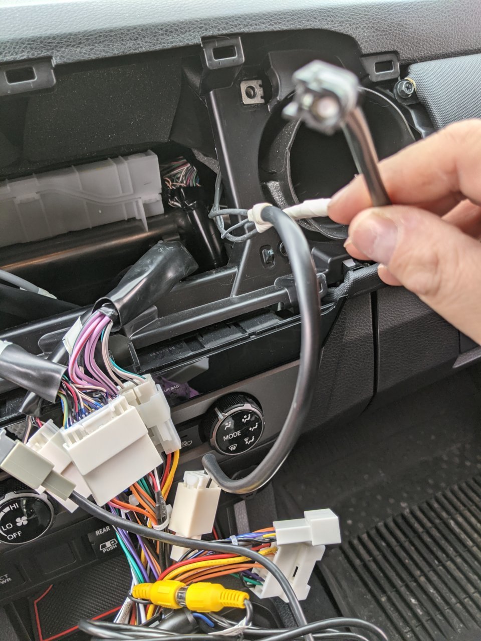

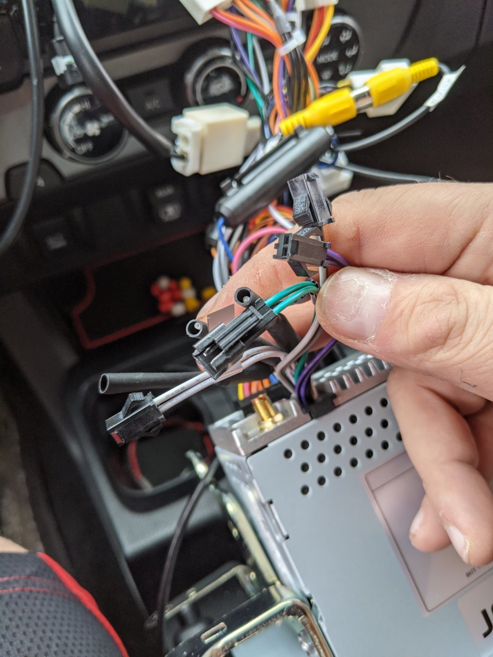

    OK. This is what I'm looking at.
    Is there supposed to be anything plugged into the USB ports in the back of the unit?
    The wires that are shown in pictures, do those attach to anything?
    Pictured are also the "extras" that nothing plugged into. Is that correct?
    The black thing that says PUSH and is plugged into the unit, what's that for and do I do anything with it?
    Sorry for all the questions lol

    The dash USB should be plugged into the USB ports on the back of the headunit. There should of been a adapter that came with the unit that plugs into the factory harness and turns it into a USB plug. This is what the adapter looks like, but it should of come with one.
    https://www.amazon.com/SCOSCHE-Adap...id=pla-823309093603&ref=&adgrpid=100759323744
    I dont think those short wires plug into anything, but Im not sure as mine is the early version that didnt have those.
    The thing that says "push" is for a sim card for cell service.

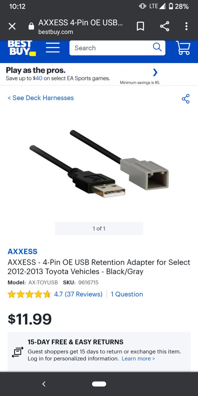

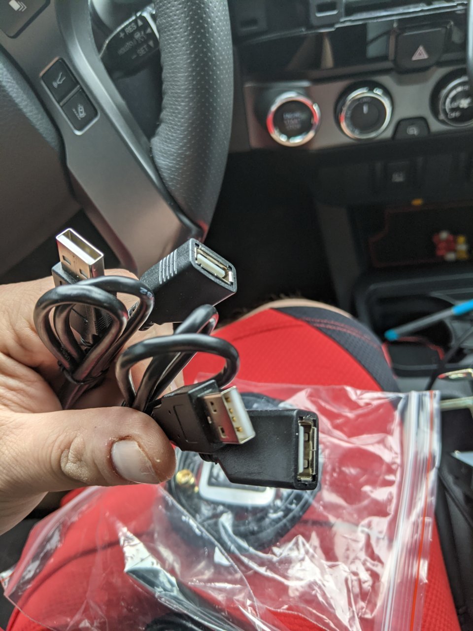

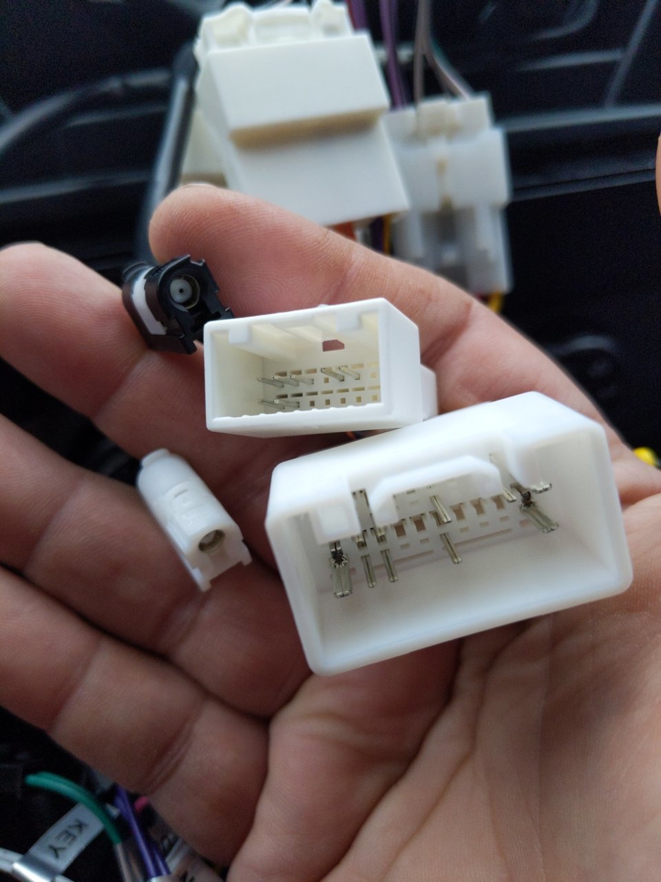

    I've got two of these. Is this the adapter?
  8. Apr 8, 2021 at 7:58 AM
    #768
    5nahalf
    Sep 22, 2018
    #267058
    10,959
    Erik
    Minnesota
    Those just look like extensions. It should be a male USB on one end and a gray square on the other end.

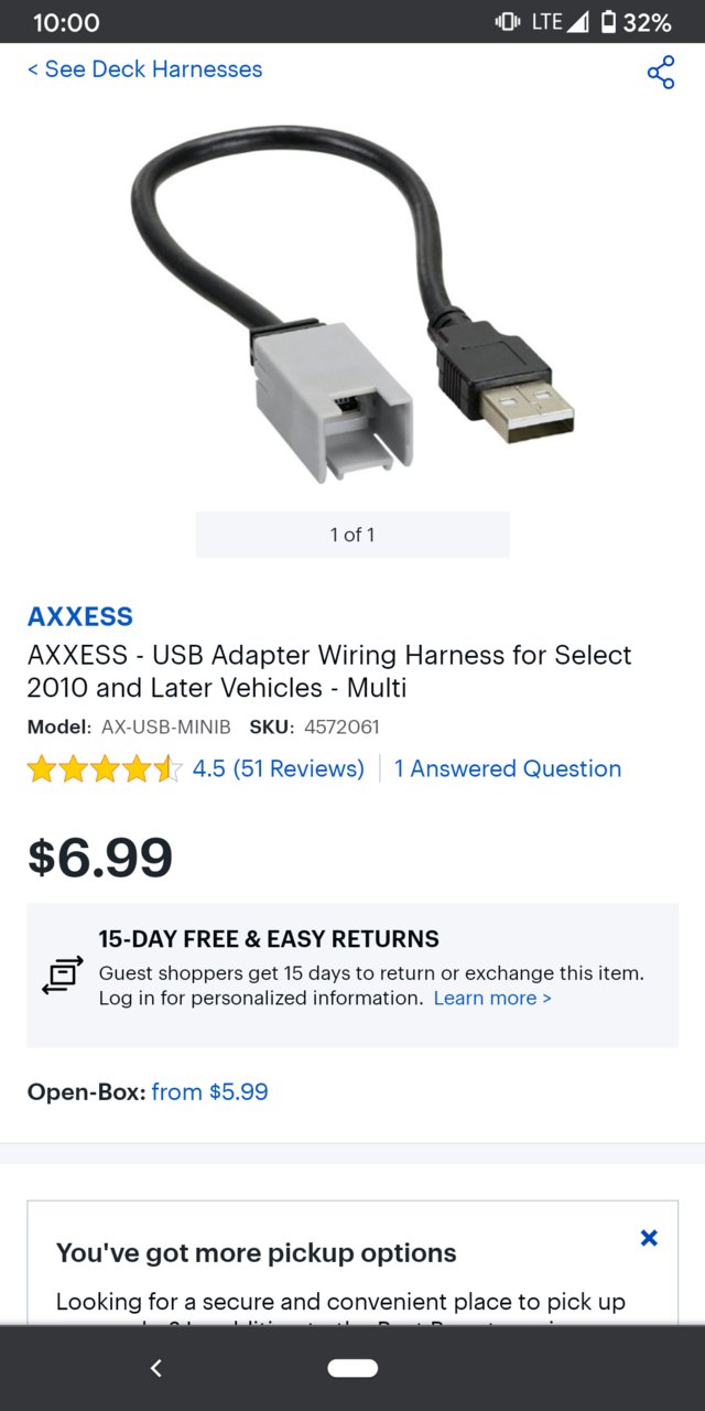

    That work? Where would u plug the gray connector into? I don't see it.
  12. Apr 8, 2021 at 8:13 AM
    #772
    BobU05
    BobU05 Well-Known Member
    Jan 30, 2021
    #354477
    60
    Bob
    Eastern, Iowa
    18' Tacoma TRD Sport 4x4
    Eibach Pro-Truck Lift System (Stage 1) with 18" Fuel Maverick Wheels mounted on 275/65/R18 Falken Wildpeak A/T3W tires. Predator Step Bars. TRD Pro Grill with Raptor lights. TruXedo TruXport Roll Up Tonneau Cover. 15% Window tints all around.
    This actually looks more like what you sent. I just don't understand where to hook it up too

    Trace the USB connector in your dash. The wire attached to it should connect into the gray plug and the USB into the back of the joying unit

    Its the gray plug that would of been in the back of your OEM radio. That wire plugs into the usb adapter, then the usb plug goes into the back of the new radio.

    OK. The one I sent for 11.99 at best buy, will that do the trick?
    I'll get this solved first then try steering wheel controls. I changed it to RAV4 but still nothing.

    Do you have all the plugs coming from the truck plugged into something on the radio? There may be some extras on the radio, but every single plug coming from the truck should plug into something on the radio.
  17. Apr 8, 2021 at 9:55 AM
    #777
    BobU05
    Jan 30, 2021
    #354477
    60
    Bob
    Eastern, Iowa
    Just these two. I don't see a spot for either.
  18. Apr 8, 2021 at 9:58 AM
    #778
    5nahalf
    Sep 22, 2018
    #267058
    10,959
    Erik
    Minnesota
    One of those is the XM antenna, the other I think is the FM antenna, there should also be a adapter for that.
