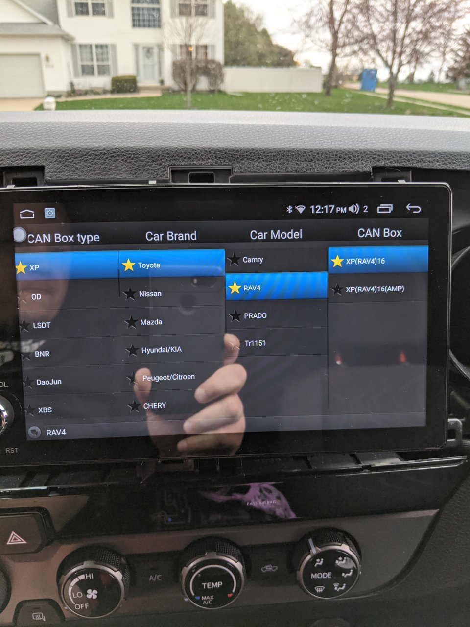

    I just unplugged and plugged everything back in... All appears good. That's what I have selected for car settings. Everything is working except for the darn steering controls lol. Surely I'm missing something in the settings

    I am using RZC -> Toyota -> Hilux -> 2015-2018 for mine.
    Also something to keep in mind, you can not use the "control" app that is in the radio to change the buttons, that app does nothing.

    Tried those settings. Nothing. Tried resetting. Nothing. Is there a specific cable that controls the steering wheel buttons?

    @BobU05 , have you programmed the steering wheel buttons to the stereo functions? Or do you not have to do that with the CANbus plug?

    Shouldnt have to with these. The canbus module does it for you. You cant even change them in the program app.

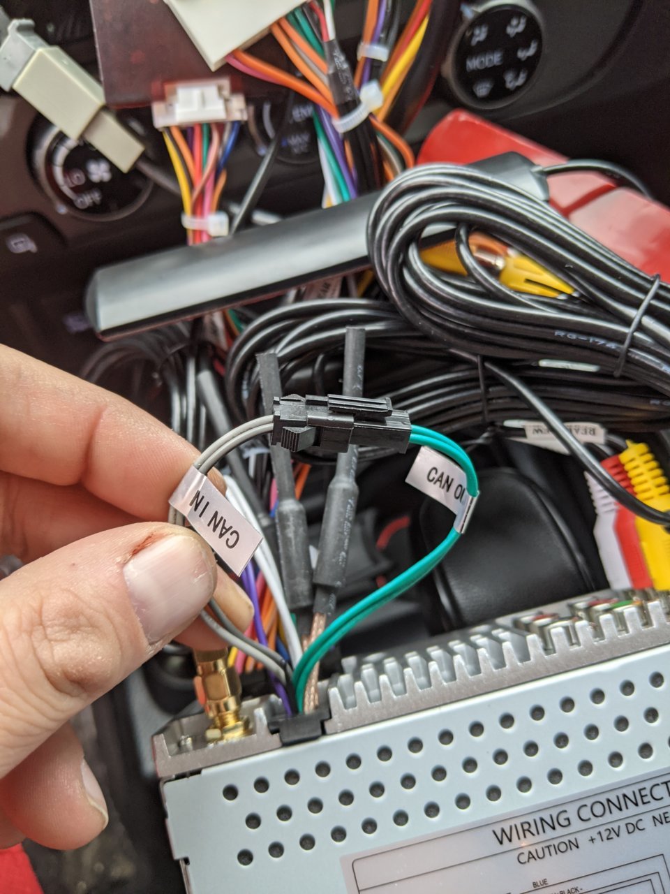

    I sent a message to Joying. If everything else is working as it should, I wouldn't think there are any missing cables or anything like that.

    Holy shit balls.....
    Such a simple fix. These two wires were not connected. Steering wheel controls are WORKING.

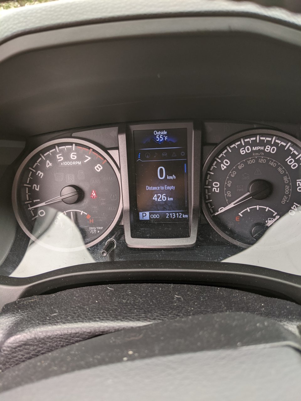

    What the hell did I do and how do I change it lol
    Changed from MPH to km/h

    Fixed it haha
    Thanks for all the help here everyone. This site is legit.
