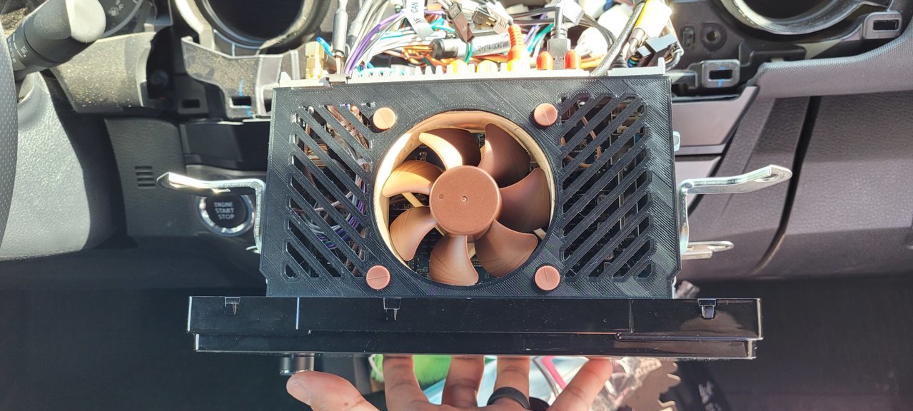

    Just installed mine tonight, spent the better part of it trying to get the steering wheel controls and back up camera working. I have the Car Solutions Front and Rear Camera module; once I disconnected the module, everything was working properly. I have it set as the Hilux 2015-2018. Sucks now that I have a front camera and module that is no longer usable. Although I tend to forget it is there even when I'm off roading. I thought I read somewhere here that some were able to get their front camera working? Any ideas? If it helps I have the non JBL system, I did run into the issue where the radio was beeping and I could not get out of the phone screen. Disconnected the canbus, set the Car Settings and that fixed that. In an attempt to be proactive.
    I was also researching heat sinks and covers for the radio and found a fan cover replacement on Thingiverse. The creator made it so that you can hook up a 60mm or 80mm fan to it. So if anyone who wants to give a go can try printing this out. I will update when I get my fan (noctua 80mm).
    https://www.thingiverse.com/thing:4240690
    MountainManGuy and 5nahalf[OP] like this.
