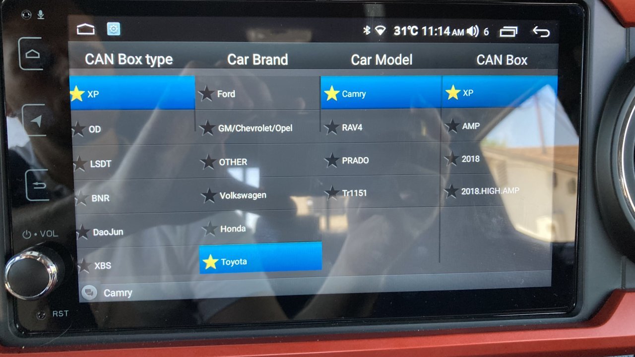

    Omg I found it! It was there. I thought the factory meant restore factory. Not more options. I’m an airhead. I just bought it a few weeks ago, I assume it’s the latest os. Hilex>Camry? I don’t have a hilex option

    You should be fine with camry/xp. Hilux was the pickup name before Tacoma.

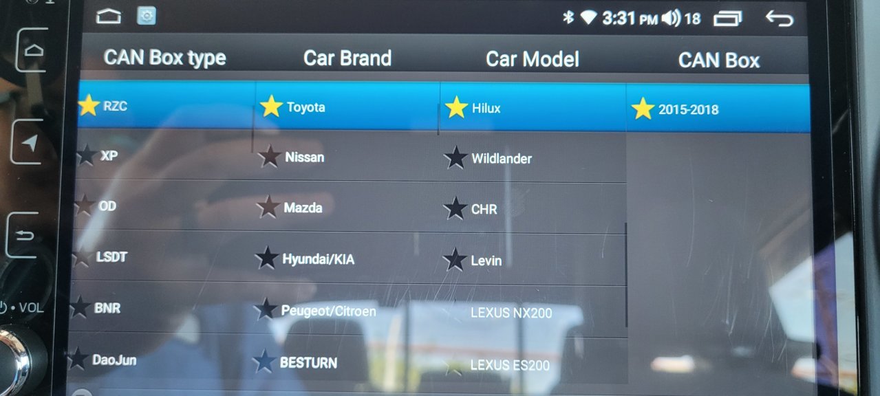

    Yeah, I don't think it matters as long as you grab a Toyota product but that is just my opinion. I just chose Hilux because that is a truck vs the Camry or Rav4 I have seen guys picked. Don't be scared to check the various options that are there. I think there are more Toyota options when going through the Can Box Type. I think its RCZ? or something like that.

    Yeah I went through them all, no hilex options. Honestly my only complaint with the canbus right now and its not a huge deal is my steering wheel controls are flopped. So down is skip. Also my doors lock when I put it into Drive, and I cant change that back to the speed option.

    Like DC4L mentioned it's in the OCA, Reverse Previous/Next = On.
    For the door lock stuff I couldn't change it in the Head Unit eventhough it is in Car Info --> Setup. I had to use techstream for that. But I was able to change my door unlock press. It's like a delayed action. Press the check mark and wait. If it turns green it worked, if not then it won't let you change it in head unit.
    As for the Hilux option, this is what mine looks like:

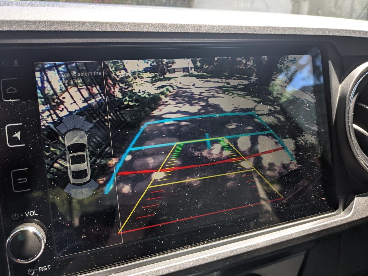

    OK. After about a month of use, I can say that I am enjoying this head unit. I'm a tinkerer though, so I kind of enjoy the excitement of sorting these things out.. So...here's my update to the previous post. I would definitely recommend this purchase to anyone looking for Apple Car Play/Android Auto.

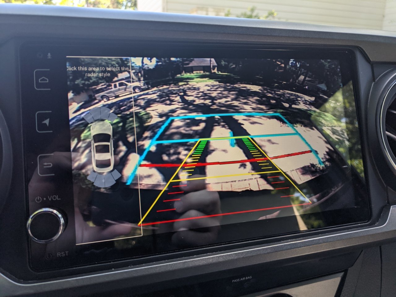

    6. Back up camera sucks now.
    Still sucks. Definitely worse than stock. The way it distorts light is definitely not characteristic of the stock HU. Not sure what's causing this..

    Backup camera always sucked, its just on a better screen.
    Remember how VCR tapes looked just fine on your tv long ago? try watching a VCR tape on a HDTV... it will look even worse. (this may not be a good comparison depending on how old you are)
    The only way to make it better is to get a better camera, but really do you need HD rear camera? do you need to be able to count each merit badge on the girl scout your backing over? All the back up camera is there to do is give you a idea of whats behind you.
    Oh and the issue with the light glare can be fixed by getting the "license plate off in reverse" harness.

    Oh no I fully understand. It was like 240p resolution screen and camera. So yeah its ppi is terrible now. No, not always. But when backing into my garages which is only 6 inches longer than my truck. Its hard to see how close I am to my wall at night because the lights are so damn bright at night. But I do not want them off, I guess a HDR camera is needed.

    Understood. I'm not as concerned with the quality, but when there are streetlights or the sun is behind me, my camera is almost un-usable. This was definitely not the case before. I understand that doesn't make sense, because the screen is receiving it's feed from the same camera. I get it, but there is most definitely a difference other than pixels.

    Here's a few examples of the rear view camera...
