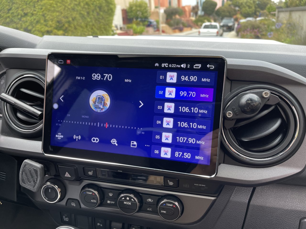

    The main unit will fit inside where the oem radio. The questions is what size screen do you want to go with. They have any where from 6.95” to 13.3” screen that they just released after I purchased a 11.6” for my 4Runner. The 13.3” looks like it can rotate vertically or horizontally.
    This is what a 10.5 will look like on the Tacoma. I will have what a 11.6 will look like soon when I receive it if anyone wants to see what it will look like.

    That looks good but I think I'd prefer it to sit in and flush like the factory one does. Is that possible?

    It's possible, you will be looking for the larger oem bezel to fit the 9" screen.
    Or you would have to measure your oem deck and see if Joying has a smaller screen that will fit your current bezel.
