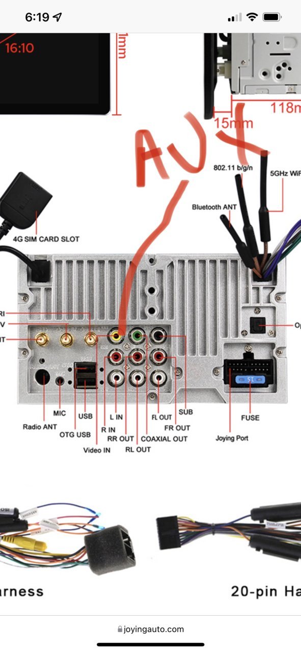

    So hook your front camera into the aux video plug on the headunit. You will lose the switich, but you can switch to the camera feed anytime by pushing aux video on the headunit

    I was wondering if that would work for the camera. Is that just the Vin plug? What did you tap into for power?

    The camera has 12vdc and is in the Vin port but the front display app keeps saying no video. Even when I swap it with the rear it says the same thing. Is there another recommended app?

    Where did you plug your nakita camera into and where is the Aux Control app? Mine doesn't have one.

    i believe this is the aux port and there is an icon named “aux”’or “auxiliary”

    I tried every way I could with that port. Triggered, not triggered, Aux App, Front Video App, even tried swapping it with the rear camera. Always showed "no video input." Throwing in the towel on this one yet again. I messed with this thing for over a week. It never did act consistently, even with a firmware update. When I got this random screen switching from settings to google account, that's when I finally had enough, ha. Too bad too. The screen on this thing is awesome. It's just too buggy for me.
