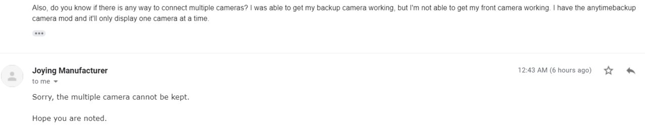

    Apologies if this has been covered somewhere, but it's a looong thread. I'm thinking about getting the Joying 11.6 inch HU, and I was thinking single DIN, because I could use the extra space for a camera switching box I'm building (I want many more than the four I currently have). Anybody know how to handle the mounting bracket issue to put a single DIN in place of the stock 7"?

    Did you ever get this sorted out? The HU doesn't know where the video signal is coming from and the Anytime should work, I'd think. Maybe they just didn't understand your question and gave a conservative answer. I'm planning on running numerous cameras into one of these with a custom switching box (fingers crossed.)

    Unfortunately I never did, sorry. I'm with you though, this thing should have no problem recognizing a second camera. Has anyone else been able to get a front camera working on this thing?

    I have this model: JY-UQS07N4G-H with anytime camera. I make sure the "front video" app is selected and then I hit "front camera" switch. Mine works every time.

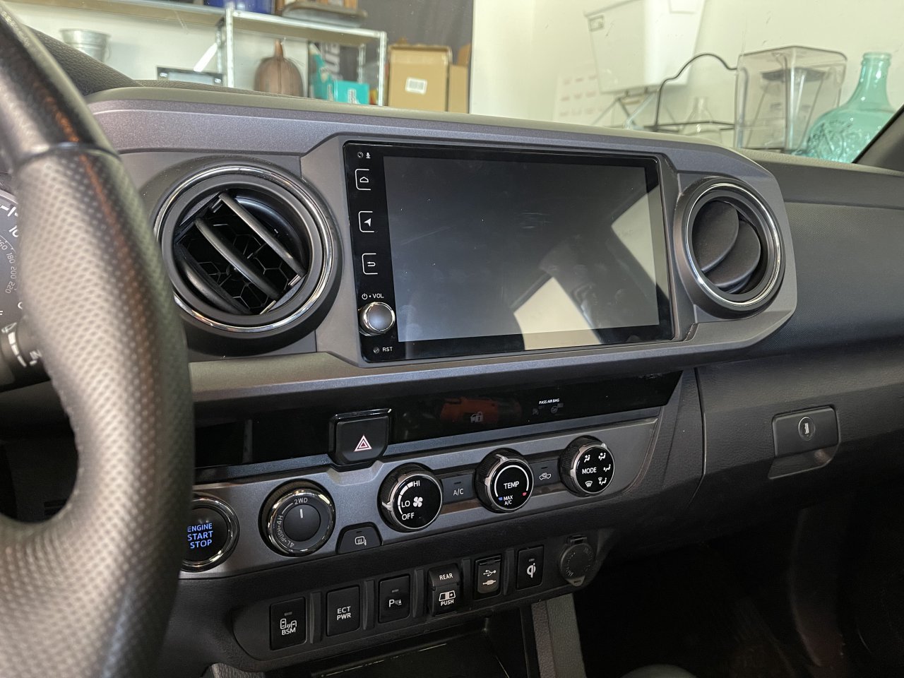

    Thanks to this thread for all the details on this unit. Wireless CarPlay works flawlessly.
    Only issue I'm running into, is when I make a call the person on the other end says that it sounds like I'm very far away. I may end up ordering another wired mic, unless anyone has insight.
