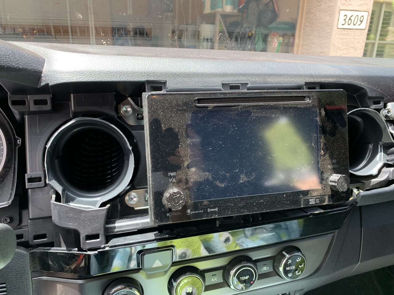

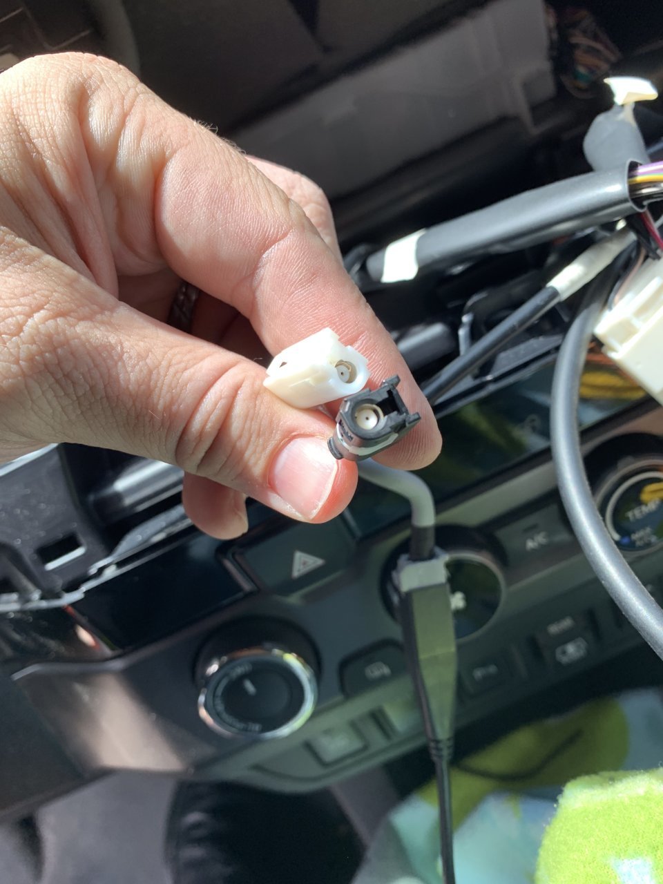

    Remove dash trim and take out the 4 10mm bolts

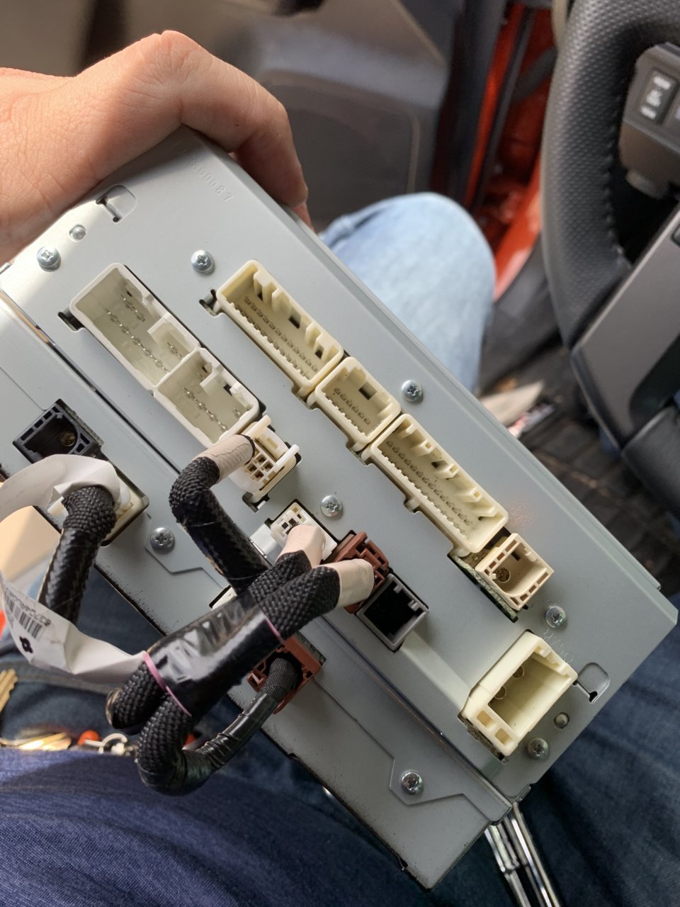

    After that disconnect everything until the radio looks like this. From there you will plug everything in except these wires

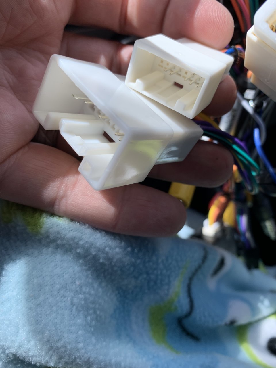

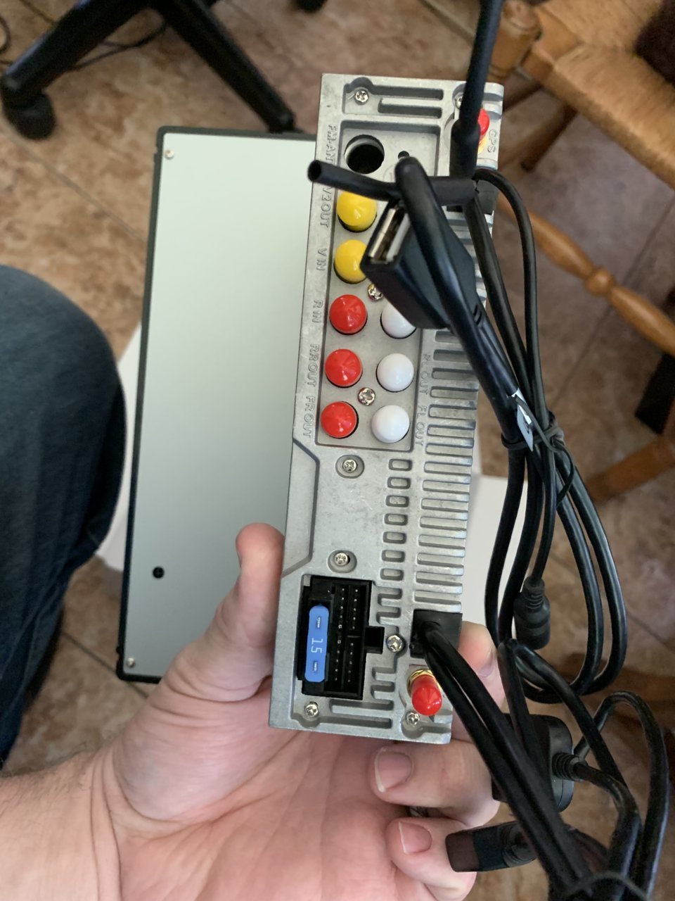

    Now plug everything in. Cables you should have are these.one is main wiring harness and the other is USB cord.

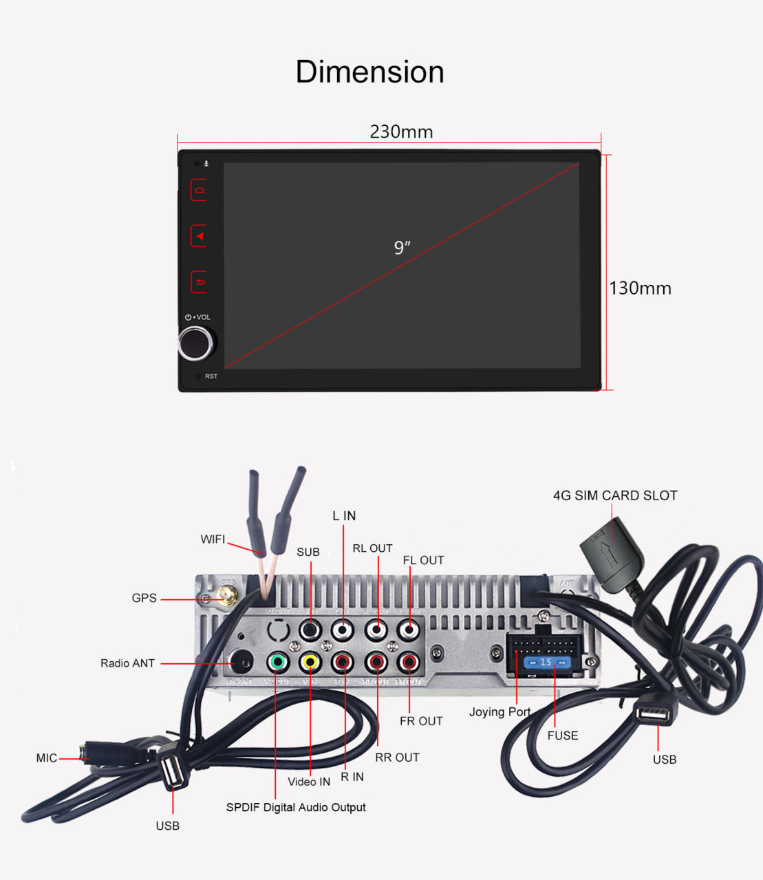

    RIN AND Lin are aux I believe. The you need to test the reverse camera as there are two rcas labeled and only one works. That plugs back into the wiring harness.usb goes to the usb wire that plugs into brown usb harness.

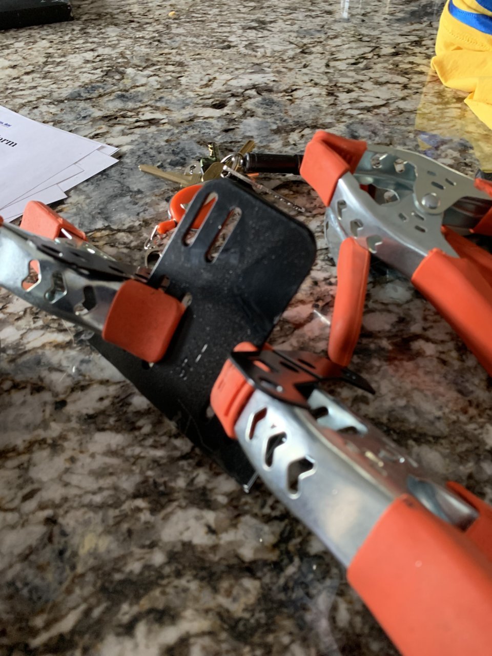

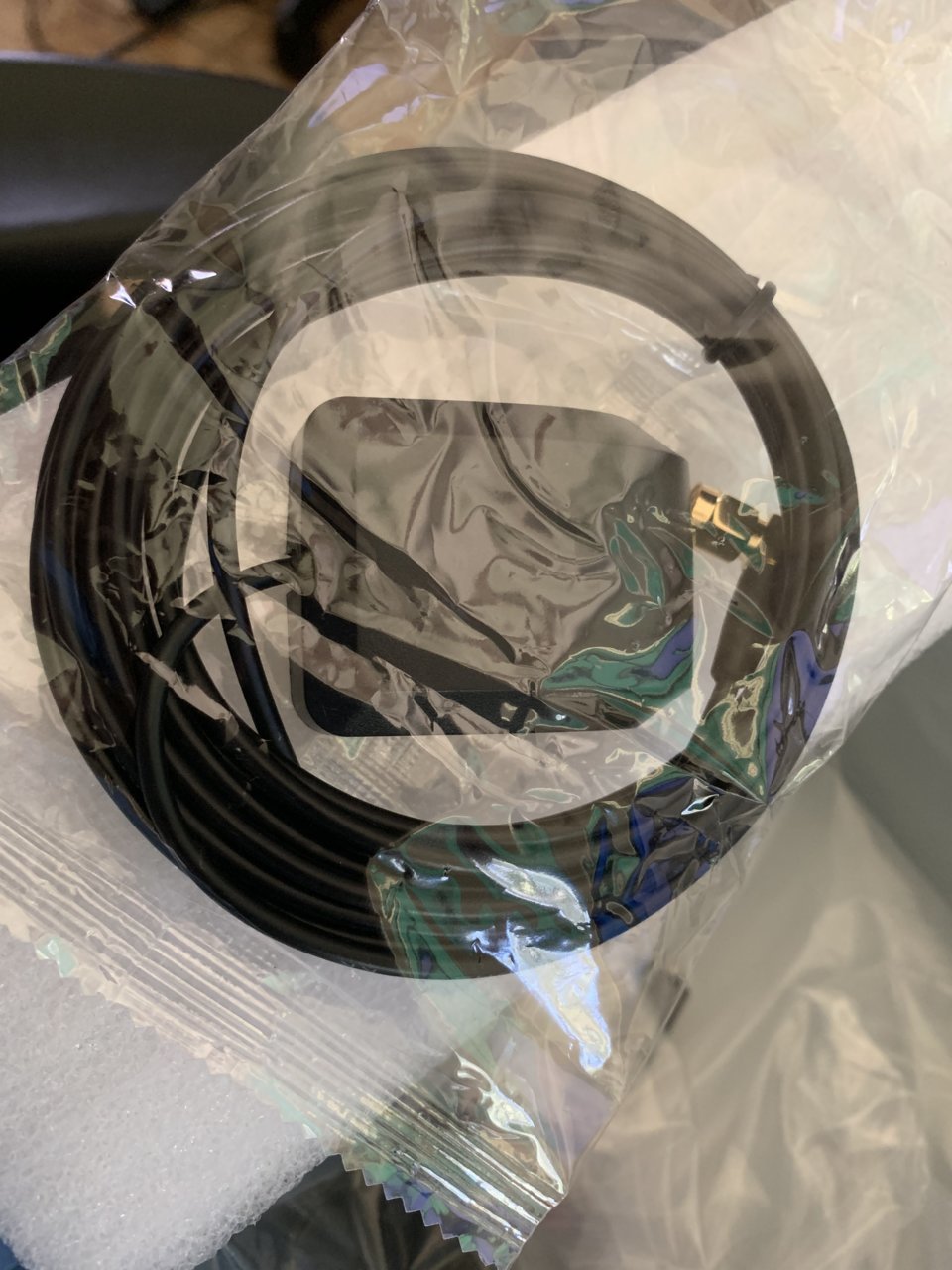

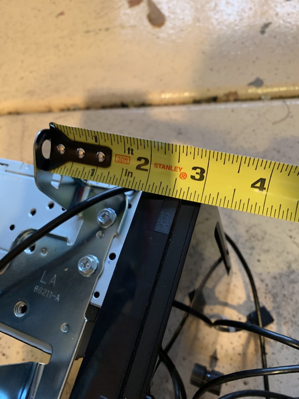

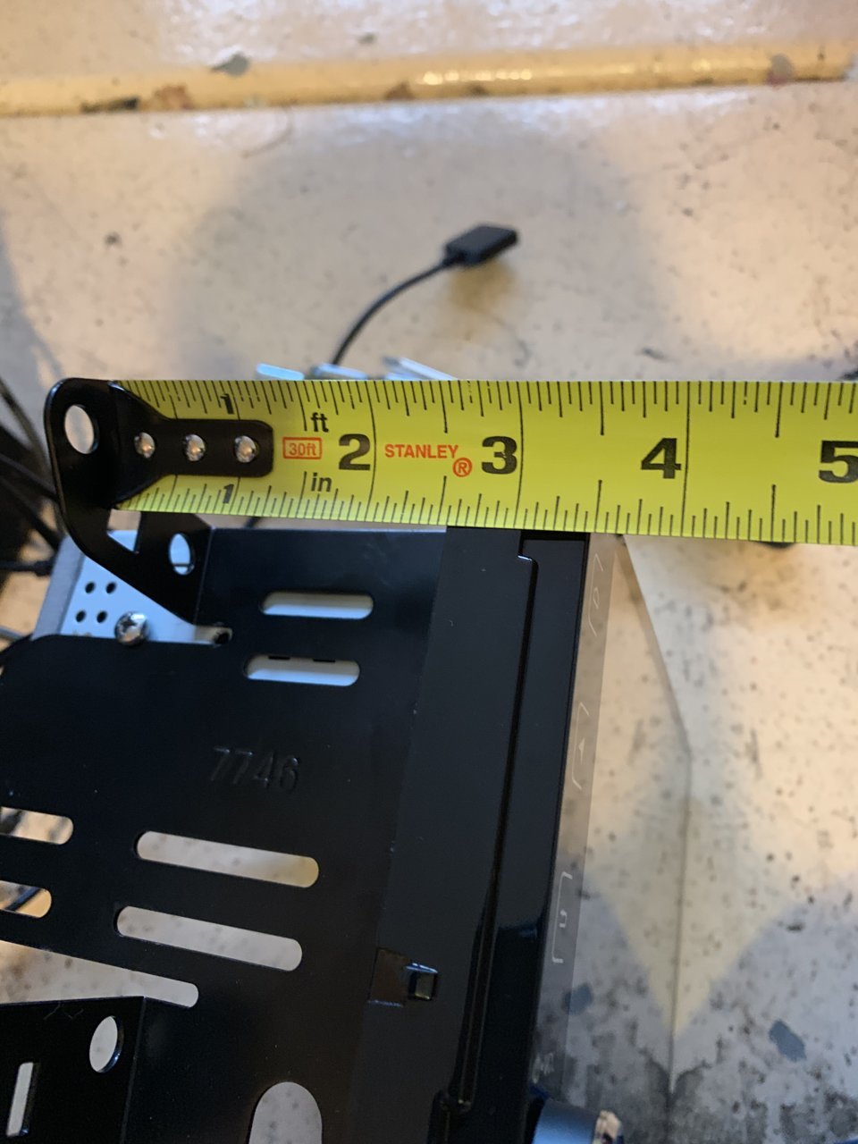

    Then plug the gps and 4g antenna in. I put these under the dash like @5nahalf suggested. I’ll update after I do mounting brackets but these are measurements from scosche kit

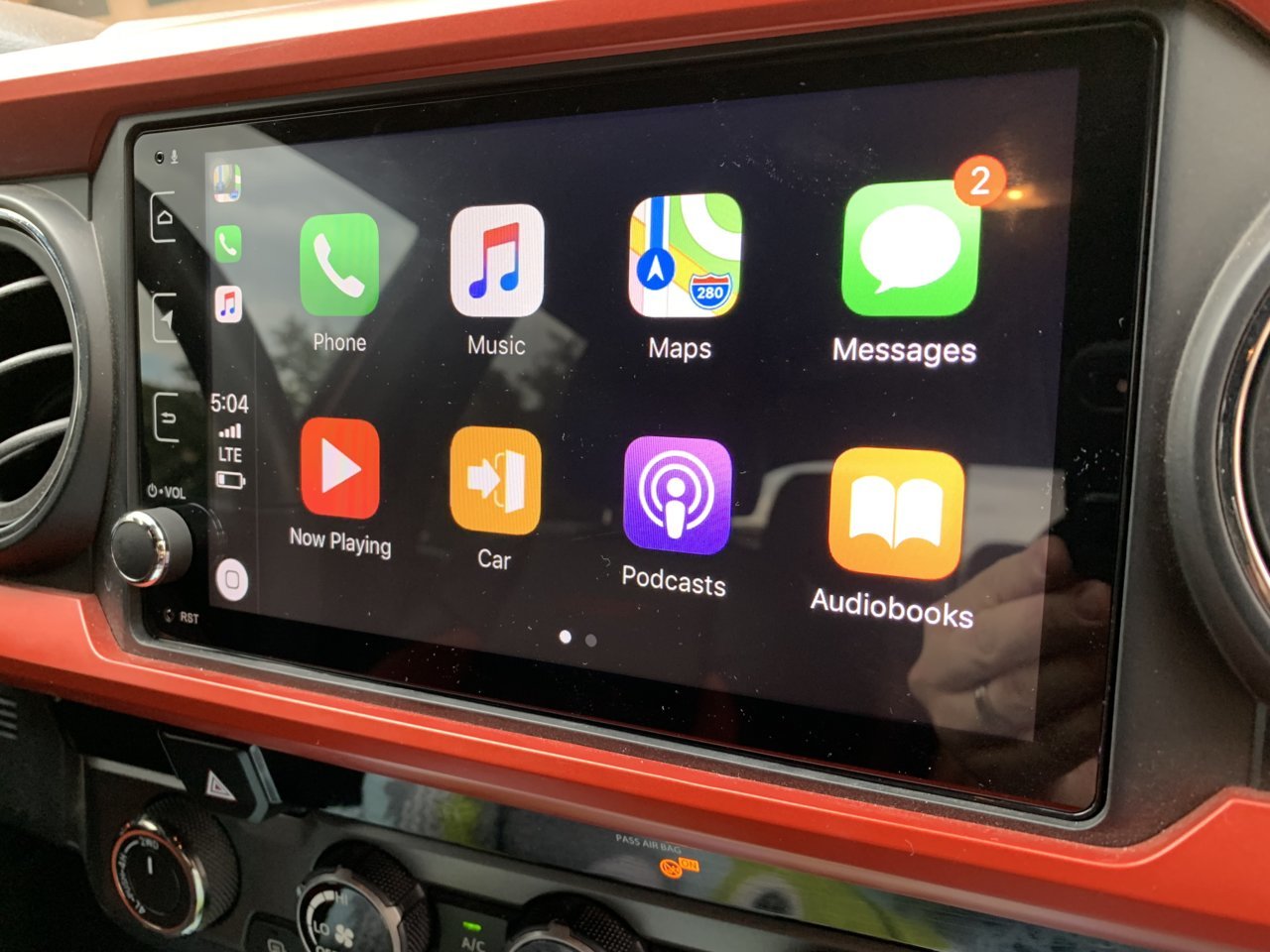

    Right now I am going to take off half inch and see where I am at so I’ll update it later tonight. It’s over 100 out right now. Wireless Apple play does work. You hook up Bluetooth and then WiFi between the two and click z link

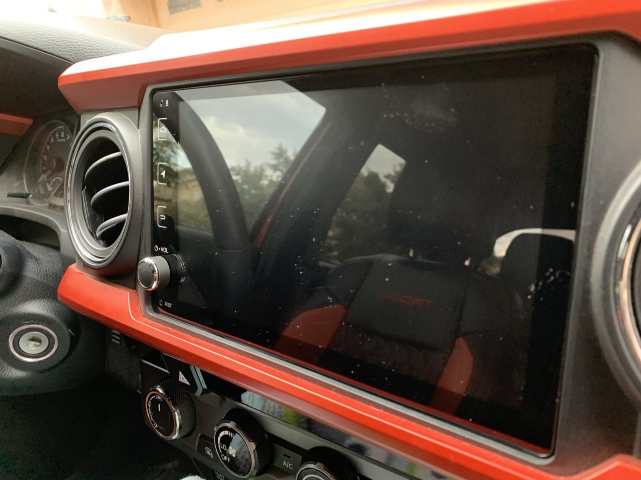

    Here we go, half inch off on each side got it to fit. Soon I’m going to mess around with the software more but it works. I don’t see any issues with the fit so that’s solved for now. Big shout out at @5nahalf . Really appreciate everything, this system is more then I could have hoped for

    How does the wireless car play work? As in how do you set that up?

    Basically you have the option of wired or wireless with the z link. Any time it after setup if it detects Apple it will auto start. First is hook it up through Bluetooth then connect to it through WiFi after that your golden.
