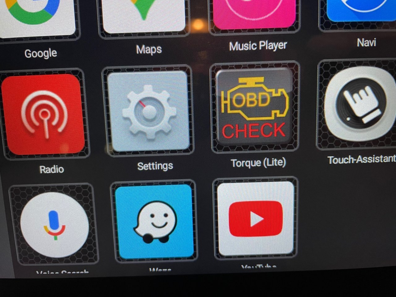

    My unit has been in for about a week now. Definitely takes some patience to work through everything, but I think I am about as good as it gets now. I used the AGAMA app for my home screen as it really makes things simple to use and comes highly rated. CARPLAY launches automatically once I figured out how to set it to auto launch. The only thing I have not figured out is the WIFI. Every time I exit the truck the unit by default switches the WIFI off so i have to turn it back on each time, but that could be done that way so I don't blow through all my phone data. Took me a bit, but I also got it to read F instead of C for the temperature. Since I use a Garmin Earthmate for emergencies I get access to the app and all their maps. I installed that and get great topos. So far it works great. I wish I could use the stock GPS antenna but have not found the right adapter yet. I tried just putting the aftermarket one on the dash above the unit, but it could not reliably find satellites there. It is now on the dash by the passenger a pillar and it works great.

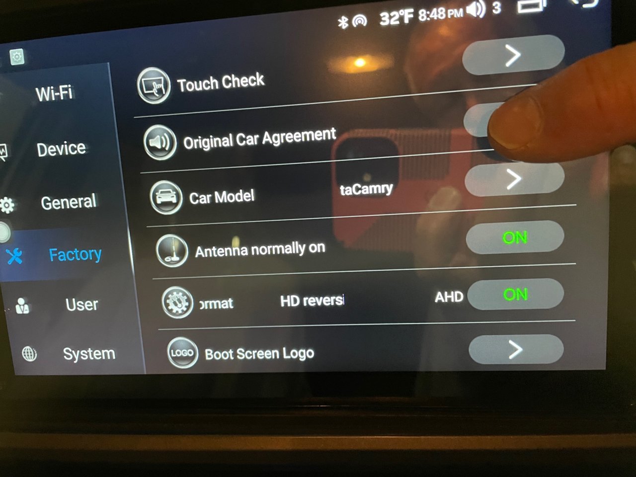

    Explain how you got C° to F°

    Next time I am out in my truck I will right down the steps. It was in one of the menus

    The following is what I did to switch C to F for temp. Go to settings app (my apps look this way as I use the AGAMA launcher). Go into Factory (password is 3368), then select original car agreement (you will see my vehicle selection another line down was toyota camry). Once in the original car agreement screen you should be able to scroll down to temperature unit switch. If you don't see it when you open the screen scroll down as these menus are often several pages long.

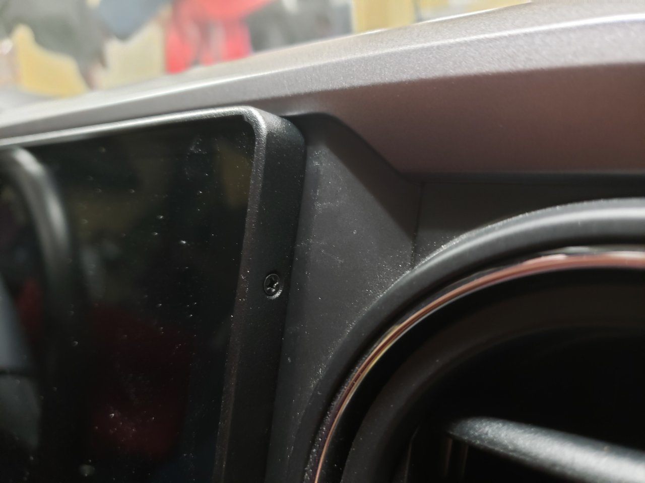

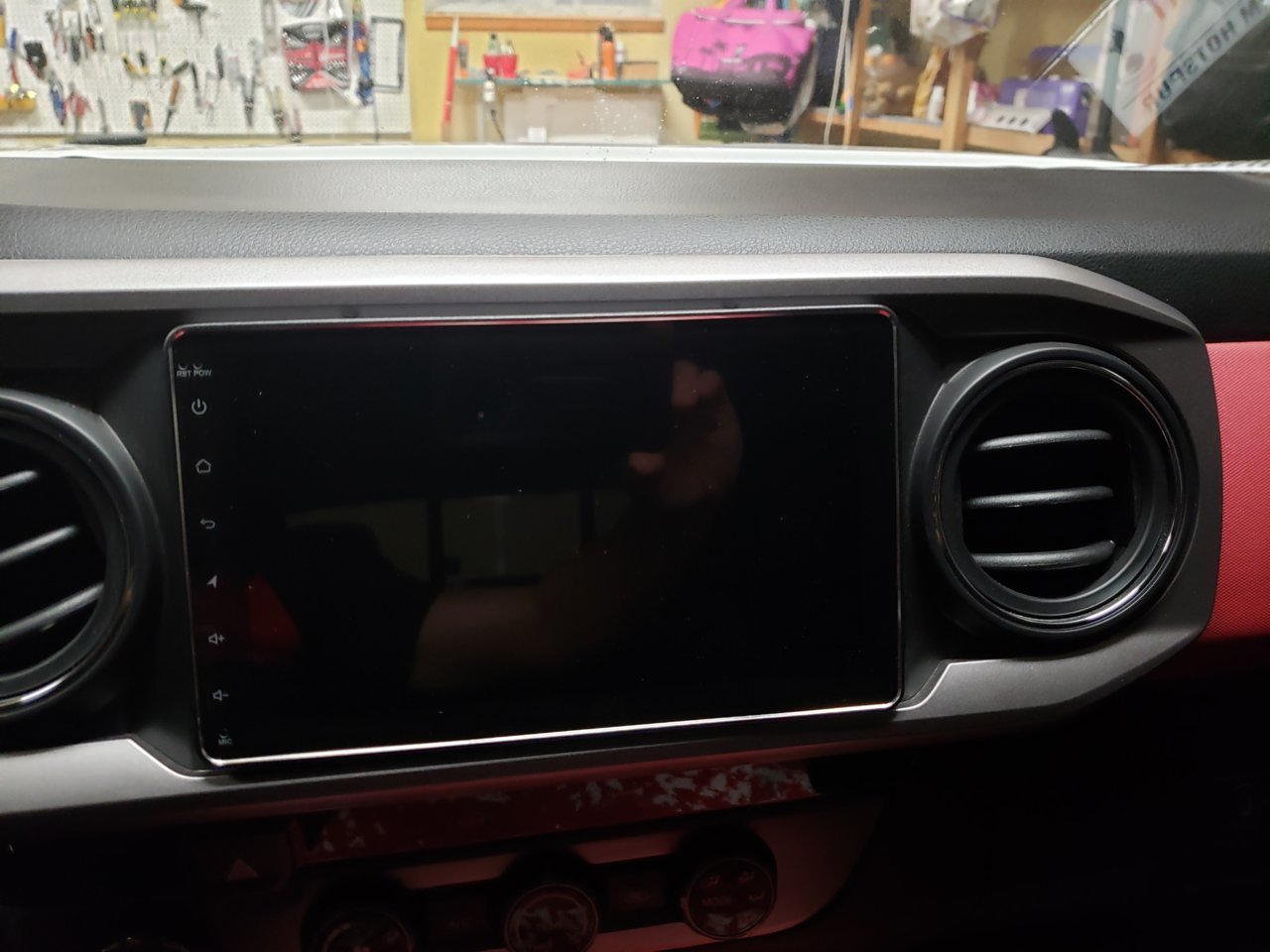

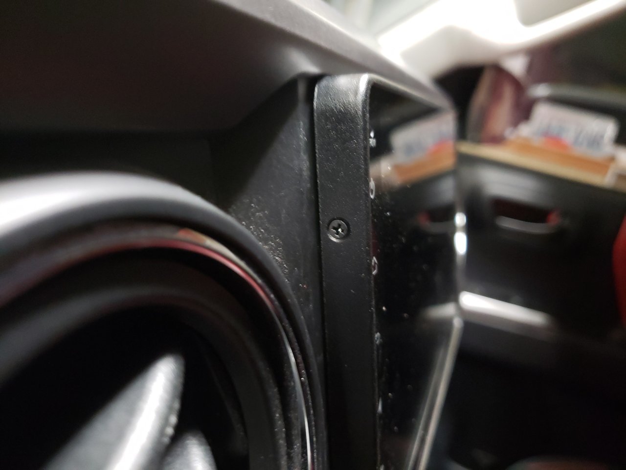

    So I replaced the stock HU with 9" unit on SR5. This one fits flash with SR5 bezel (small opening)
    Was able to put 3 screws per side , drilled out 1 hole on each side.
