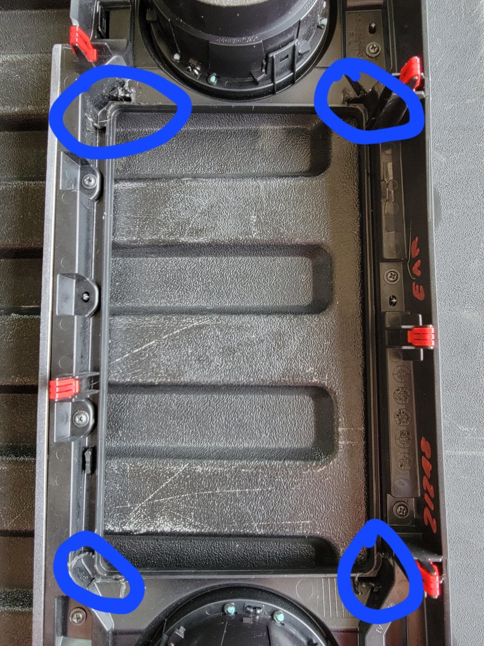

    Does the top of the bezel go on first or the bottom?
    I can get the bottom in no problem, but the top seems to not lift enough to stay.
    Also here are the tabs i trimmed. Did i miss any?

    Looks like you got them all. I put the top in first, then the bottom. But try the tape trick, it should help you a ton here.

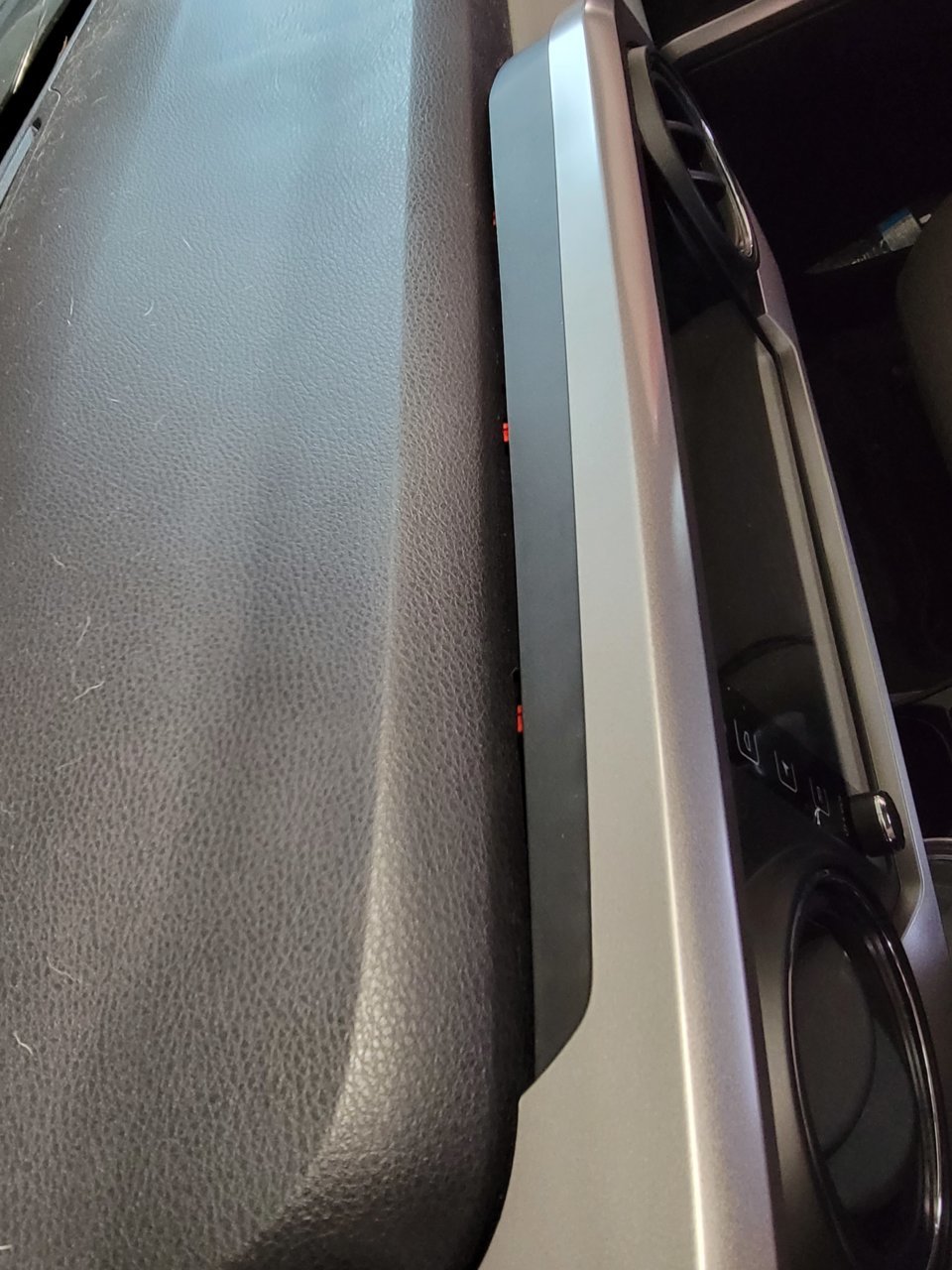

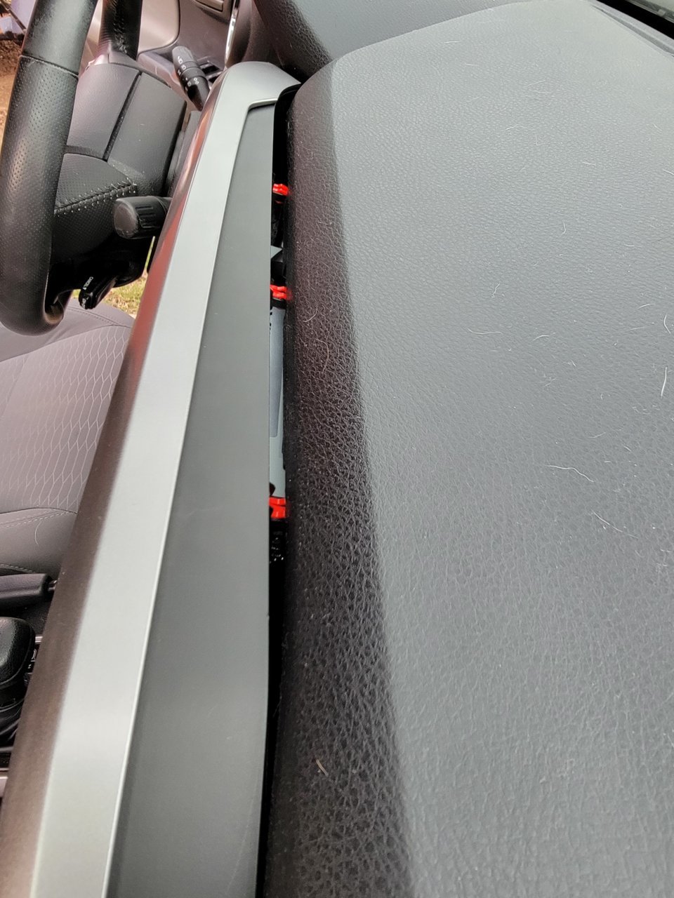

    Ok, i tried the tape trick without success. The gap is too tight to even move the tape.
    This is the best i can get it, but the top just keeps popping off the clips. I dont know what else to do?

    So this is something I did when I first installed mine.
    Unbolt the radio from the dash, then push it into the bezel. Then clip the bezel with the radio already pressed in to the dash. The radio wont be bolted down, but it stays in place just fine.

    I tried that too, the radio just falls into the dash. I think i have come to the conclusion i need to purchase the sosche bracket because for whatever reason my factory brackets don't allow the radio to sit back far enough.
