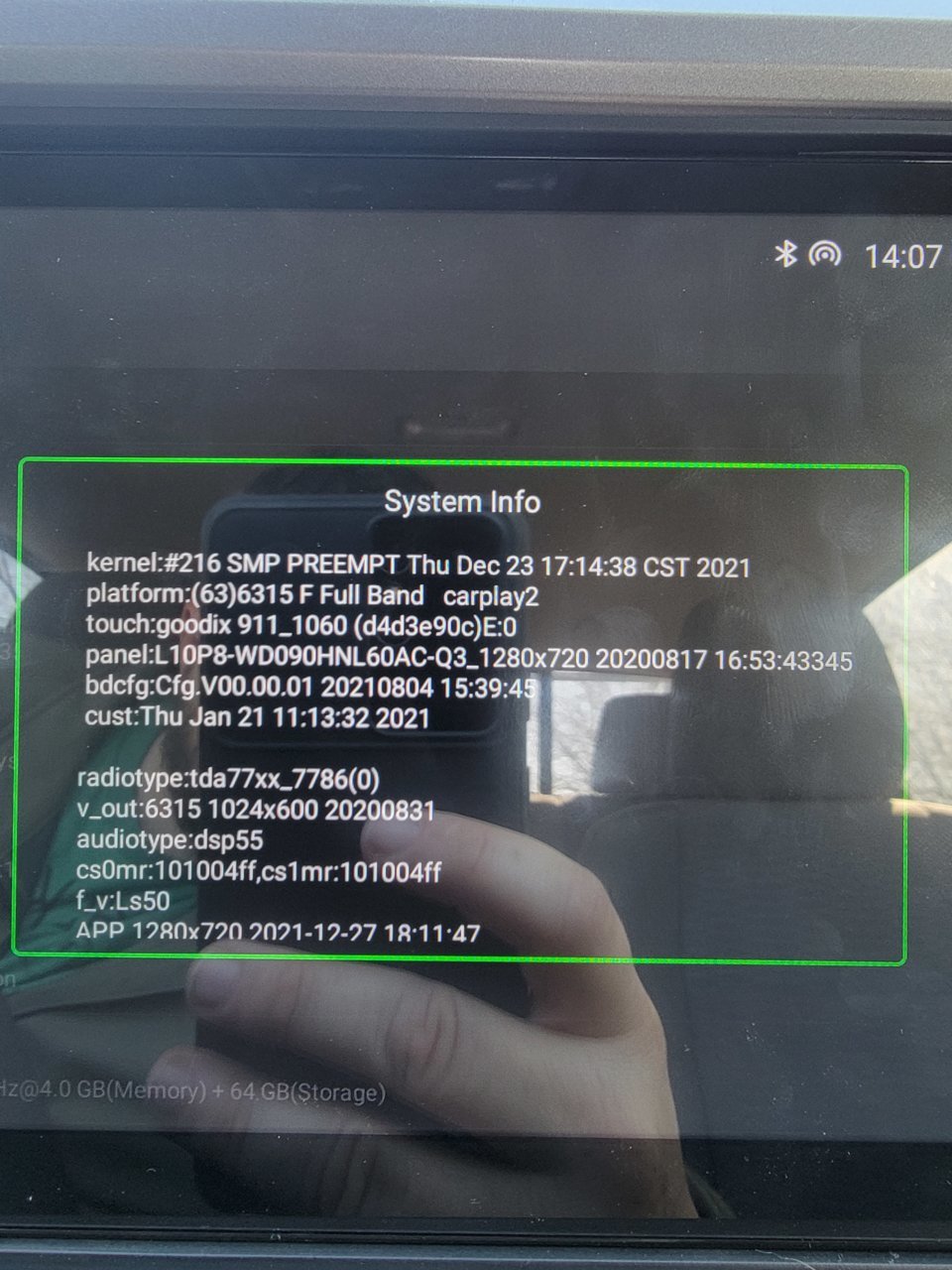

    Here is a picture of my updated software.
    I think you have to have carlink 2.0

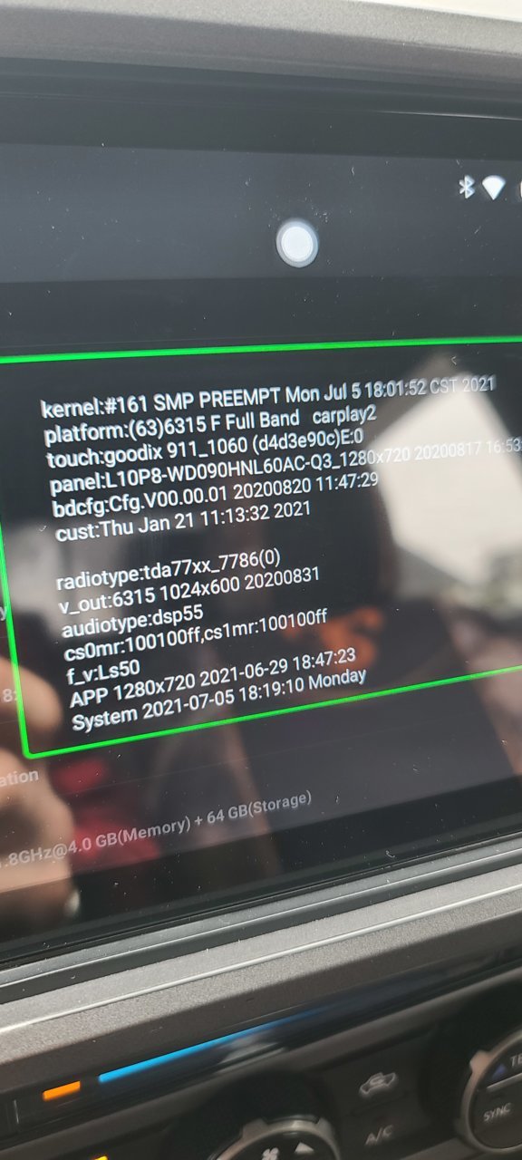

    If I see straight
    Yours July, other one is December 2021.

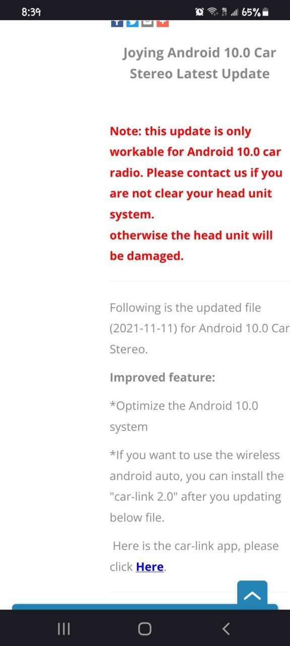

    Is there a new update for our units

    Current version seems to be from 11/11/2021 and it allows for wireless android auto. This is only for the android 10 versions of the unit. If you have the older version like me then the most recent update is from april 2020.

    Some of us do. I have android 8 unit since I got the first version. You have to check what version of android you have as the early and mid ones had 8, the newer ones have 10.

    I have Android 10 . So I should be good to update then . I'm only. Asking cause this update allows for wireless Android auto

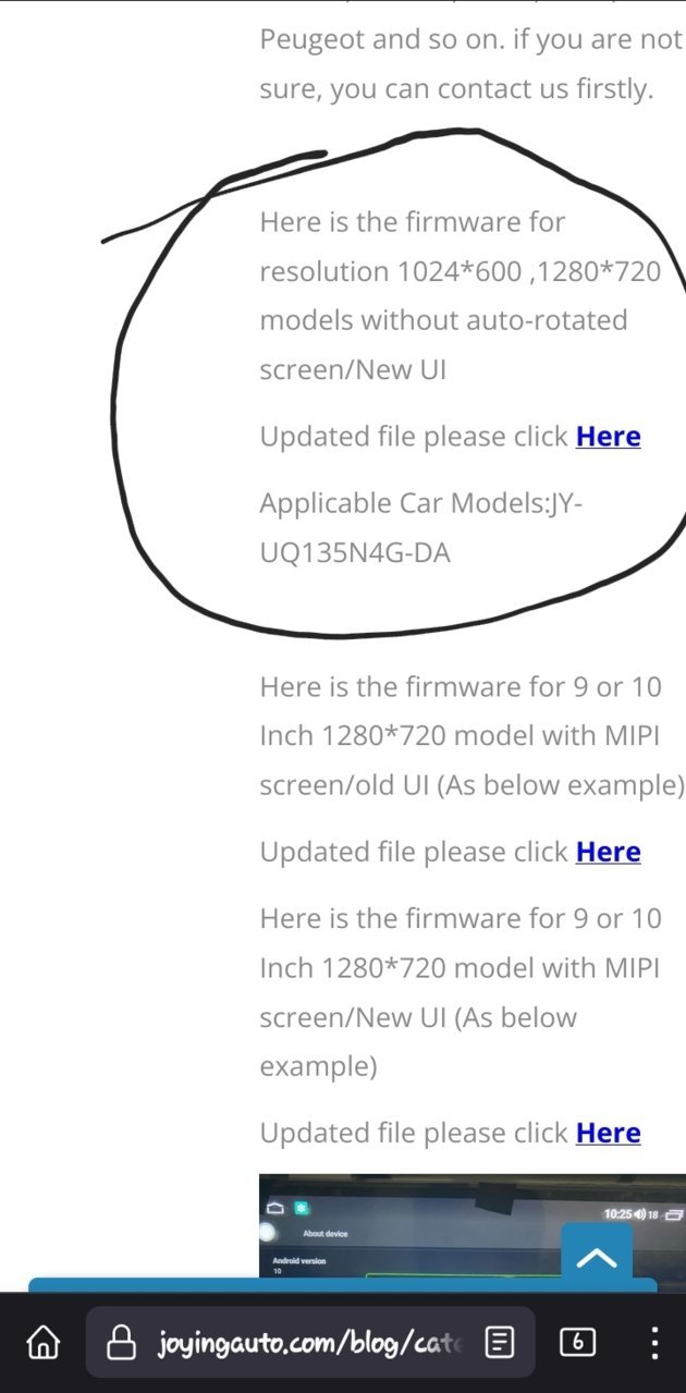

    Screenshot_20220108-085958_Firefox.jpg I believe this is the right file

    How do you find your applicable car model so you pick the right update file
