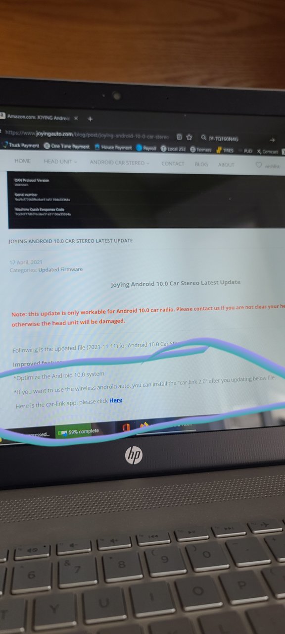

    So just finished update oh yeah baby wireless Android auto. I'm confused cause I did the update and wireless Android worked after update . So why do I need to update the other file to get wireless Android to work ?
    Vlady likes this.

    Probably already installed. Look under system application

    Here are the instructions I received from Joying, but keep in mind i just bought my headunit, so its the Android 10 version.
    Here is the headunit i just purchased on Amazon
    JOYING Android 10 Car Stereo Octa Core 9 Inch Head Unit 1280 x 720 Compatible with Toyota Corolla 2017-2018 & Toyota Tacoma 2016-2021,4GB RAM+64GB ROM Support Android Auto/Carlink//5G WiFi/Plug & Play https://www.amazon.com/dp/B08KD68BZT
    Here is the upgrade link.
    https://drive.google.com/file/d/1ALKIv59cLyg5H66ioGXLP_EhidSms8ba/view?usp=sharing
    Upgrade steps:
    1. Download and unzip this file from your computer
    2. Copy all files in the unzipped folder to your USB drive, please format your USB drive on your computer first
    3. Insert the USB drive to the unit
    4. It will update automatically
    5. Re-select back to the previous canbus protocol after the upgrade.

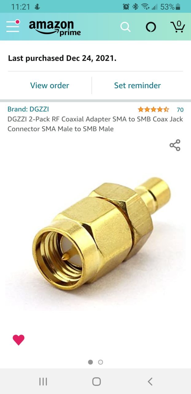

    For anyone that bought the idatalink sto2 adapters to get the factory GPS to work with the head unit, could someone point me in the right direction to get the other adapter you need to get that harness to work.
    I read somewhere that it was an SMA to SMB adapter? Is that correct
    Not sure what one needs to be male and female?

    if you use iDatalink acc-sat-to2, buy this.
    rjplace[QUOTED] likes this.
