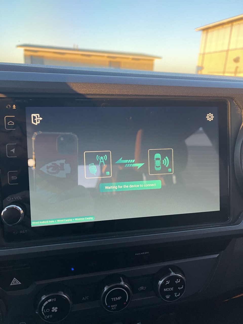

    Having some random issues, literally started after sitting all weekend. Car link will not connect. I’ve tried to unpair, disconnect and restart the unit. It gets to this screen and stays there. I may try the reset button on the face, as I’ve just rebooted the unit from the drop down.
    Anyone have any ideas? Bluetooth will work, just carlink won’t fully connect.
  19. Feb 14, 2022 at 7:02 AM
    #1319
    K-Rob3
    K-Rob3 Well-Known Member
    Sep 14, 2021
    #377039
    71
    Kevin
    2018 TRD Sport
    Yes, I have had this happen too. I opened my phone and turned Bluetooth and Wi-Fi off then back on. I also hit the home button on the stereo and then opened carlink again keeping my phone unlocked and ready to turn off Bluetooth or Wi-Fi again if needed.
    This usually fixes the issue but pushing the reset button may also fix it.
    shotgunbilly420 likes this.
  20. Feb 14, 2022 at 7:10 AM
    #1320
    jdmjustin
    jdmjustin Well-Known Member
    Jun 4, 2021
    #367647
    256
    Justin
    SW MO
    2018 BBP Tacoma Sport
    Motegi MR149 17x8.5 Falken Wildpeak 265/70/17 Toytec Aluma 2.0
    I tried turning bluetooth off, unpairing, re-pair it. It still just sits on that screen. I'll probably run out to my truck on lunch and see if I can push the RST button. I will also try the Wi-Fi as well, as I didn't do that this morning. Thanks!
