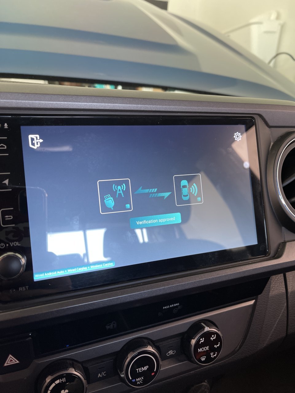

    So got home, disconnected battery to reset.
    it connects with Bluetooth no issues. I can place calls. Play music, radio works just fine.
    it will not connect CarPlay. Just does this:

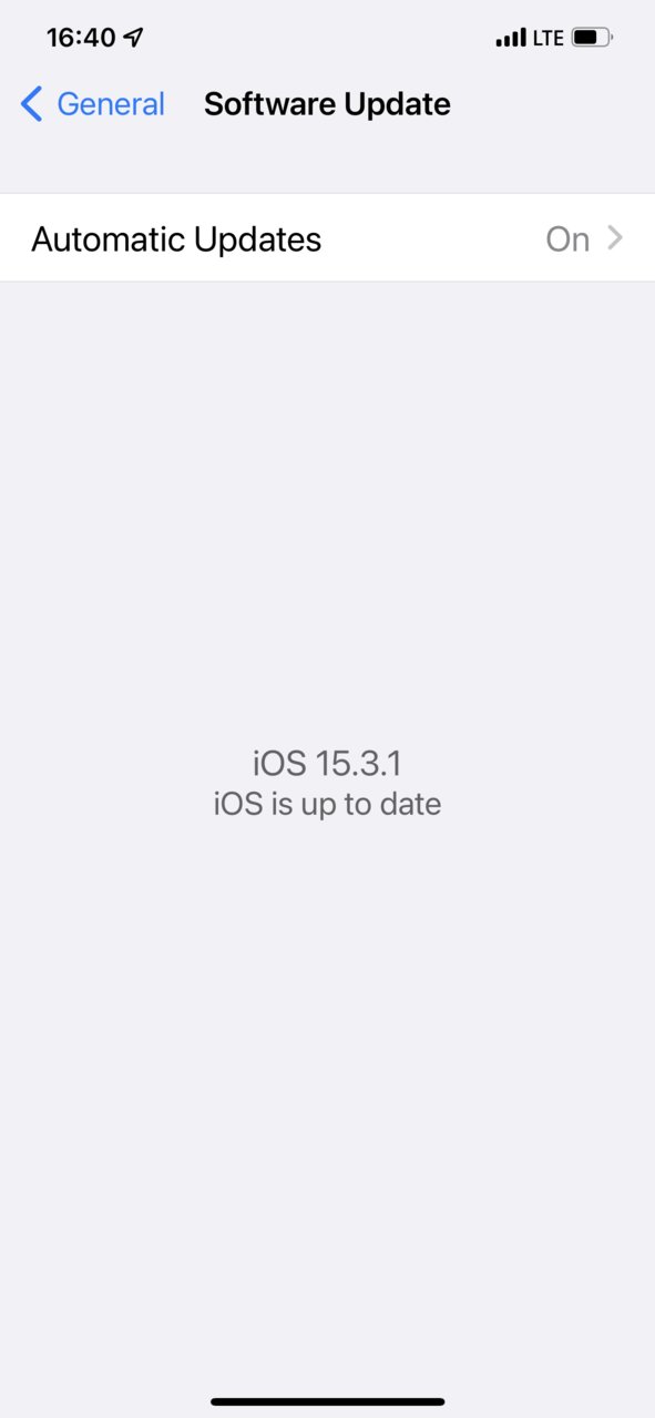

    Just cycles back and forth. The only thing that’s changed in the last 2 days is my phone updated to this:
    I’m just not sure what I should do. Any pointers?
  4. Feb 14, 2022 at 3:12 PM
    #1324
    K-Rob3
    K-Rob3 Well-Known Member
    Sep 14, 2021
    #377039
    71
    Kevin
    2018 TRD Sport
    Damn, that sucks. I am still running 15.2.1 on my iPhone so its very possible that is the issue. Did you go to main home page and use the button on top right corner (3 stacked boxes?) to close out all open apps? And then did you push the small reset button on bottom left corner of unit?
    Do you have Carlink set to open automatically when you start the truck?

    Will it do carplay if you plug it in through the USB? I would try that for starters to see if your phone works that way. I run mine via USB about half the time. Also double check all the settings on your phone to make sure nothing has changed.

    I don’t have it set up that way, I’ve tried to set it up but I always mess it up. Wish I could start over from the beginning. I did close all the apps and it still is messed up.
    now that you mention it, no it doesn’t. USB works, as it charges my phone.
    It’s just strange that it’s been working flawlessly before this weekend.

    UPDATE: wife and I were just chatting about wifi, I look up and notice my phone isn’t connected to my house wifi. Open up wifi settings, it just searches and searches, not finding anything (there are 7-10 wifi ports around our house.). So I just hard restarted my phone, boom wifi connected. I’m willing to bet, that’s been my issue this whole time.

    That totally was it.
    Basically when my phone updated it bricked my wifi. Even turning wifi on and off on my phone like you suggested earlier, did absolutely nothing. After I rebooted my phone completely, wifi was working on my phone. Got in the truck this morning and everything worked like a dream. It even connected faster!
    I did notice yesterday when attempting to check the wifi connection that I wasn't getting anything. Not even any other random networks within range, but I never put 2 and 2 together.
