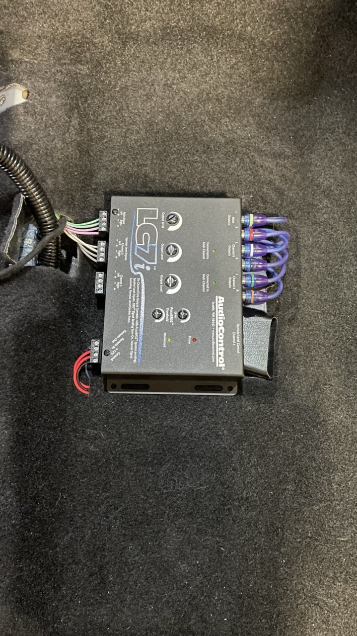

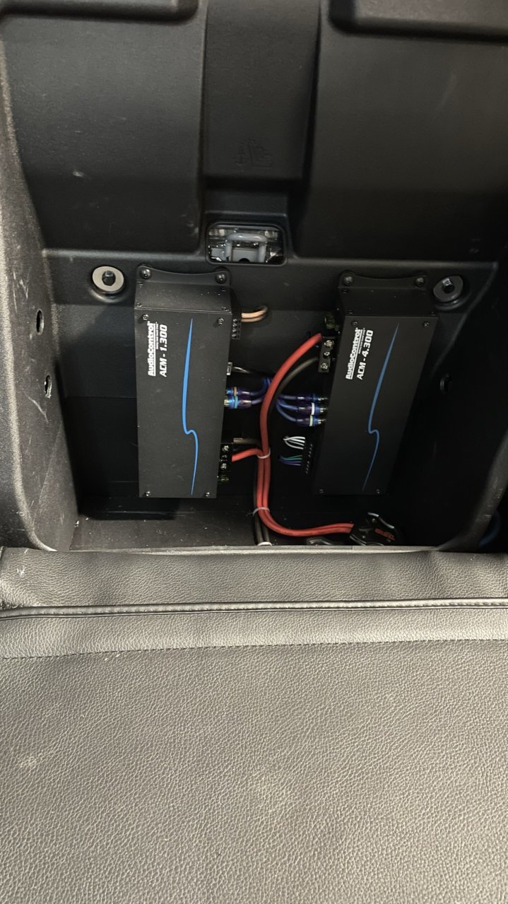

    So I finally got my stereo to where I pretty much want it. I did remove the Joying and put my stock HU back in due to the carplay issues. I am happy how it sounds now but I'm sure I'll still tweak it here and there. I installed the LC7i under my seat and the ACM 1.300 and 4.300 behind the driver side storage cubby. The 1.300 is powering a kicker CompRT 8" sub in a custom box I built. I still have the slight hiss with no audio, I played with the gains on the LC7i and the amps and was able to reduce it but it's still there. I'm not sure if there is any hope for that, I even tried to ground the headunit direct to battery as well as ground the amps direct to battery with no change.

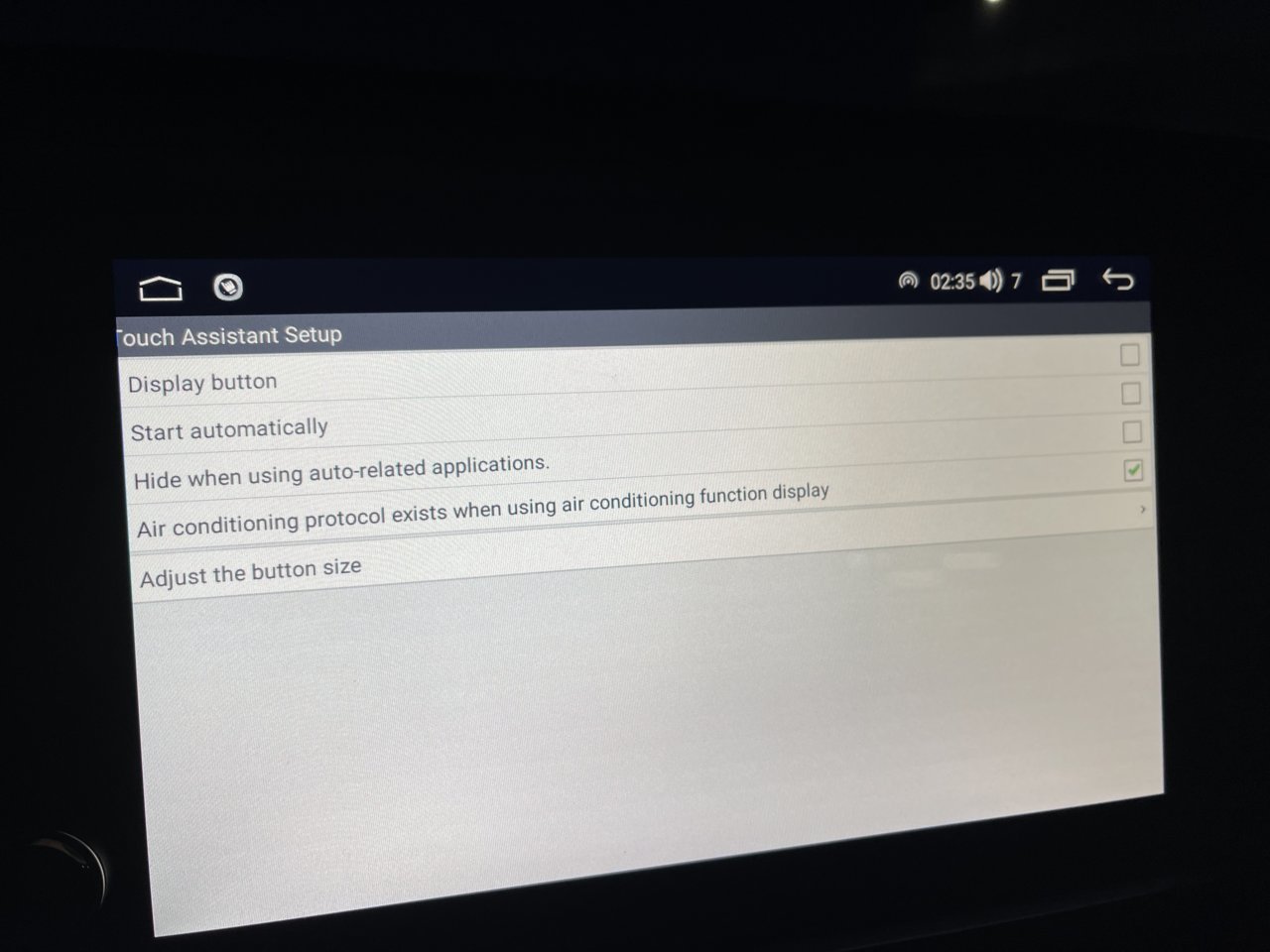

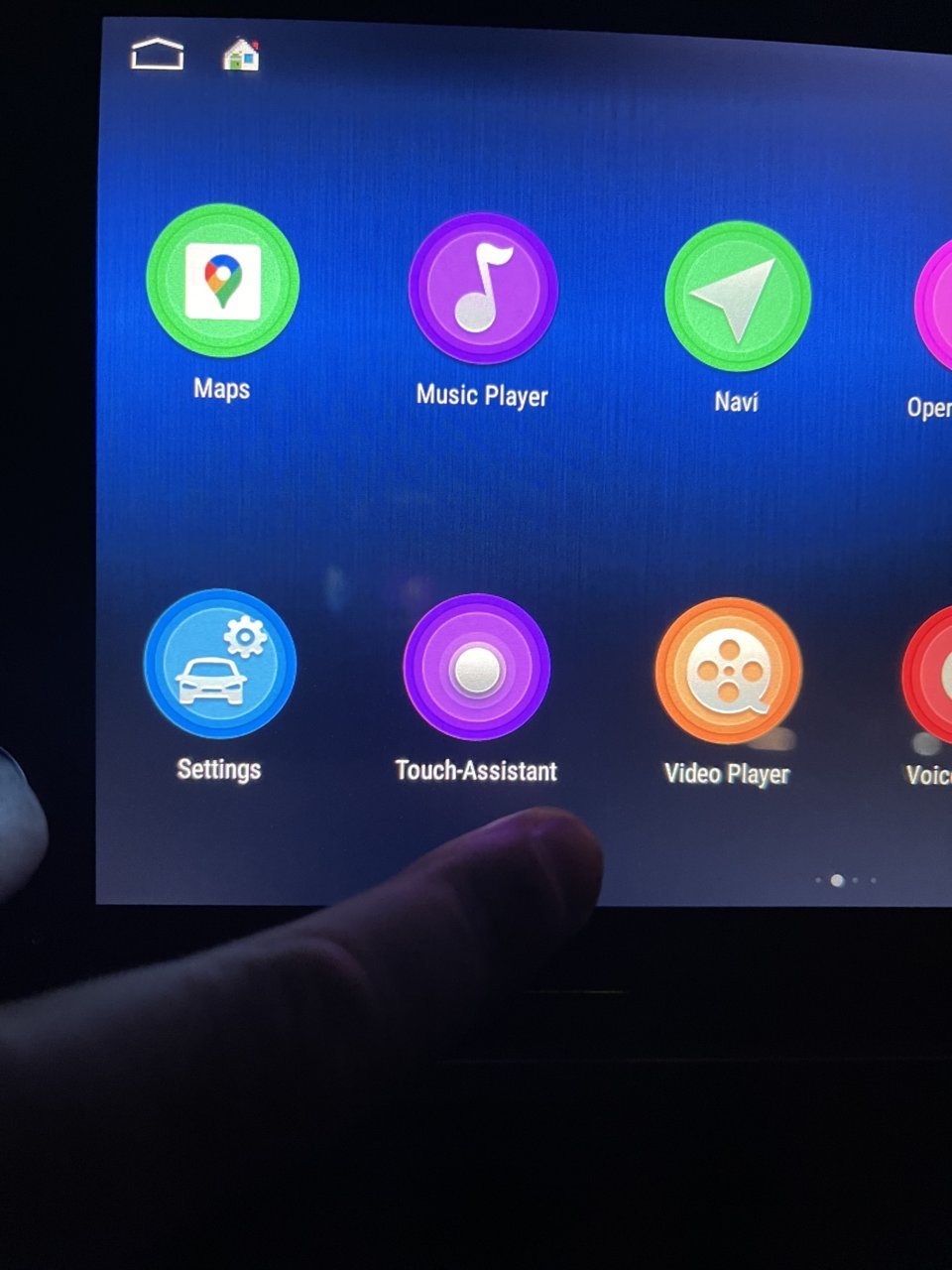

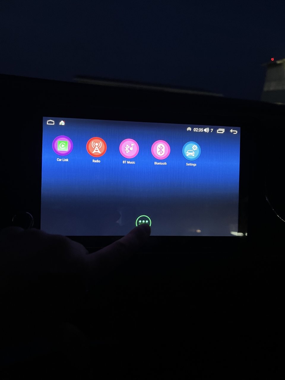

    I stumbled across this looking for something else. Someone else asked how to get rid of the white button on the screen. Here’s the steps:
    Open main menu to select all available options:
    Swipe over to the last page, and push “Touch-Assistant”.
    Now you see a few options, first one is “Display Button”, I unchecked that. Boom it’s gone!
    Enjoy the button free screen!
