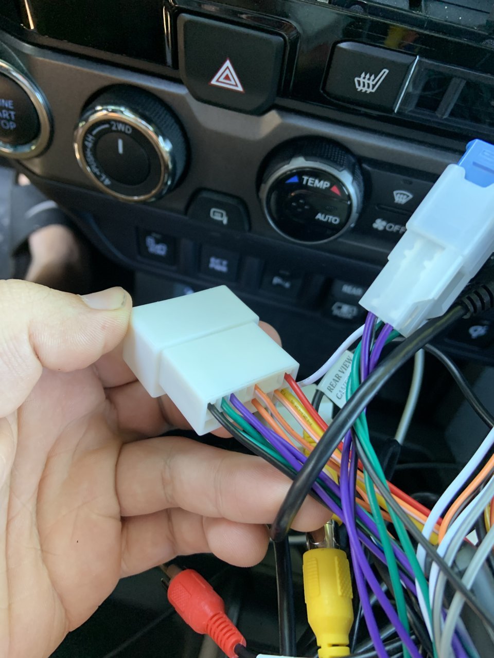

    I ended up installing this head unit today. Everything is functioning with the exception of the rear speakers (when I use the EQ to pan the balance toward the rear all sound disappears). Has anyone encountered this issue or know how to address? I connected the wiring harness to with all corresponding factory plugs. Thanks in advance.

    Sounds like you forgot 1 plug. There is a single plug with green and purple wires on it, this controls the rear speakers.

    In the picture I have the right plug attached with purple and green wires for the rear speakers. There is a second plug, with green and purple wires, that has no way to attach to any of the trucks attachments. I believe these are spliced from the same source. Still no audio in the rear speakers. Where am I going wrong? Everything else is working great with this one exception. Thank you!

    W/ JBL or W/O JBL? That looks like the one I left un plugged but I can go take a look today to validate. I just ask since you seem to have seat heaters and dual climate control which I think means JBL. My write up didn’t cover JBL so it might be different also might take a multimeter to make sure each wire is in its place.

    That’s correct. I have JBL, dual climate control, and heated seats. I ended up with the same plugs unattached as your install photos. All the connections seems to be solid too.

    JBL may be a issue as the jbl system gets its signal a different way than the non-jbl. I think with the JBL system it gets sound signal from 2 channels, but uses a digital signal to split it in the amp. This may be a case where you will need to buy a 5 channel amp to replace the factory amp, just RCA cables back to the new amp, then just cut and splice the wires coming out of the factory amp.

    I really appreciate the responses. I didn't realize the JBL setup would give me such a headache. I spent most of the afternoon combing through various threads and can't seem to find a definitive answer. Is there any alternative way to use this aftermarket head unit with all stock speakers/sub/amp, at least in the interim until I can upgrade these features? Some sort of harness/adapter?

    Yes maybe... but your going to need to go deep into the wire harness and its probably just not worth it if your going to put in aftermarket stuff later.

    You will need a smart harness that can interface with the JBL amp. PAC RP4.2-ty11 or something like that. Check pac-audio.com to make sure that’s correct.
