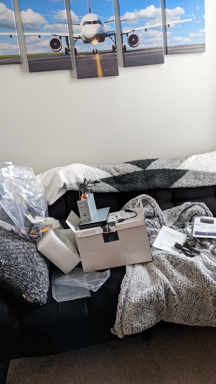

    Just got my Joying today. Let the fun begin. Oh joy, these wires a little overwhelming. Haha.
    Gonna start by ripping out that crappy stock head unit and take pics of the wires.
    Does the external mic need to be connected? I See an embedded mic and also wonder if I can use the existing mic.

    I finished the installation in just a couple of hours. To start, the audio is way better even with the stock speakers! I am also happy to finally have Android Auto! That original head unit is garbage!
    I will note, that the Android Auto application itself does not work on this head unit, instead Android Auto and Car Play will connect through the "Car link 2.0" application as the interface to display Android Auto on the head unit. Wireless Android auto does work! However, sometimes takes a while for it to connect and if you back up while connecting wirelessly it may not connect and you will need to close and re-open the car link app.
    The canbox settings are probably OK since I get my steering wheel functions and the radar sensors display correctly when I backup. I choose RZC>Toyota>Hilux>2015-2018 (I have a 2019 and it works for me)
    I have also seen some folks have issues with the quality of the backup camera, there is a setting in factory settings and change HS reversing video format to AHD, I think it looks better now..
