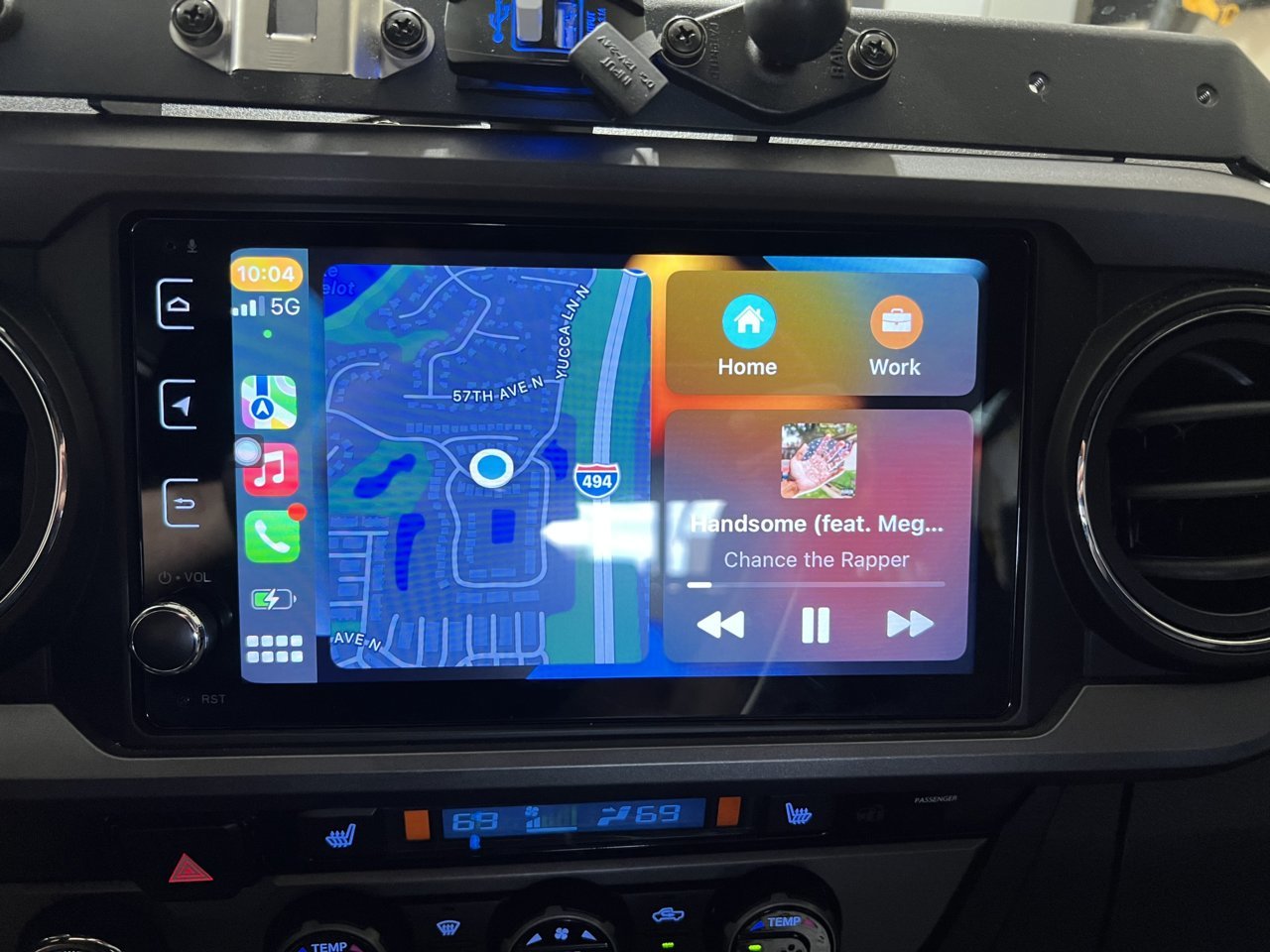

    The update did however give Android Auto the split screen which is nice to see! It gives a "70/30" view . Alsothe Day/night mode is fixed when switching to Parking/headlights. There may be some AA updates/fixes that have been applied also. I

    For a split second, the screen will go either completely blank OR it will go blank but have yellow reverse tracker lines. While blank (or blank with yellow lane lines), audio pauses, then all back to normal. Its almost like it thinks I am shifting into reverse though it will do it while just cruising or even parked, engine off.
    This is non-jbl 6mt with android 10 9" screen. It does it in wireless carplay mode as well as just scrolling through menus which makes me think it isn't a phone issue. Its a real fast glitch but it happens regularly enough that it is concerning.
    Is anybody else experiencing this?
