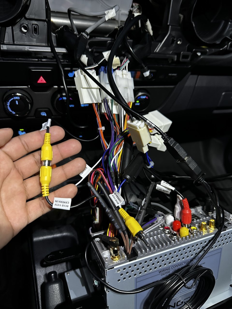

    I have the same one/had the same issue. It's one of the Camera In females. My issue was I had the headunit just connected to itself on not the incoming male plug. Sorry this isn't exact but I'll try and grab a photo in a bit. Whatever it's connected as now just try one of the others. It's there we promise.

    This is what I have now and it’s not working

    Not sure why there’s 3 plugs? Is the extra one supposed to connect into the HU?

    Try other one with ignition one and put in Reverse

    So what I did is hit the restar button on the HU and that did the trick. No sure what it was but it’s working now. :)
    Thanks
