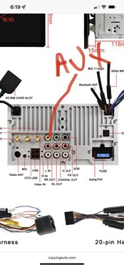

  13. Feb 17, 2023 at 6:26 AM
    #1573
    5nahalf
    5nahalf [OP] I build dumb things
    Sep 22, 2018
    #267058
    11,000
    Erik
    Minnesota
    2018 Inferno Longbed
    We use the scosche kit for the mounting brackets, we throw away the trim part. Its not needed to use the scosche kit, but it makes it a bit more secure. You do need to modify the mounting parts to fit the headunit though.
    I have not tried, but others use their anytime front/rear cameras with this headunit just fine
    No problems using your current amp, you just might need to run RCA cables to it instead of line level (if thats how you have it setup) I am running 9 channels worth of amps with my joying.

    Sub/Amp:
    Since that unit has RCA inputs on it, you can just run RCA cables from the back of the headunit to the sub. Then just run your power and ground for it and hook up the remote turn on lead (blue wire on the back of the headunit)

    Install is relatively easy, and the tips from this group are SUPER helpful. Before removing OEM radio, I connected the wire for radio antenna to back of Joying stereo and connected yellow RCA backup camera cable to yellow IN cable on the stereo after labeling the 2 white connectors that wouldn't be used in the install. (pics starting on page 6 of this thread)
    Rear Cam Hookup: One of yellow RC connectors with Toyota harness. Test it with the ignition on and in R.
    Q:“I am using the stock mount with the (4) 10mm bolts and the (2) 8mm bolts and trimmed tabs on the bezel, but i still cant get the bezel to stay snapped. The top keeps popping out....any ideas on what im doing wrong?”
    A: Did you trim the backside of the bezel? There are little support tabs on the backside that need to be trimmed.There are 2 on the bottom and I think 2 on the top. If you remove the radio and push it into the bezel you should see the parts that need trimming. I can see in your last picture that the radio is not going into the bezel, so thats why it keeps popping out.
